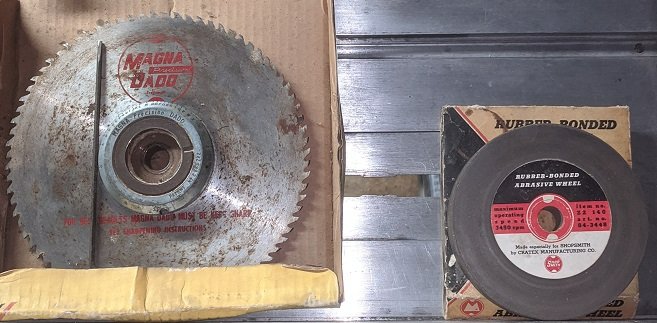

Not a lot to show right now. Recently acquired a Goldie and picked up a Sawsmith RAS last year, but both are awaiting refurb and restoration.

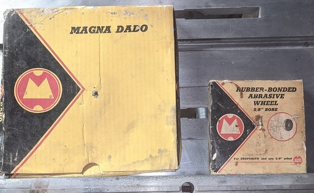

However, with the Goldie came with two interesting Magna accessories, a Magna Dado (12060) and a Rubber Bonded Abrasive Wheel (22140). The dado blade needs cleaning but did come with the square end key that I hear is usually missing. Couldn't find a part number on the abrasive wheel initially, but that part of the box later showed up in a box of parts.
I'm pretty sure that abrasive wheel is not safe to use because of it's age. Unless I can refurb that wobble dado blade I don't think it's safe either, but I can get it cleaned up.

Ed,
You are correct about the Magna Dado commonly missing the square end key. I have had several Magna Dados that have come with Shopsmith's I have restored and all but one has been without a key. Depending on when it was made some have a hex instead of a square key. Something to watch out for is stripping the teeth on the little pinions when using the key to adjust the cut width. The Magna "wobble" Dado was made from the Model 10ER era through the Magna American Corporation era. I am not sure if it continued after Shopsmith Inc. formed to continue making the Mark 5.
I also have the Rubber Bonded Abrasive Wheels, one of which is an older one and a newer one but have been hesitant to use them.

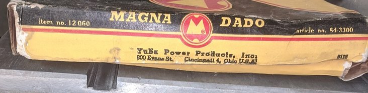

Ed - those are some interesting items. I've never seen the abrasive wheel in its box before, and I've also never seen a Yuba-branded Magna Dado.

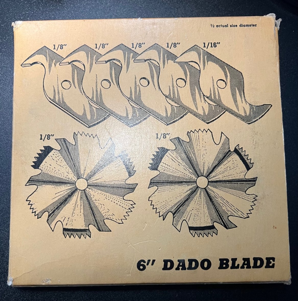

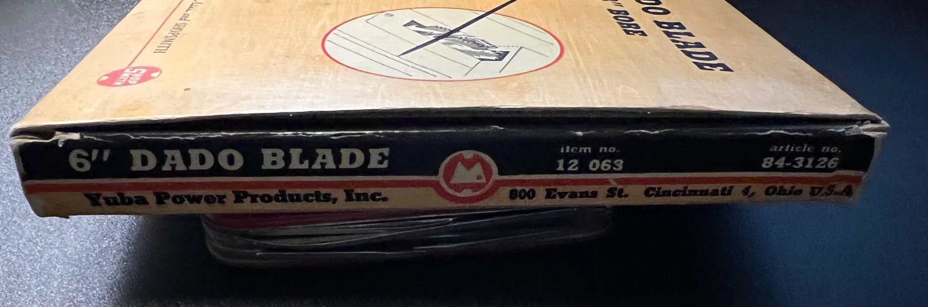

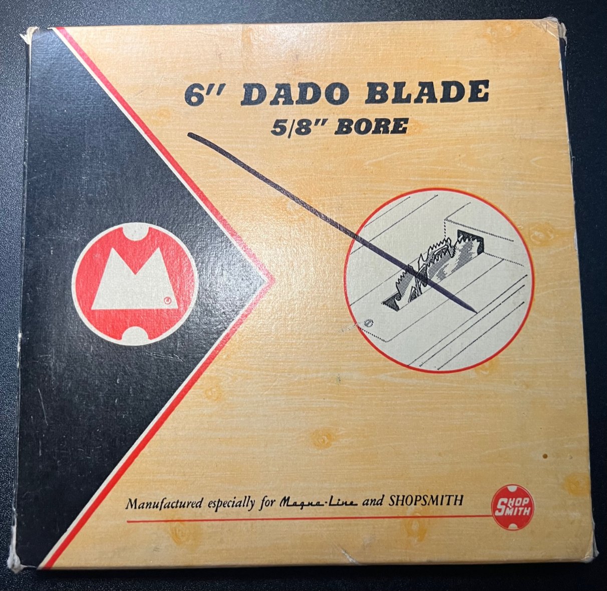

They also offered a stacked dado option during the goldie period. Here's a Yuba version (I have a similar one also in the mustard-colored box from Magna American). Heavy sucker!

The Dado blade and Rubber wheel were nice bonuses with the Goldie. I have a stacked Dado from Shopsmith that came along with my first Shopsmith, but no box. I did use it once long ago but it's just plain steel blades and there are easier ways to cut dados.jpdalton wrote: ↑Wed Mar 02, 2022 8:12 pmEd - those are some interesting items. I've never seen the abrasive wheel in its box before, and I've also never seen a Yuba-branded Magna Dado.
Been looking at some videos on repairing vintage toy boxes and maybe I can restore those battered and beat up Magna boxes.
Ed from Rhode Island
- Posts: 4184
Both the Magna 8" wobble and the 6" stacked dado blades date back to the Model 10 era prior to the part number change of November 1, 1951. The original part number for the 8" Dado is 12 060 and the 6" is 12 063. I have two of the early Magna 8" Wobble Dados P/N 12 060, one in the original gray box and one in the yellowish box. I also have a Magna American 8" Wobble Dado without a box plus a couple others in my "to sell" stuff. Magna also sold both a 6" and an 8" Dado Table Insert for the Model 10's. The stacked Dado set continued for decades and was only more recently changed to Dado sets sold by Shopsmith provided by and labeled for other manufactures. The only 6" stacked Dado set I have that I know is from Shopsmith is from around the 1990's.
