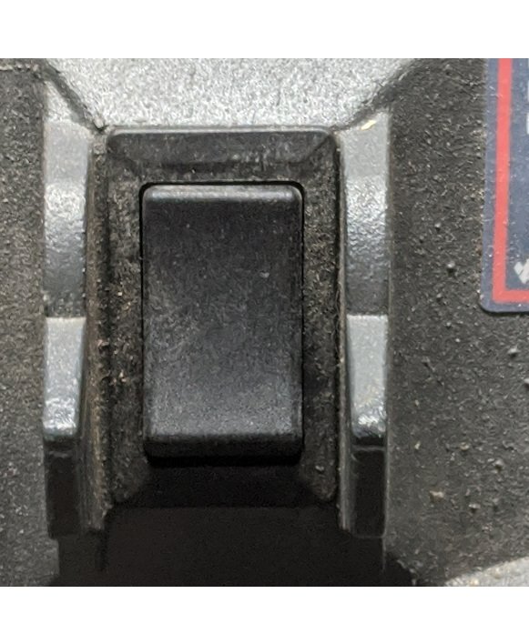

Post by edma194 »
I picked up a carriage with double tilt, lift assist, and a PowerPro headstock, kinda like a Mark 7 except no table system. The headstock doesn't have the red safety switch, just a plain black switch as shown below. The whole machine is pretty clean. The guy I got it from gets tools from estate auctions, he has no idea of it's history. Anyone ever seen a black switch like that in a headstock, PowerPro or conventional?

Don't think it SS. A PO probably just replaced a bad switch with one like that off the shelf.

I agree with John. I have one like that except the rocker is red. I bought it from eBay, there were numerous options including black. Jacob A also advocated non-SS switches of similar design. Kind of surprising it has been replaced though, the PowerPro is pretty gentle on switches, and can't be much more than 10 or 12 years old. For sure, I would be cautious about using it on 230V without verifying it is still wired correctly.

I figured it to be replacing a bad switch, but it appears to have little usage. Perhaps it was changed just prior to sale. I have to be suspicious of this machine, don't know how it started in life. If the switch failed early on I would expect a ShopSmith replacement, so I have to worry about what caused a problem later. I think this was a good deal, for $500 it's a like new base with double tilt and lift assist, plus the PowerPro head which seems to work fine so far, so even if the PowerPro fails it wasn't an awful deal.

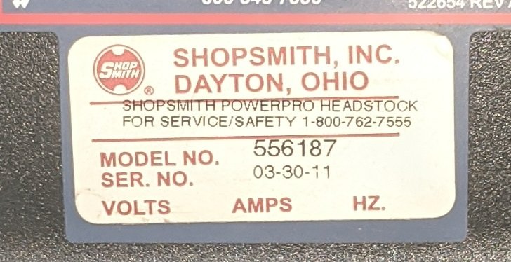

It does sound like a pretty good deal. Just curious as to what the serial number/date code is which could tell more about the Headstock's history.

chapmanruss wrote: Mon Mar 07, 2022 12:50 pm Ed,
It only has a date code, maybe there were known issues from that time period or something like that but with just a date code I assume Shopsmith can't tell me anything about it specifically. You might be the best source of information for this.
ETA: I just realized the model number, 556187, tells me how the machine was initially sold, as a Mark 7 with PowerPro. Don't know when the Lift Assist was added, possibly as an original option. I don't know if it has a quick disconnect on the piston yet, haven't looked that close. It came disconnected and I took off the upper part on the way tubes to put a table carriage on.
