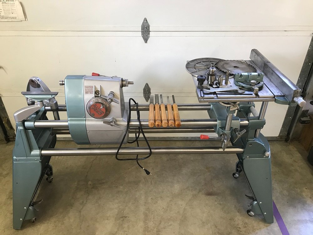

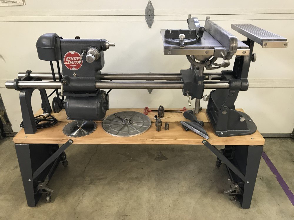

Welcome to the Shopsmith Forum. First, I have to ask what Model of Shopsmith you have. You describe it as
from about 1955 and was "built under license in Australia" the serial number is 916
This description leads me to believe it is a Shopsmith Model 10E as it was called in Australia. It actually compares to a Model 10ER and would look the one pictured below except it should have an additional nameplate on the lower right corner of the Headstock.

If it is a Mark 5 it would look like the one below.
_
As you can see they are very different Shopsmith tools. If you have a Model 10E than it should have the single wedge locks but the handle for the Quill lock is different than the Headstock lock for the way tubes. The carriage lock should be the same as the Headstock lock. Replacement parts for the Model 10's must be found on the used market such as auctions on ebay.
David's description and information is for a Mark 5.

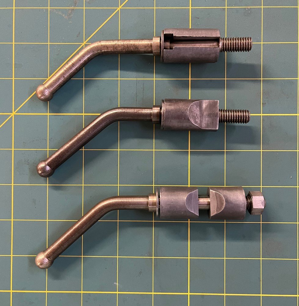

The picture below shows the single and double wedge Locks used for the Headstock and Carriage.
_
Single and Double wedge locks.jpg (181.87 KiB) Viewed 2830 times
The top two lock assemblies are single wedge locks and show both sides of the wedge. The top is a Quill Lock and the middle is a Headstock or Carriage Lock. Note the difference in the lever (handle). The lower is a double wedge lock for reference. Your Australian made Model 10E should have the single wedge locks but I cannot be sure since it was one made in Australia and may have earlier part versions. I haven't seen any detailed pictures of one to know if they have earlier part versions. Look inside the lock bore to see if it has a threaded back (for single) or if the bore is all the way through (for double). The Headstock and Carriage Locks are normally the same either double (earlier production) or single (later production) wedges for the locks. The Quill Lock differs in the Lever (handle) shape and some mid-production Quill Locks were keyed.
Right now the only locks for sale on ebay are a double wedge Quill Lock and a double wedge Headstock/Carriage Lock. There are two Carriage assemblies for sale and one is a single wedge lock and the other is a double wedge lock. You could buy the single wedge lock Carriage for sale if that is the lock type you need.
