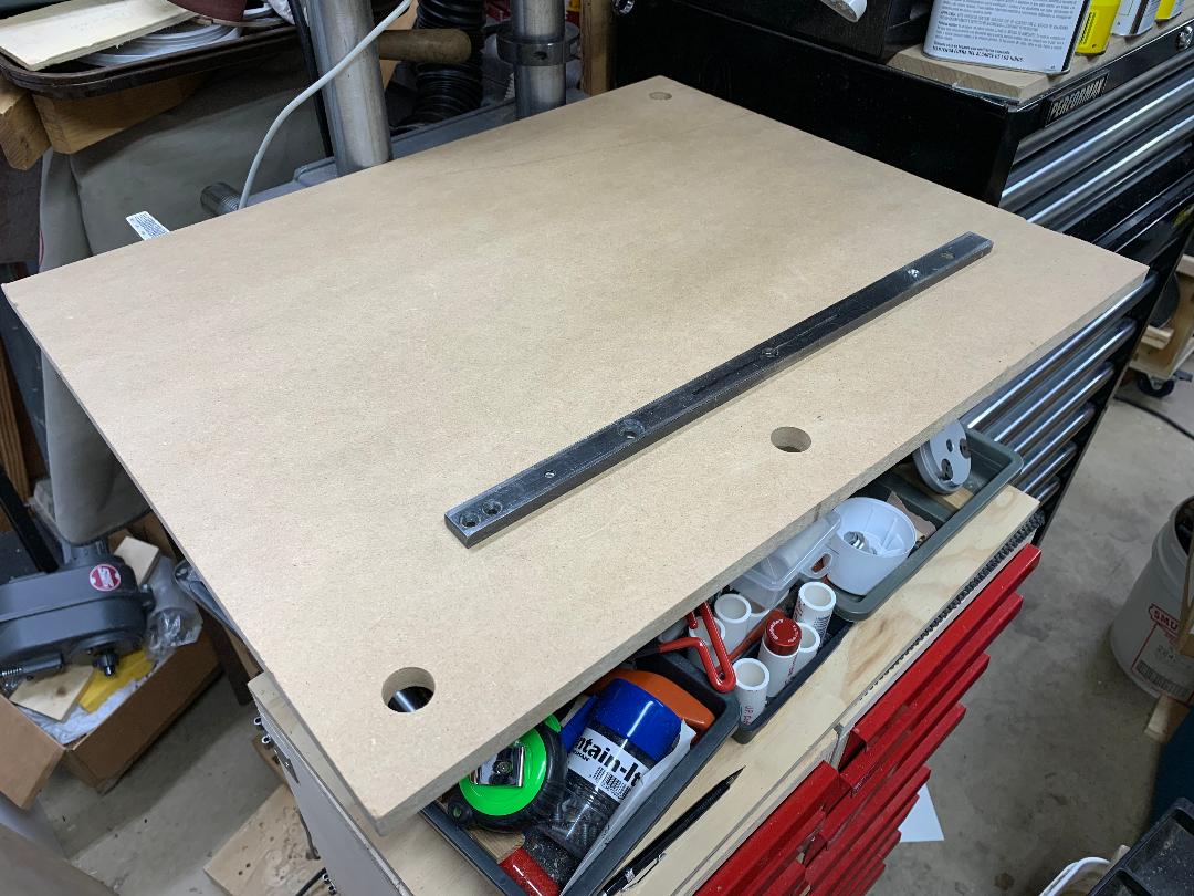

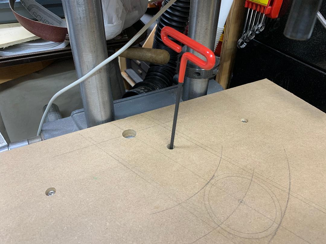

The table is made from MDF which I will treat with oil if the design looks like it works like I want or if I decide I need to make some changes I might use baltic birch plywood next time.
Here is a shot of the bottom. The bar is from a 500 miter gauge.

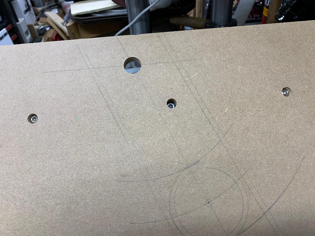

From the top side you can see the two mounting holes and and "extra" one, mmmm what could that be for??
It is important that the alignment is the same each and every time. So with the miter bar in the miter slot you slide it until the dog locates against there front of the table.
Did you guess what that third hole was for? If you guessed that it was for locking the miter bar in place which in turn locks the table in place you would be right.

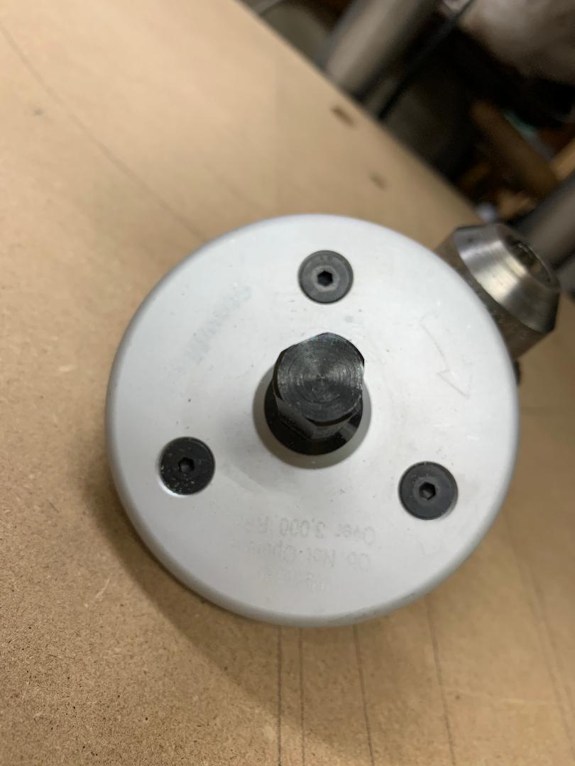

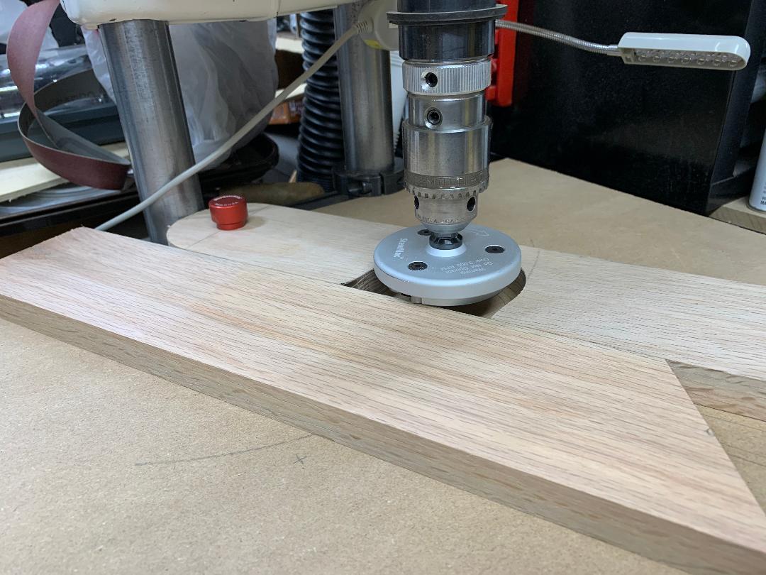

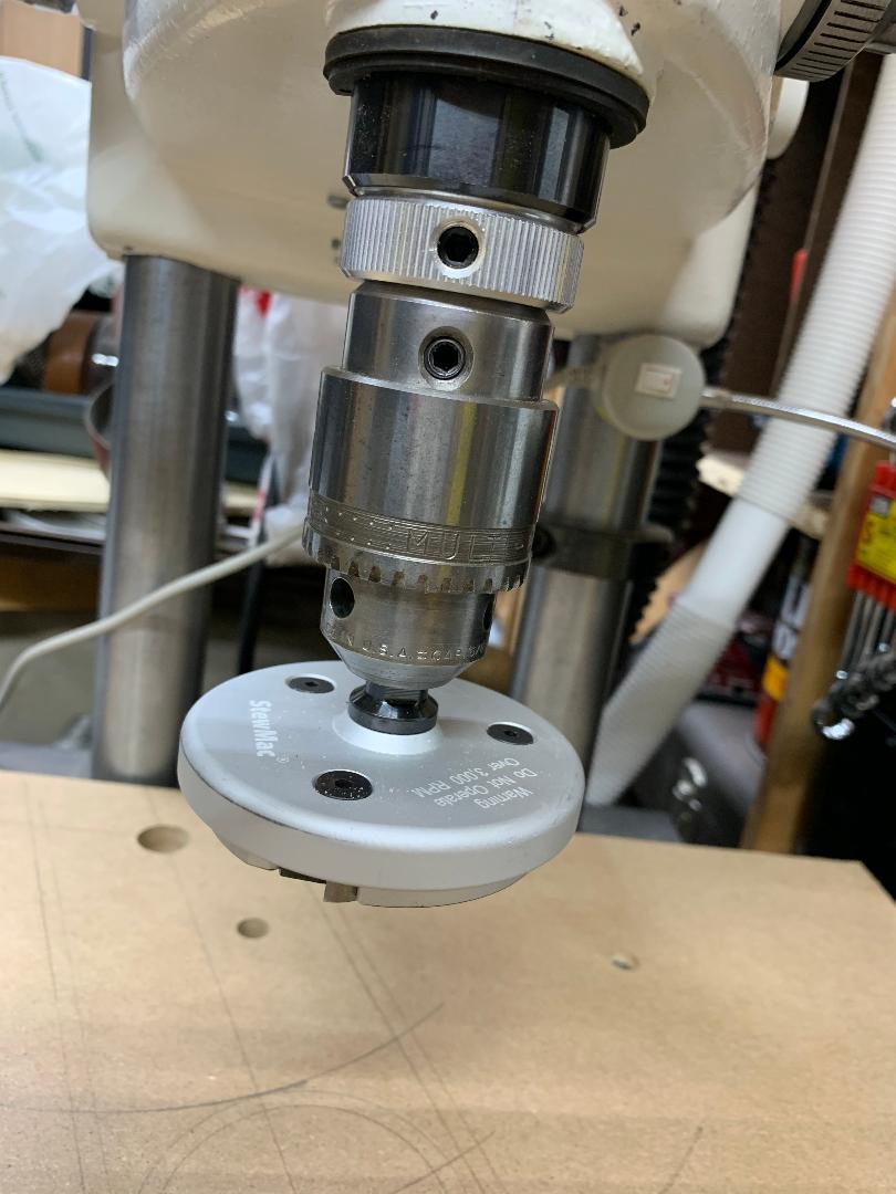

Now it is time to mount the safe-t-planer. the shaft is designed to work in a stock drill chuck with three flats as you can see here:
The old model I have is just a round shaft and I seem to recall using the 1/2" router chuck to mount it. Anyway I went with the drill chuck now.

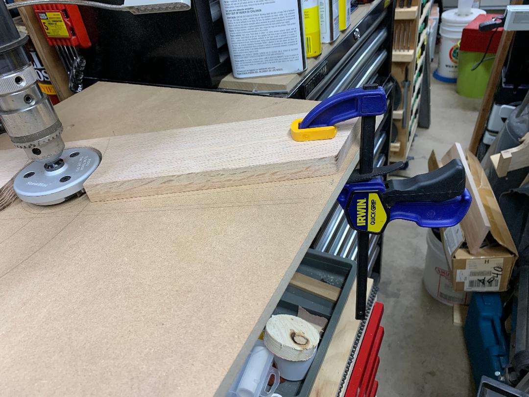

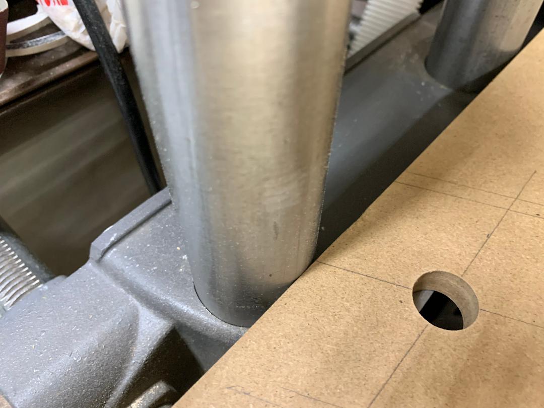

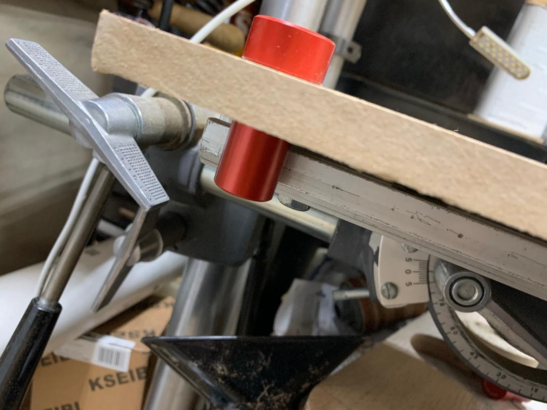

The side to side direction has been located but now it time to locate and lock the front to back. This is done by having the table against the way tubes as seen here:
With this location locked in place we can take a short intermission before I posts the second part of this thread.

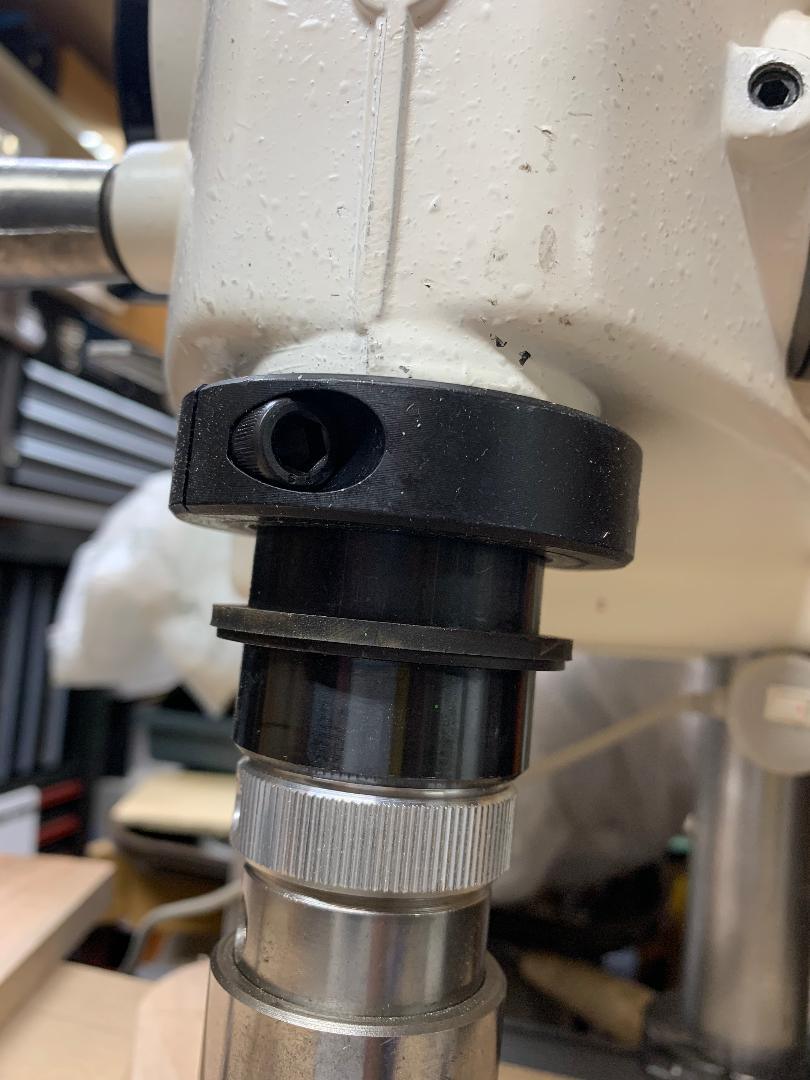

This next "trick" I have been playing with and can not say for 100% it is a perfect solution but I don't have a better one right now.
Any one with one of these machines knows that table locks pretty well, but you end up putting too much pressure and well it can move. Many years ago I spotted this with using the mortising set-up. I ended up making a notched 2x4 that would set under the front edge of the table and that seem to fix that. Later on shopsmith came up with leg so I'm pretty sure they knew about the issue.
Well for this application I don't see there being much force but I also sure don't want the table tilting for any reason.

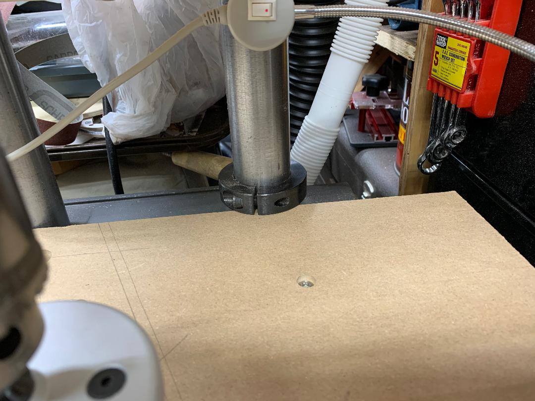

My solution is to use a stop collar on the way tubes that traps the table and should hold it pretty well. So far so good.

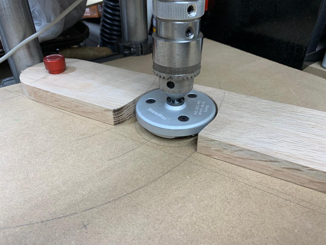

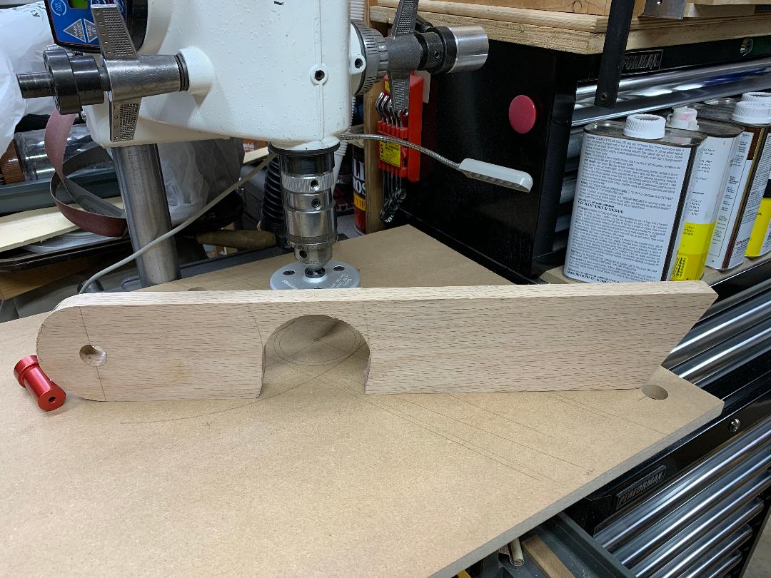

Now we are up to the fence. One side is located and the other moves to provide how much of the safe-t-planer is exposed. Here it is before being mounted:
The holes are 20 mm so any 20 mm dog works to locate the "pinned" side of the fence. I did the design on the fly so you will see construction lines in a lot of places.
The area where the safe-t-planer sets was cut with a 3-1/4" hole saw and the curved exits were done with a drum sander. The sanding sleeve was pretty used up so I was getting some burning, might clean that up at some point with a nice new fresh sanding sleeve.

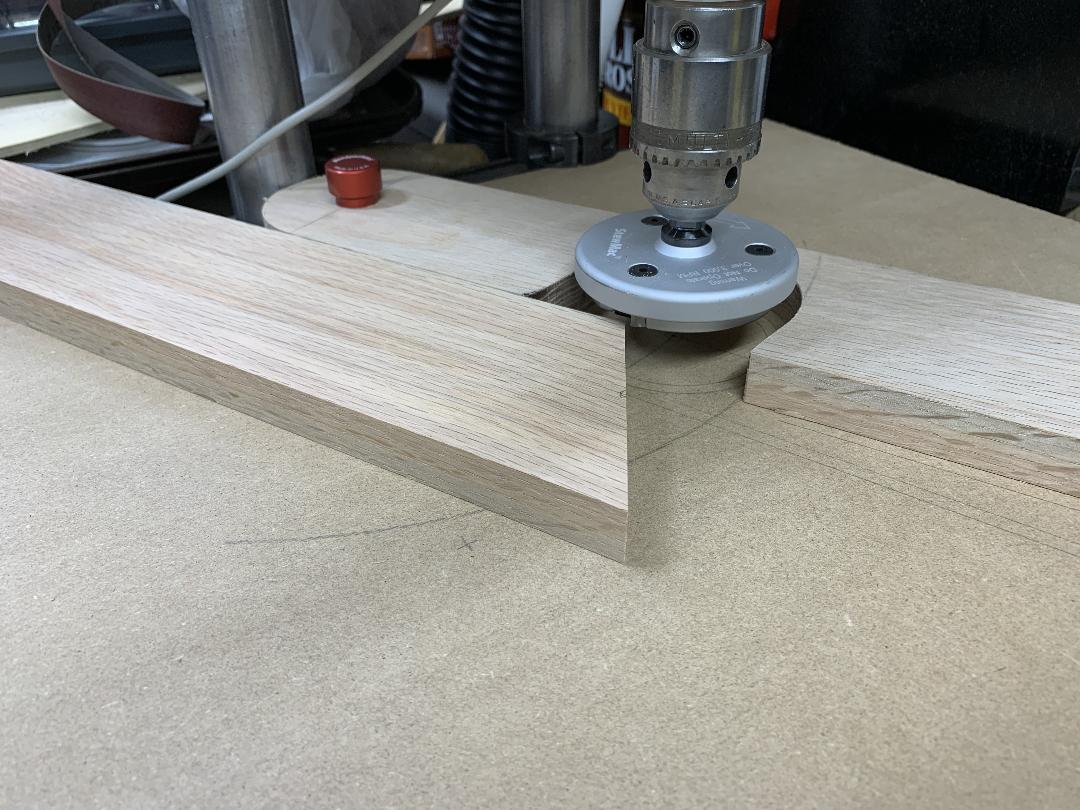

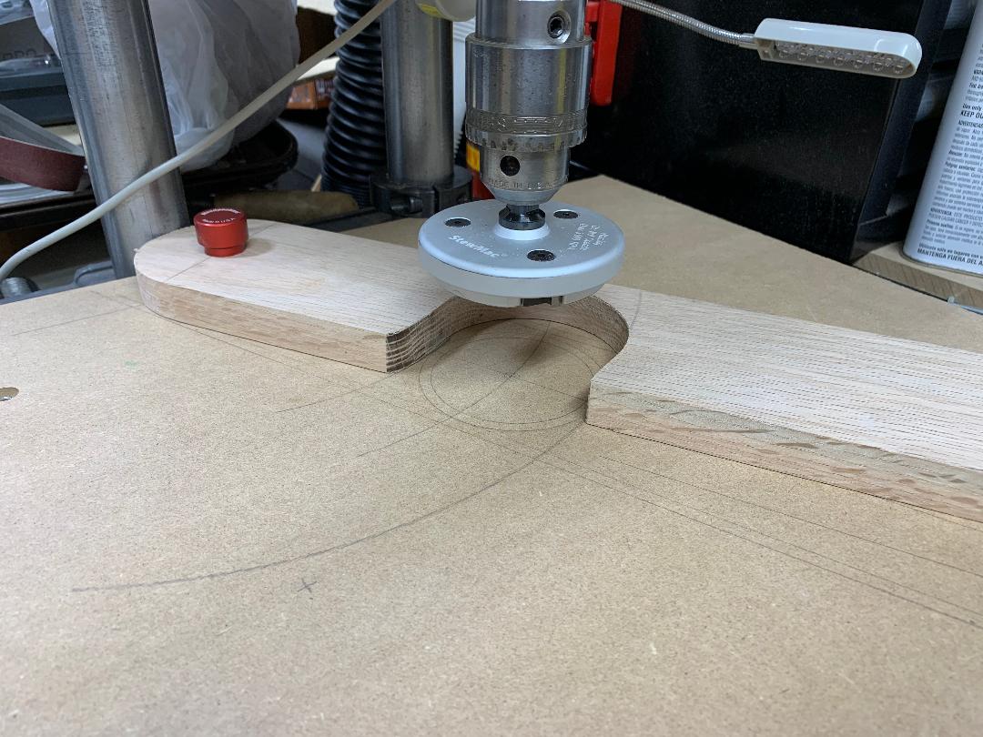

At the location you see above the cutters are behind the fence front so no cutting would happen. You can adjust the fence to cut the whole cutter width as you can see here:
You can of course do even wider stock with several passes and turning stock end for end.
When you get it set up the way you want you still have to clamp the other end of the fence in place, something like this:

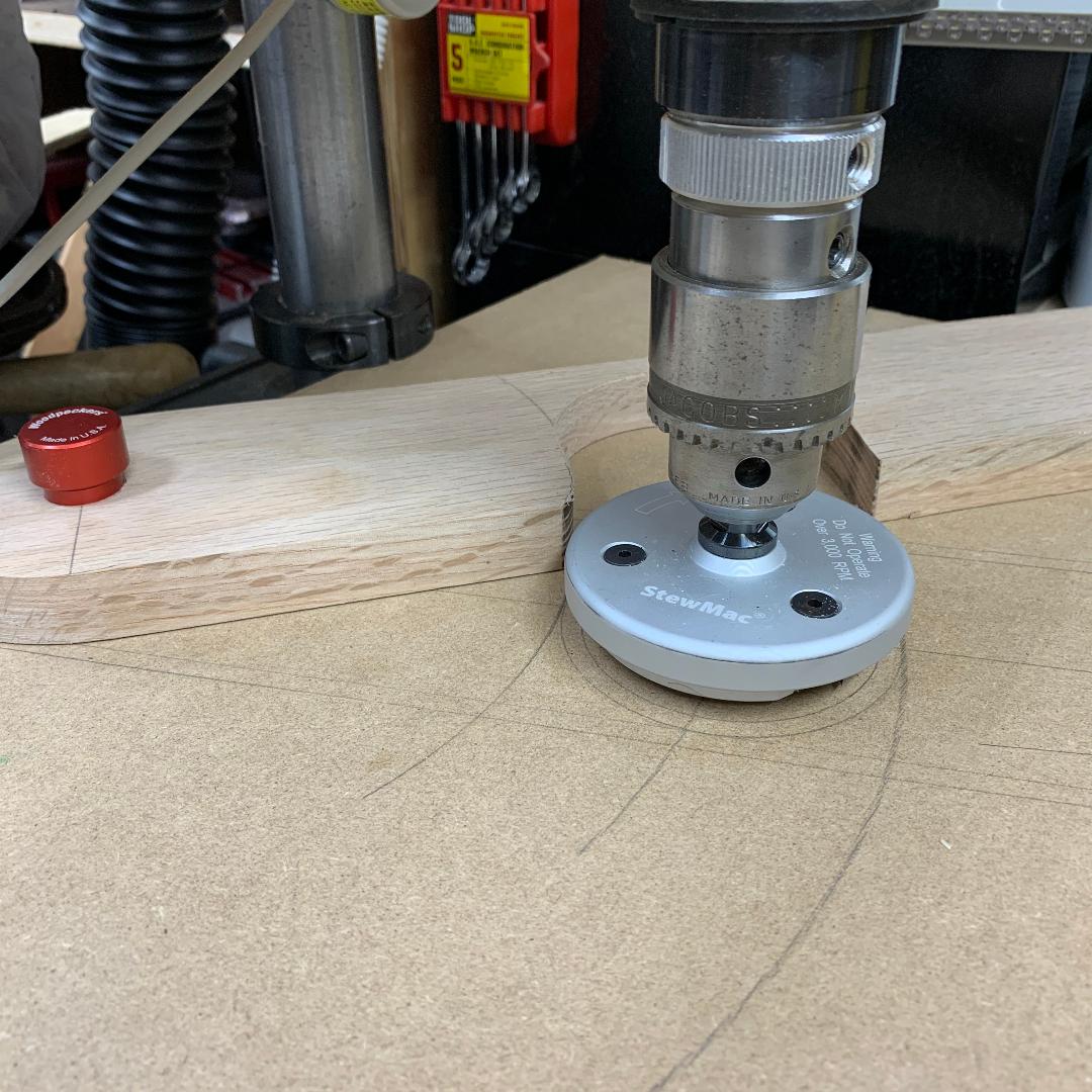

Just to give you an idea of how this would work take a look here:
I will be doing some test cuts maybe tomorrow, or at least soon.

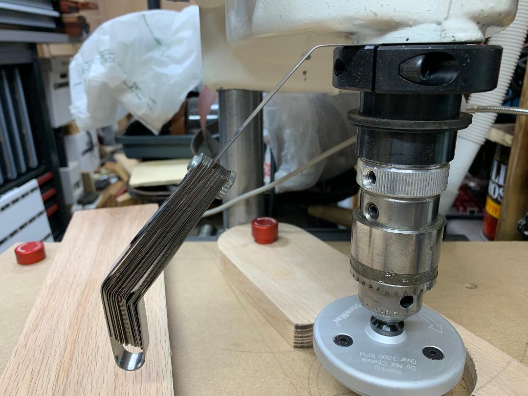

Here is another thing I've been playing with and am pretty happy with. I've complained about shopsmith lack of support for doing real routing. No way to use guide bushings, not an easy way to lock the quill when plunge routing, and well we need not go any farther on that subject.
One thing that I think can be solved is how to get precision depth cuts. There is no micro-adjust on the quill but.........
Way back when before shopsmith started making the adjustable stop collar.
https://www.shopsmith.com/ownersite/cat ... collar.htm

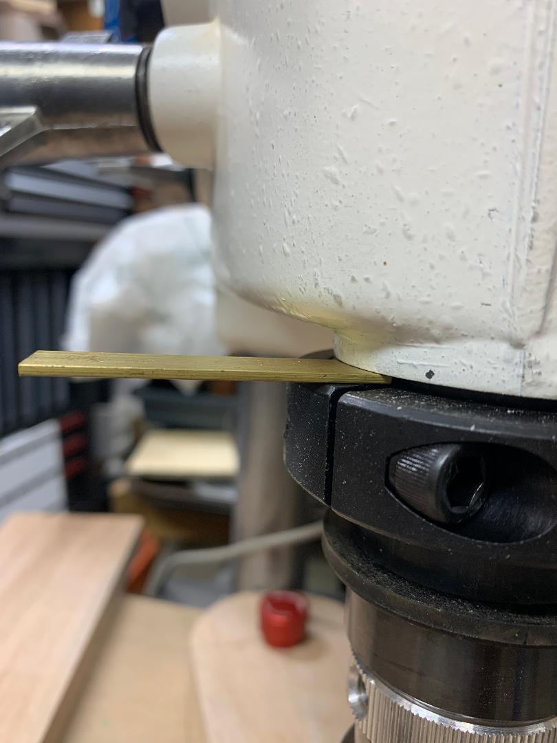

I would attach a stop collar then use feeler gauges or drill bits or set up blocks to fine tune the depth of cut.
You can do the same thing with the quill (note the one shopsmith sells is the wrong size so don't buy one for this feature). In this case I have the safe-t-planer but you could have a router chuck and bit and do the same thing.
I lower the quill to the zero surface, normally the top of the work piece then lock the quill at that location. Add a stop collar and bring it up to the head stock.
Now unlock the quill and anything you place between the stop collar and the head stock is lower the bit or cutter that much. Here I have a 1/16" brass bar, you then lock the quill at the new location. You can then use the tool that way or if you want to plunge to that depth you move the stop collar up to the head stock and tighten. Either way works.
These set up blocks come in sets and give you the ability to stack in 1/32" increments. (They have a metric set as well but I don't have mine yet, they were back ordered.) If that is not close enough you can then either use a feeler gauge set with them or by itself to get into the .001" range. There is some error that creep in so think more like within a couple of thousand.

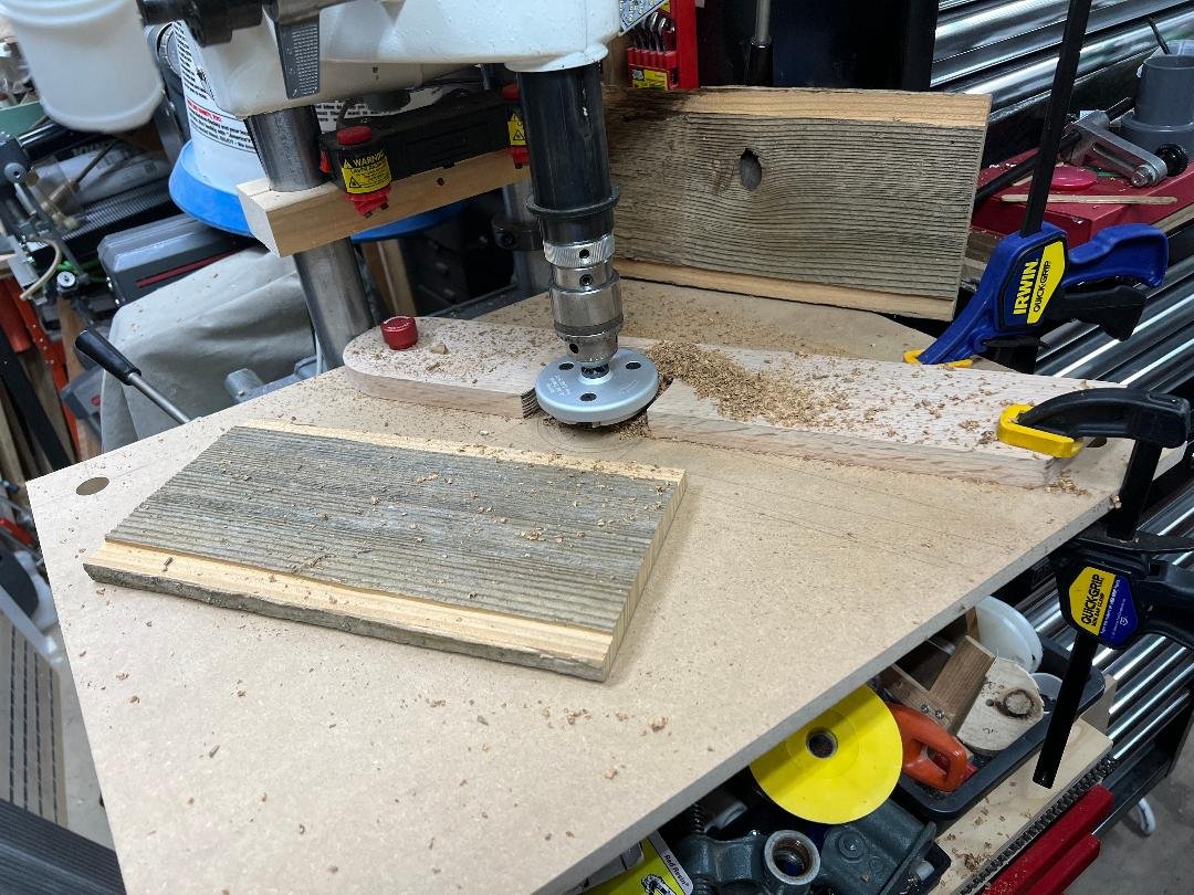

I was actually using this set up today and remembered to take at least a couple of pictures to share.
I used the one shopsmith and I think it was sears use to sell and never got around to making a top and fence. When the cutters got to worn and not worth sharpening again and I wasn't finding new replacement parts I just put it away and life went on. That was some years ago. It is nice to have that function available again and to have a set up like I made.

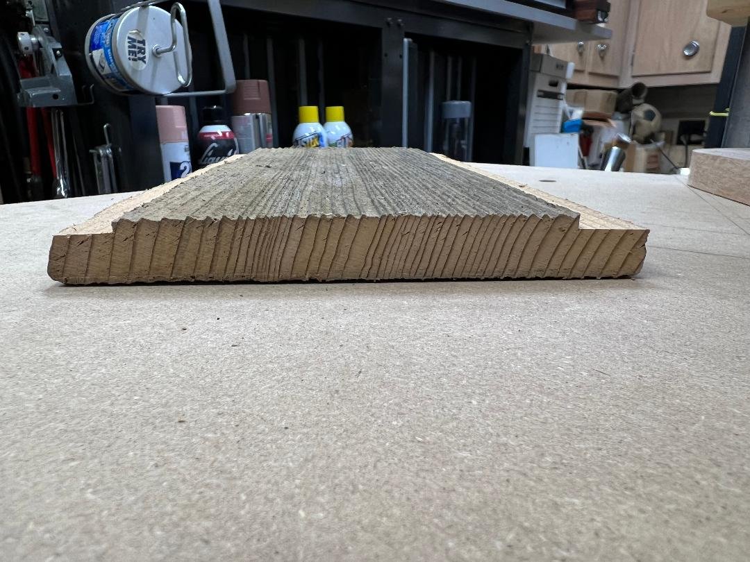

Here I was cutting some rabbets in some old cedar boards. I made the cut as shown and it worked as expected. I will have to come up with a way to deal with the chips. As is one pass makes a major mess and requires a clean up before the next pass. Anyway one step at a time.
