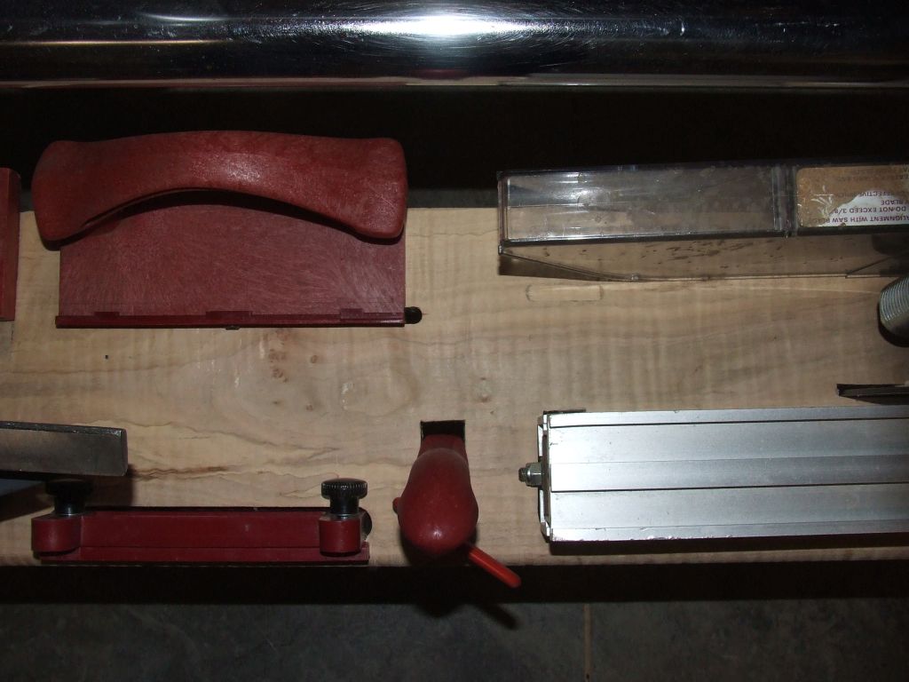

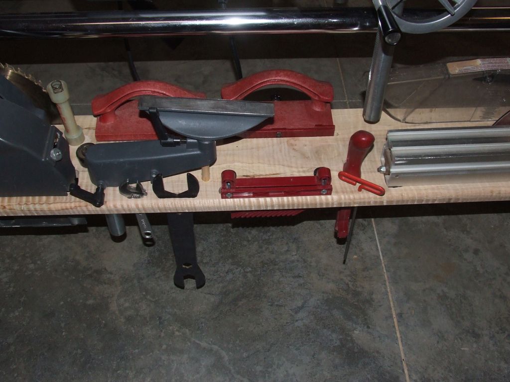

I have gone the Under Shopsmith cabinet route a couple times. The first one (plywood) came with a Shopsmith and I used it for several years but had to go to another Shopsmith to do horizontal boring. The second one was oak and I just used the cabinet case and cut it down to just fit between the table posts and put all new drawers in it. Only problem was the drawers were not deep enough for the 12 inch sanding disk.
I decided to go back to a shop made accessory shelf.
I left room for the table legs to go all the way down for the full amount of usable horizontal travel.
While I was making changes I added threaded rod and knobs to the bandsaws.

Thanks for the positive comments. I believe it is curly maple sometimes called tiger maple. It happened to be one of the first trees I cut on this property because I needed fire wood. Much of the tree top was dead. When I found out what it was I saved most of trunk.

Moved the miter gauge further to the left. Added distances for starting points for hole locations and centers of circular holes. Moved live center, drive spur and removed small lathe tool support from the drawing. Also added a 1x4 to the bottom of the shelf to prevent sag.

I cut out the saw guard hole on a new shelf today and found the guard was a little tight in the hole. I adjusted the dimensions in the file by 1/16" on both sides at the top in the Sketchup drawing.
