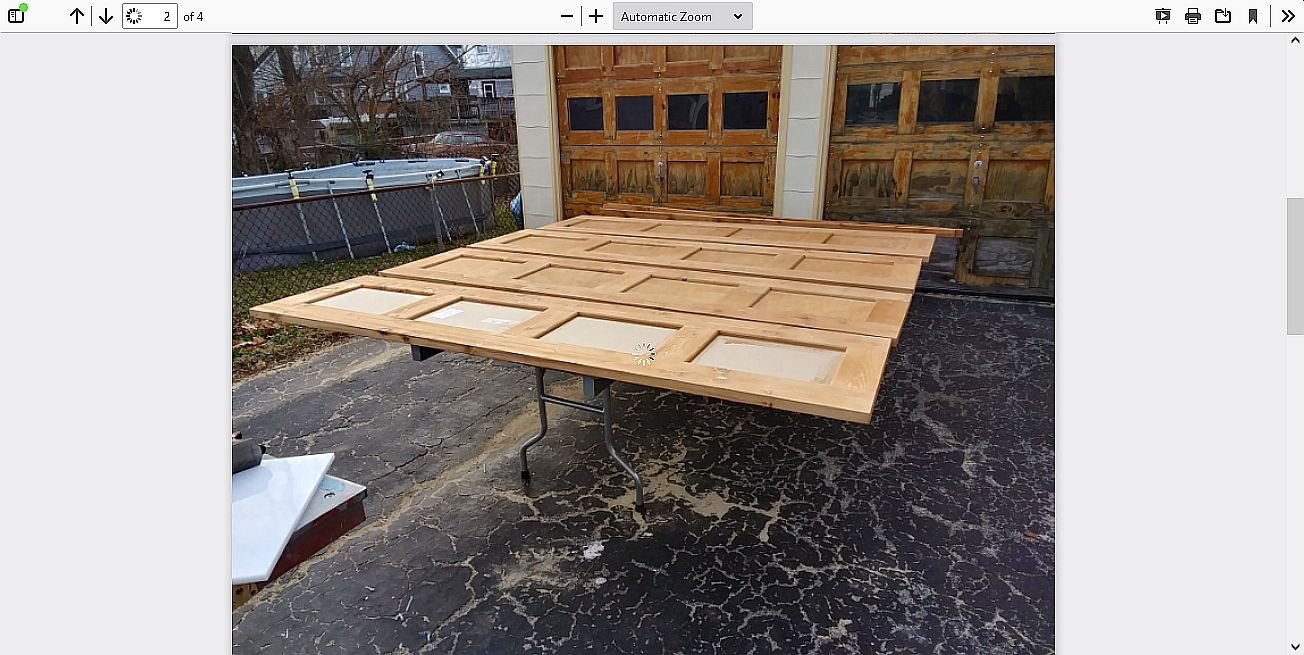

- B4.jpg (166.42 KiB) Viewed 1264 times

Steve, those are some mighty fine-looking doors … a most ambitious woodworking project!

The Wood Whisperer gives his take on outdoor finishes. https://www.youtube.com/watch?v=kD9WstyGg-s The short answer is that he doesn't recommend film finishes.
I've been dreaming about building old-school swinging garage doors, perhaps from straight-grained, clear fir. I'm afraid to price out that much wood, though, only to end up planing it down like you had to.
Nice job with your doors. The journey is more important than the destination. At least that's what I keep telling myself.
