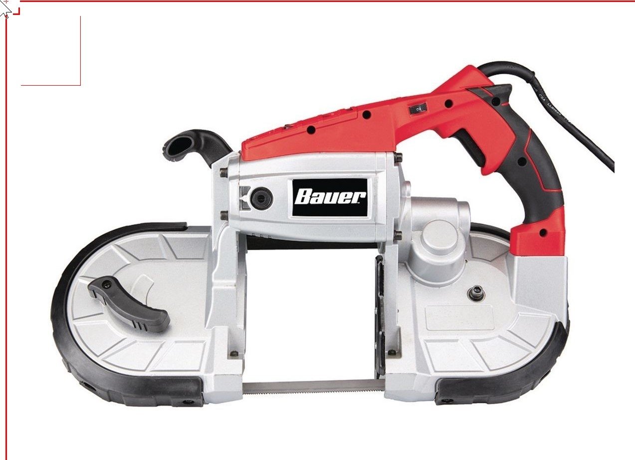

Re: Shopsmith bandsaw for metal cutting
I was going to take a picture of my bandsaw but I guess it must be in the storage unit..... or did I loan it to one of my kids?? Anyway I know some people don't like to click links so I thought it might be best to post a picture. I think I got mine back in 2016 about Easter time?? It is not the one pictured but an earlier model and it works great for a lot of projects. Those tubes you want to cut would be right up its alley.
