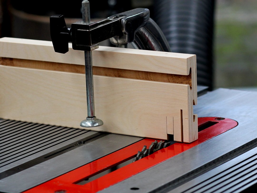

I have an entire box of them for my 510. Some of them are so weird that you probably wouldn't know what they are for if I didn't show you. My most used ones are probably the ones for cutting box joints.

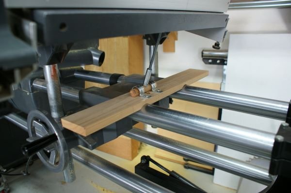

I like my Tweaker, when I cut segments for turning or any other projects that require tight angle tolerances. By adjusting the connector nut while the table trunnion lock is loose the exact angle down to one tenth of a degree can be set. First set the table 90 degrees to the saw blade then put the Wixie on the sawblade set the angle to 0 deg. Move the wixie to the table and adjust the table to the required angle using by turning the barrel nut while the Wixie cube is on the table. The most important setting is the angle of the table to the saw blade. I have used this fixture for cutting a lot of segments for making segmented bowls and it really works. While setting the angle the table trunnion lock has to remain loos so the table can float and the barrel nut can move table.

edma194
Posts: 2205
Re: Favorite/essential jigs?
Post by edma194 »
wa2crk wrote: Tue Apr 12, 2022 7:55 pm I like my Tweaker, when I cut segments for turning or any other projects that require tight angle tolerances. By adjusting the connector nut while the table trunnion lock is loose the exact angle down to one tenth of a degree can be set. First set the table 90 degrees to the saw blade then put the Wixie on the sawblade set the angle to 0 deg. Move the wixie to the table and adjust the table to the required angle using by turning the barrel nut while the Wixie cube is on the table. The most important setting is the angle of the table to the saw blade. I have used this fixture for cutting a lot of segments for making segmented bowls and it really works. While setting the angle the table trunnion lock has to remain loos so the table can float and the barrel nut can move table.
Excellent idea. I think I want to make one of these.
Ed from Rhode Island
Posts: 3813
That "Tweaker" is really slick! Kind of like the SS adjustable stop collar, except for table tilt instead of height.
I like this. So you cut your miters for segmented turning using table angle rather than miter gauge angle? Keeping the miter gauge at zero degrees? Is there anything (other than gravity) holding the board down on the way tubes? I've done something similar using two main tables and carriages, but the angle range was very limited due to the length of the tables.
