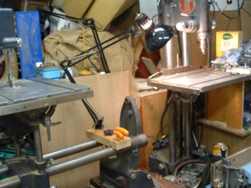

Posts: 4545
Re: Lift assist on 10 E R
Ron,
Nice lamp holder.
