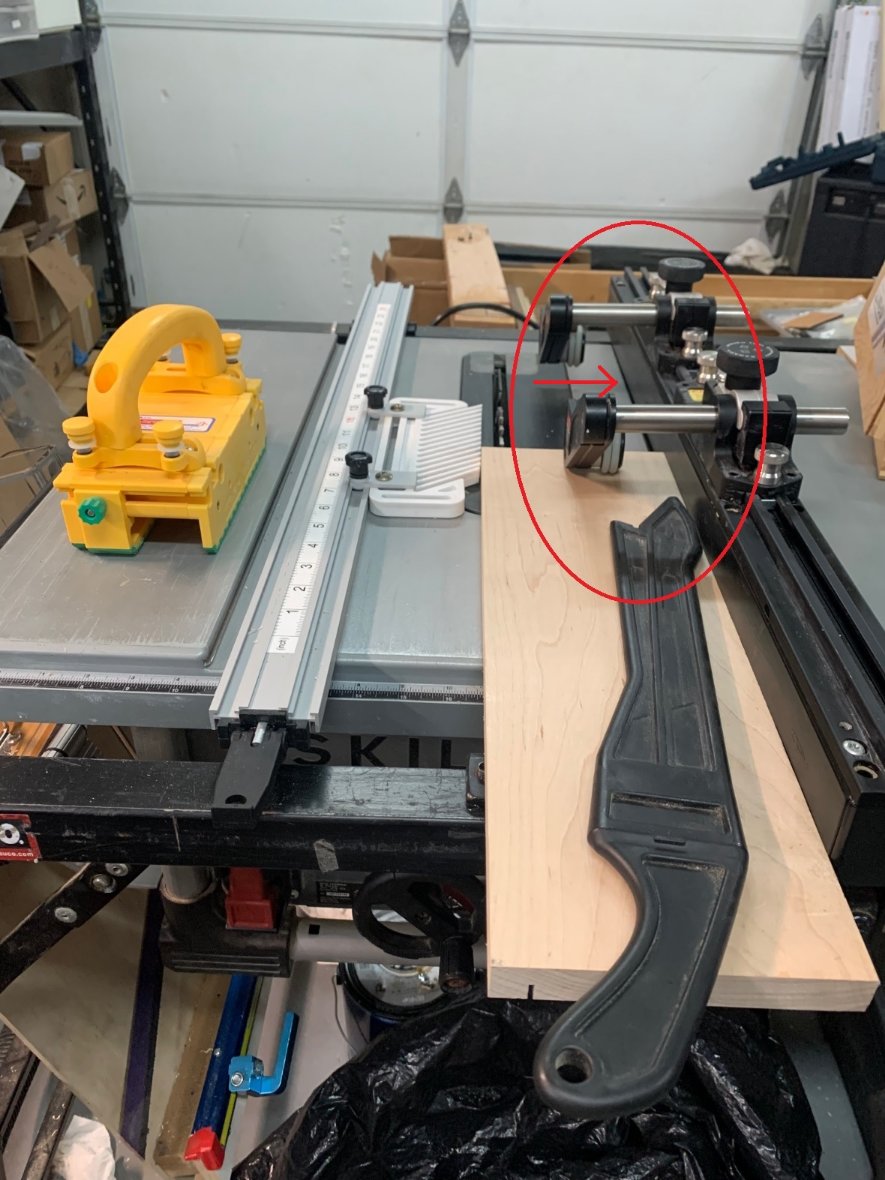

algale wrote: Fri Apr 29, 2022 7:00 am
chapmanruss wrote: Thu Apr 28, 2022 1:54 pm Do move the feather board ahead of the blade. Never have it "pinching" against or behind the blade.
^^^This is worth emphasizing!!!!!!
As pictured in the OP's current set up, the feather board will push the work piece toward the blade and, as the cut is completed, this set up could could cause a kickback (although the riving knife might prevent contact at the rear of the blade). At a minimum, the front of the bade may continue to chew up the trailing edge of the work piece. Move the feather board toward the operator until none of the feathers/fingers overlap with the blade.
Alan,
Thanks. I agree. I probably should have emphasized this one more in my previous post. Of course, we don't know if the OP had this featherboard in place on the kickback that injured him or not though. I believe he is posting all of the safety methods he has in place now. Still, this featherboard is too far forward and shouldn't be located where the workpiece (wood) first comes in contact with the sawblade. I still think the fence needs alignment. Pictures are never perfect and there is parallax to contend with, but looking closer at this pic below from the OP it appears to me that the fence might be misadjusted. If you look in the red oval, it appears that the fence is closer to the sawblade at the back which is a prerequisite for having a kickback for sure. Reason that I say this is because the gap between the fence and the table's right miter bar slot has a larger gap near the front compared to the back, or at least it appears this way in the pic.
I highly recommend the OP check and perform a fence alignment first.
See pages 29-30 of the manual at the link below, if I have the correct Skil model #
https://www.skil.com/media/productattac ... manual.pdf

Off topic but still a safety issue, I knew a guy that was having a issue with his saw, said it wasn't working right and wouldn't cut, said he was on his second blade and it was burning the wood, went over to see what was going on and found he had set his fence on a angle trying to make a tapered cut .said he seen a taper jig and it was the same thing ,,,,,,, it isn't !! after making him a sled that would cut tapers he understood . I had not noticed the fence in the post above being off and I believe that could be correct if this was the set up , the topic said it was non through cut ,,the fence being off is still a major issue even making dado's , a non through cut ,, I am still confused at the question in the topic how one could use a riving knife and anti kick back fingers on the riving knife in a dado cut ,, the riving knives on the saws I am familiar with stick up above the blade for the shield and are not used in making dado's or rabbits . in the past I have used feather boards, anti kick back fingers next to the fence on the outfeed and infeed at the same time but only when they provide downward pressure not horizontal pressure and never beside of the blade JMO.
