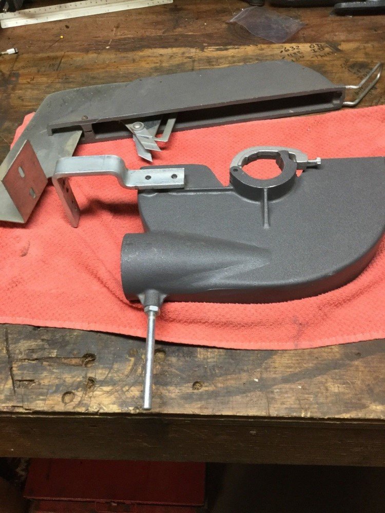

This is my upper guard. The aluminum plate is the riving knife correct? So do I line up the splitter with the blade and just keep the clear guard up and out of the way? Or just remove the swing assembly leaving the riving knife and anti kick backs in place?
Thank you very much. No luck with a photo

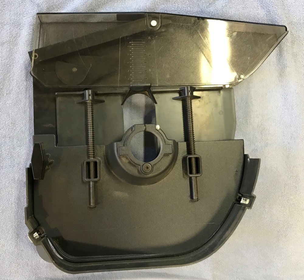

I am not sure which Mark V 500 Guard system you have. The most recent Upper Guard (top picture below) attaches to the table post and the older Upper Guard (bottom picture below) attaches to the Lower Guard. In both cases there is a lot of flat metal for the splitter that allows some flexing. As long as the splitter is aligned with the blade you will be fine when using it.
The picture of the more recent Guard system below is the 1-1/4" port not the 2-1/2" ports. Sorry I didn't have a picture of the revised version of this Guard System.
More recent Mark V 500 Guard 1-1/4" port
505875 - 500 Saw Blade Guard Assembly 1980s r.jpg (207.59 KiB) Viewed 12329 times
Earlier Mark V 500 Guard
505627 Upper and 505628 Lower Saw Blade Guards r.jpg (175.28 KiB) Viewed 12329 times

We need pix to ascertain which version you have.
Posts: 4541
Re: Upper Safety Guard / Saw
jmenge,
Welcome to the Shopsmith Forum. Since the Saw Guards for the Mark 5/V 500 mount differently, knowing the version you have is needed to help guide you. Besides the two types of guards for the Mark 5/V with the original table system aka 500 shown in my previous post, there is an earlier type from the 1950's for the Mark 5. It is less common and is shown in the picture below.

The first guard shown in my previous post is the more recent Guard for the Mark V 500 which had an upgrade/change. The picture I previously posted was the one with the 1-1/2" single dust port. Later it was changed and an upgrade was made available to have two 2-1/2" dust collection ports and is shown below.
_
505875 V2 500 Saw Blade Guard Assembly.jpg (17.37 KiB) Viewed 1389 times
All of the Saw Blade Guards have the lower guard attach directly to the Quill. The earlier two versions have the upper guard attach directly to the lower guard. The more recent guard has the upper guard attaching to the back table post and tie bar. The upper guard is the same for both the 1-1/4" dust port and the two 2-1/2" dust ports.
