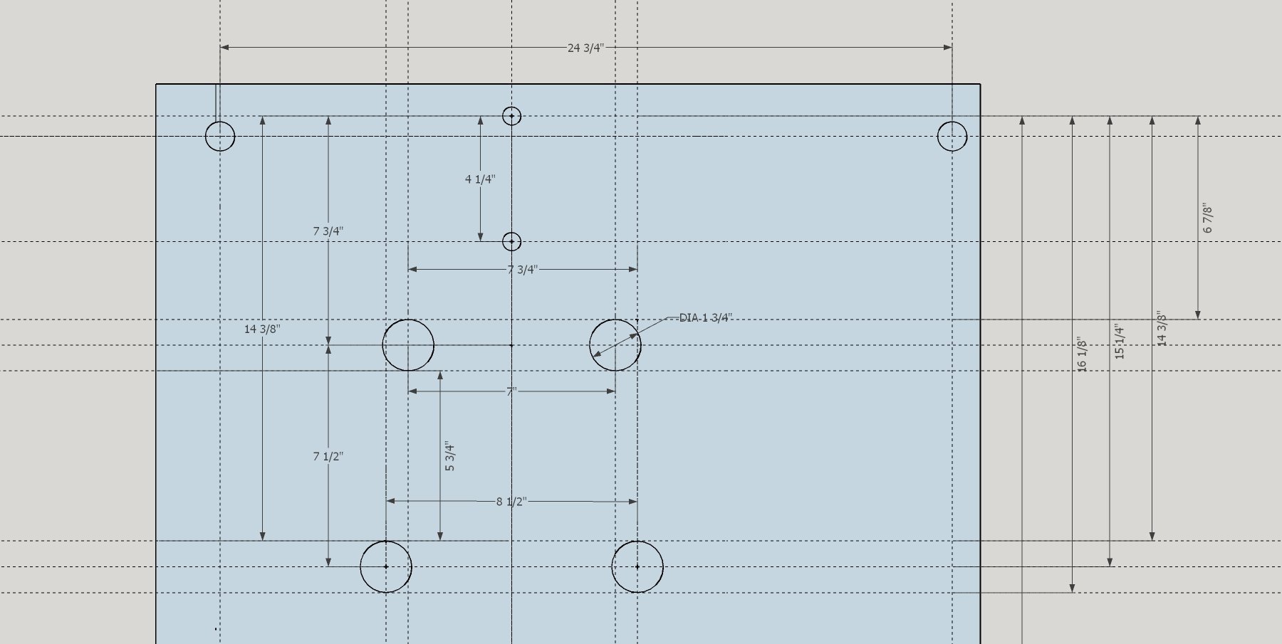

I am unable to get to the shop to measure the spacing between bench and way tubes but I have this sketch which indicates to me that the separation between those tubes is 5 3/4". Note though that this is a sketch depicting tube and shafts of a 520 but the bench and ways are the same for both.

Thanks Dusty. Your dimensions help to confirm some of my findings.
I did get out to the shop today and I think I may have sorted out my confusion.
Your dimensions and my support instructions both confirm that the height between the two sets of tubes should be 5 3/4" but that's only when fitted to the new tilt bases, which of course is my ultimate objective.
However, those dimensions are not the same on my unconverted 520. In fact it seems to be all over the place. The heights compared to 5 3/4" vary by as much as 1/2" from extreme left to extreme right and from front to back. ISTR that when I fitted the PowerPro into the old headstock, there was an adjustment which would change the tube relationship by rotating the Way Tubes. This may account for the discrepancy.
Ultimately, I guess this doesn't matter as the dimensions will be correct when the new bases are installed. I've checked the bases with callipers and they're spot on. Looking at the way the headstock currently sits, even lowering it by up to 1/2" would not cause it to foul the Way Tubes, due to the sloped of the lower casework.
My only concern is that when I install the first base, the other end of the tubes will still be in the old base at the old dimensions, which could cause distortion at the end of the tubes, as they would slope towards the new base. I'm hoping that if the retaining screws in the original base are loosened first, there will be enough tolerance to allow the tubes to "bend" without actually bending at the ends.
