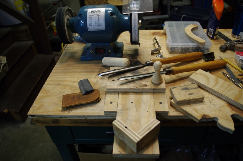

First turning project
Spent the day today cleaning all the lathe parts on the SS and the tools, building a sharpening jig, and sharpening a few of the chisels. The PO threw in a nice set of Disston chisels. The pawn is my first turning--just scrap pine, but I have in mind turning/carving a whole set out of something better.

Those are most likely coping saw blades, that someone has punched the pins out of.chipmaster wrote:Thanks for the compliment! I'm using standard blades that the PO supplied--Deltas. I'm not satisfied with the way they're matching up with the mounting blocks. Still fiddling. It almost appears as though the blades are supposed to have holes in them. Do they make them that way?
