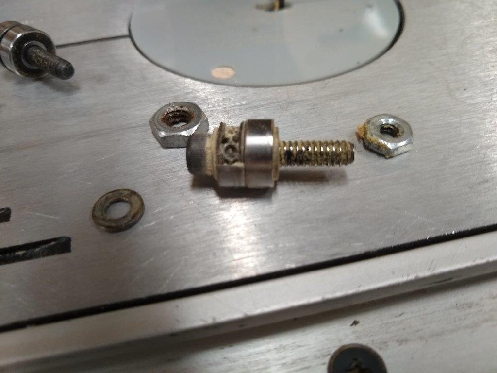

A couple years ago I switched the old SS style guide bearings out on my bandsaw for the dual bearing Carter guides.
After about a year of use, not particularly heavy use, I managed to damage one of the bearings.
I bought 2 replacement assemblies and now have managed to destroy them both in about 5 months time.
The interesting thing is - its always the same bearing and location that goes . Its in the upper guide, the inside bearing to the open side of the bandsaw.
Heres a couple of pics of the failure mode on/off the tool.
Carter provides the "assembly" ..I'm not pressing bearings on the bolt or anything.
The only thing I've noticed is that on this particular bearing , there is very little slop available compared to the other locations on the upper and lower guides. Normally, you can loosen the bolt and shift the bearing a bit left or right to adjust the gap to the blade. On this bearing I cant shift it very much off the blade. There is a tiny gap, but not much.
I'm tempted to open up that particular bolt hole a bit to allow a little more clearance but any other suggestions would be appreciated before I start drillin'

Thanks John for your experience- its an annoying problem. There is a small clearance when the blade is not turning. I have put a pencil against the bearing while the blade is turning and it is not spinning (so no contact with blade to bearing) ...but when something keeps happening, its time to do some detective work

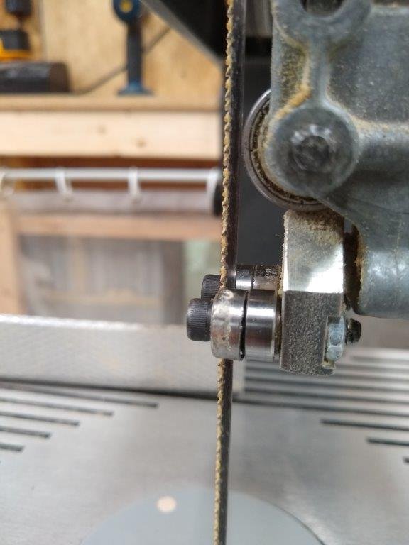

Perhaps the backing plate is forcing the bolt askew on that bearing because it's not drilled right. The bearings are pretty close to the teeth in that photo, if you can't adjust the bearing distance to blade properly then maybe you're up against the teeth. Even if the bearing isn't contacting the set angle of the teeth, contact with the gullet could still heat up the bearing.

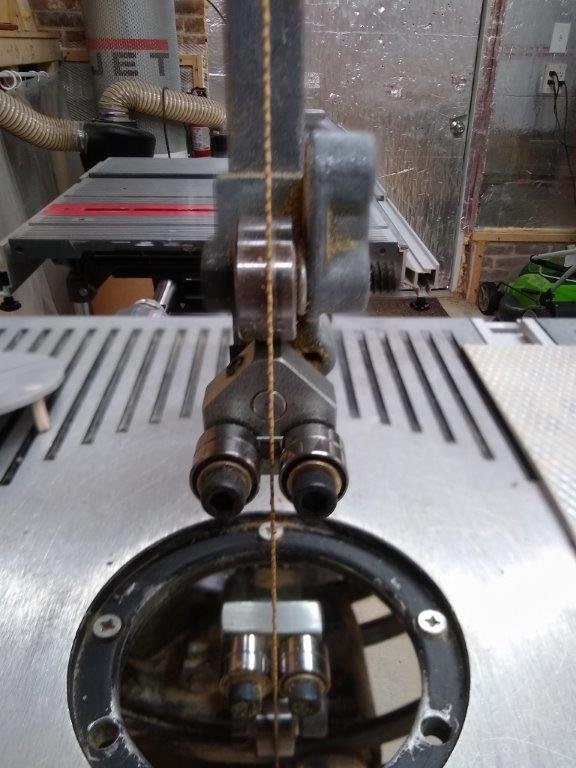

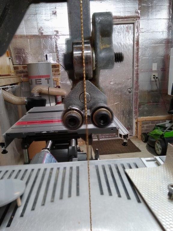

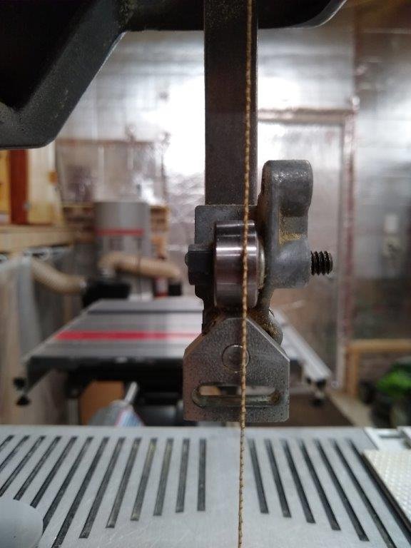

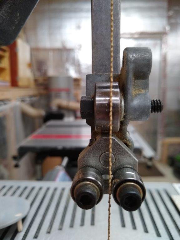

Alright- fresh carter bearings have arrived.
While replacing, I did notice a blade offset from the center line of the guide bearing.
This offset was causing the right hand side upper guide bearing to be unable to adjust any further away
from the blade. This was the bearing I burned twice.
I went thru the various adjustments to center and did manage to improve it somewhat. however, it seems that if I align as described by the manual (with the guide adjusted down to about 1" off the table) ..I get a center align in that position, but if I then adjust up to an open position (like 5" opening) the guide starts to drift toward 1 bearing or the other. Its better than it was, but im wondering if the guide shaft itself may be bent, or if I just need to "fiddle" around - thats taken from the manual ..some more to get it better.
