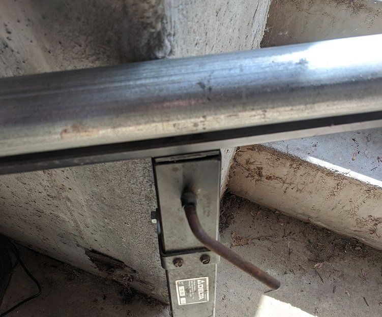

Use a long bolt and bend it to make a crank handle.

edma194
Posts: 2205
Re: Roller Stand Repair
Post by edma194 »
Here's a shot of one of my ancient roller stands showing what I meant by using a bolt to make a crank handle. The nut is pretty sturdy on that thing but it doesn't have a pressure plate like on yours. Gotta see if there's room in there to slip a piece in.
Ed from Rhode Island

Yeah, I would think that a bent bolt would be about the cheapest yet most durable way to do a crank handle. Why they all keep using a soft plastic handle that strips out is a mystery to me.

edma194
Posts: 2205
Post by edma194 »
Plastic will soon be broke while the bent bolt keeps working.
