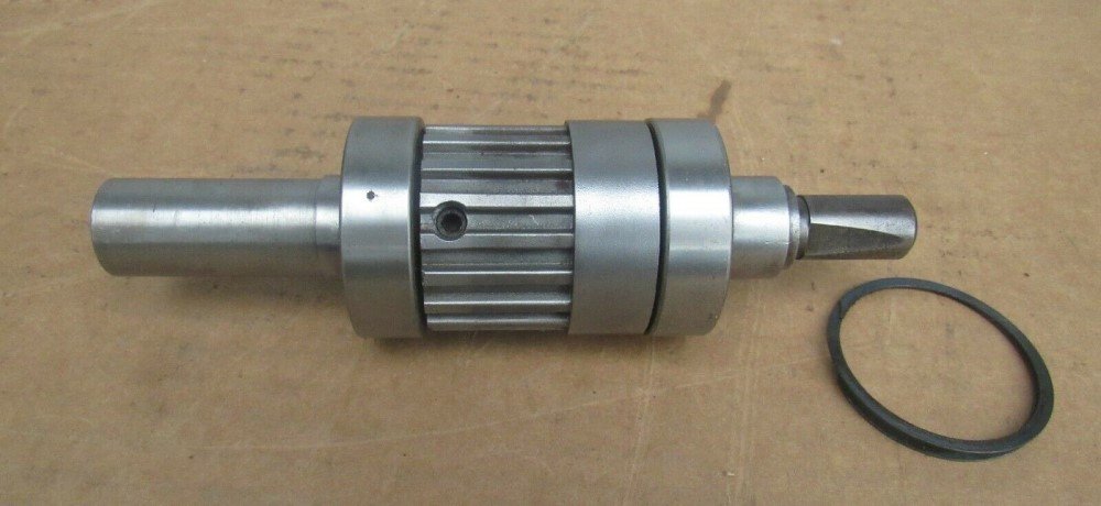

As for the Gilmer Drive Sleeve Assembly used in early Mark 5 tools there were two versions. The early one did not have a clutch and can be identified by the picture below.
_ .
Notice that the set screw that holds the gear in place is in the gear teeth. If you have this type of Gilmer Drive Sleeve Assembly the set screw should be very tight and you may need to replace the set screw if it is slipping. A common cup type set screw is best here.

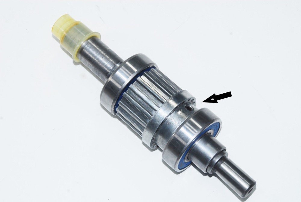

Below is a picture of the clutched Gilmer Drive Sleeve Assembly that soon replaced the non-clutched version.
_ .
The arrow shows the location of the set screw. This set screw should also be very tight and if needed replace it with a common cup type set screw. As has already been mentioned too much slippage in the clutch system is a problem while too little slip makes it work the same as a non-clutched Gilmer Drive Sleeve Assembly. The set screw keeps the collar attached to the sleeve itself that transmits power to the quill's spindle.

Ok, thanks,, I tried looking in various places, I found a spot where they gave some suggestions. But even going with the lowest torque they specified I split the screw hole at it's thinnest spot. The gear was pretty beat up so I really didn't care about it, I got it on ebay as extra parts. I'm just glad I tried it on a scrap piece. I'll keep looking I guess.
Re: How hot is hot?
Oh, yea, I just now saw the pictures of the two types. The one I split was the older version. Like I said it was trash to begin with. I was just going to keep it as a immediate back up piece. I have two headstocks that I put in new bearings, they both have the slip type. The idea of the new set screw sounds good though. Maybe the original one got the cup portion worn out, not allowing the set screw to get a good bite. I'll try it.
Thanks it's appreciated.
