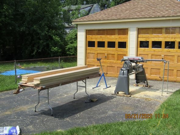

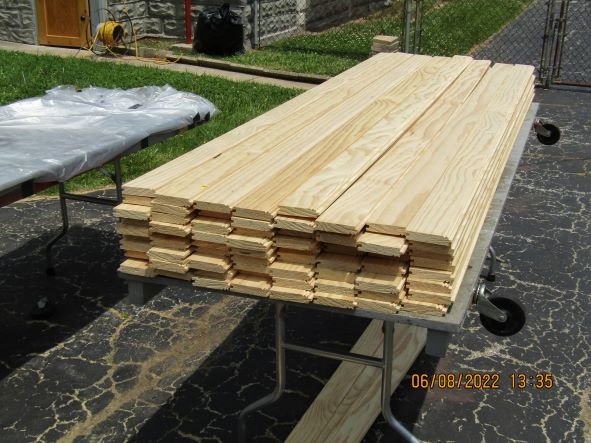

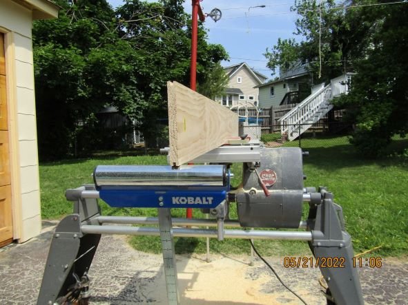

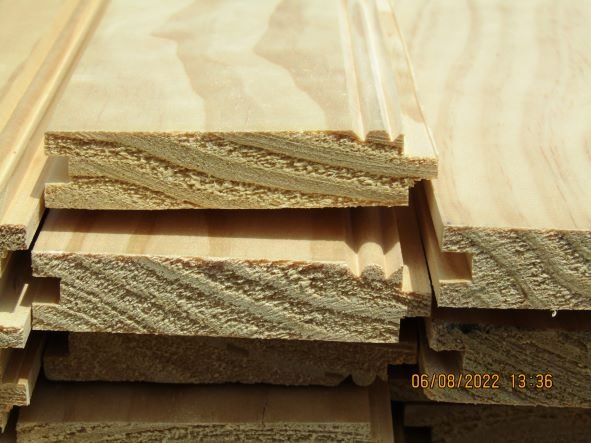

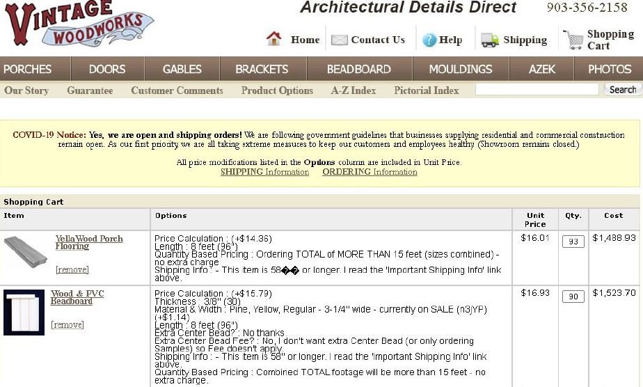

Update. I decided to mill the beadboard and buy the floorboard. The floorboard is pressure treated which is a must-have so I'll buy it.

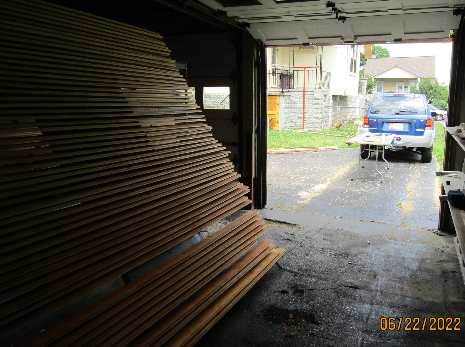

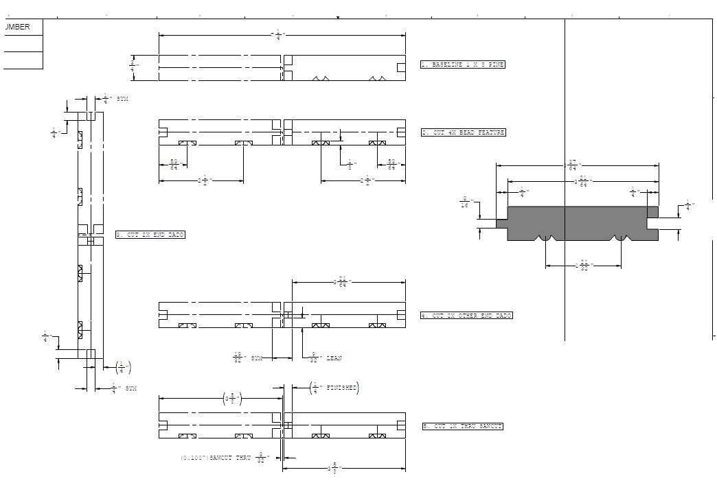

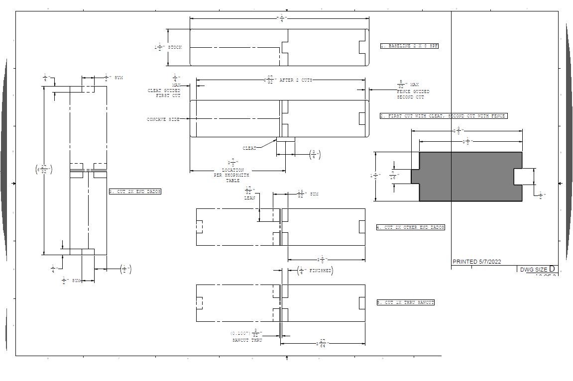

Just finished milling the beadboard. 36 pieces of 1 x 8 x 8ft select turned into 72 pieces of T&G porch ceiling. $32 per board. Ouch. But it was nice material and ran through with minimum bend/bow/twist.
I plan to put rock glass bat insulation on top of this ceiling. The 3/4" board thickness should bear the insulation weight without any bowing.
Next steps, some light sanding, stain and varnish. Shall I varnish each piece seperately before installation?
For the beadboard I used a Woodline #7541 profile cutter. I don't expect to be making any more beadboard; if anyone wants to buy it, PM me.

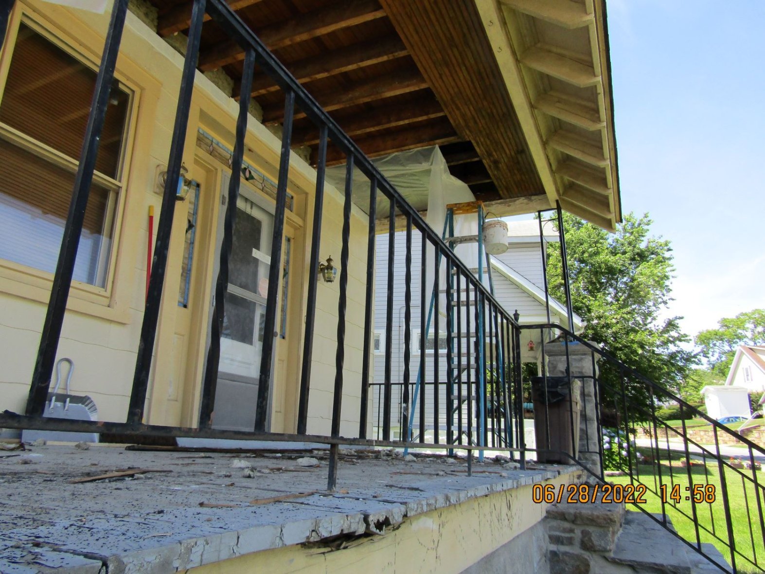

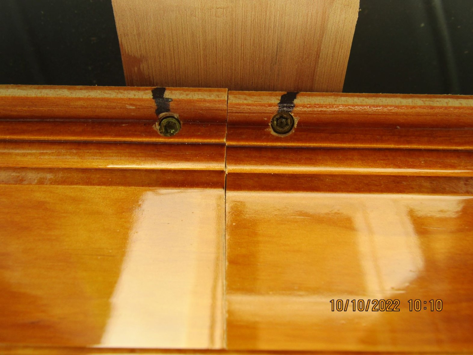

Update on this thread. Finally got the new ceiling up. Porch is still a work in progress but I thought I would post ceiling photos and lessons I learned re T&G beadboard ceiling installation.
Old house with old porch ceiling joists. I started this job thinking that shimming the joists "as required" would be sufficient to get a flat mounting surface. Forget that. I finally screwed 2x4 to all the joists and then scribed laser level dots to define "flat" on all of them, then took them all down and bandsawed to the scribe. Then re-screwed them back up. Then I had a good flat mounting surface.

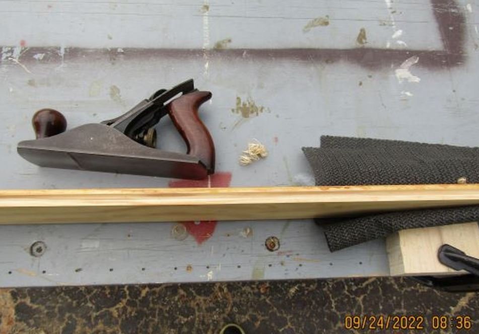

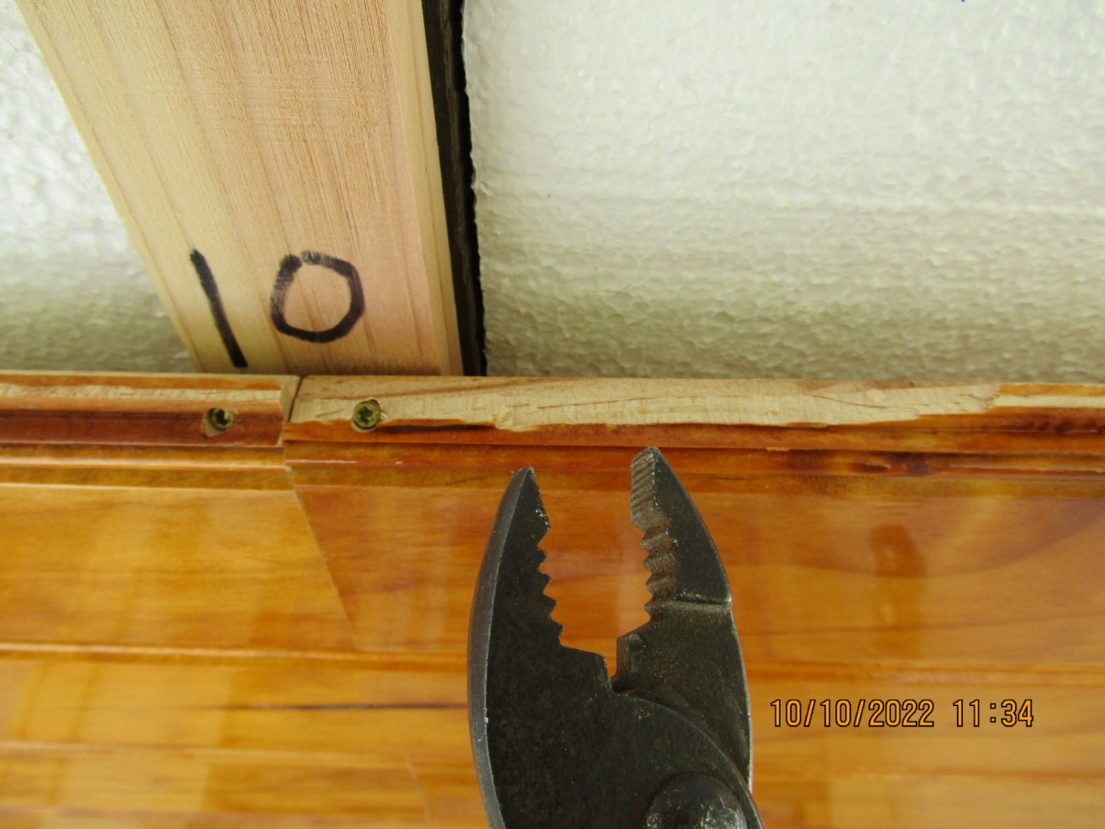

I also thought that by cutting all my tongues and grooves very carefully, then 8-foot long T&G boards would fit nice together at install. Nope. Even with the most precise and consistent cutting, the slightest warpage will screw up T&G fits. From this I learned that the max practical length for a T&G board is 4 feet. Also I did additional planing and scraping on all the tongues and grooves, and also waxed them - and even this did not help much. Any warpage screws up the fit. Shorter boards are a must. Making the T&G dimensions sloppier is not the solution.

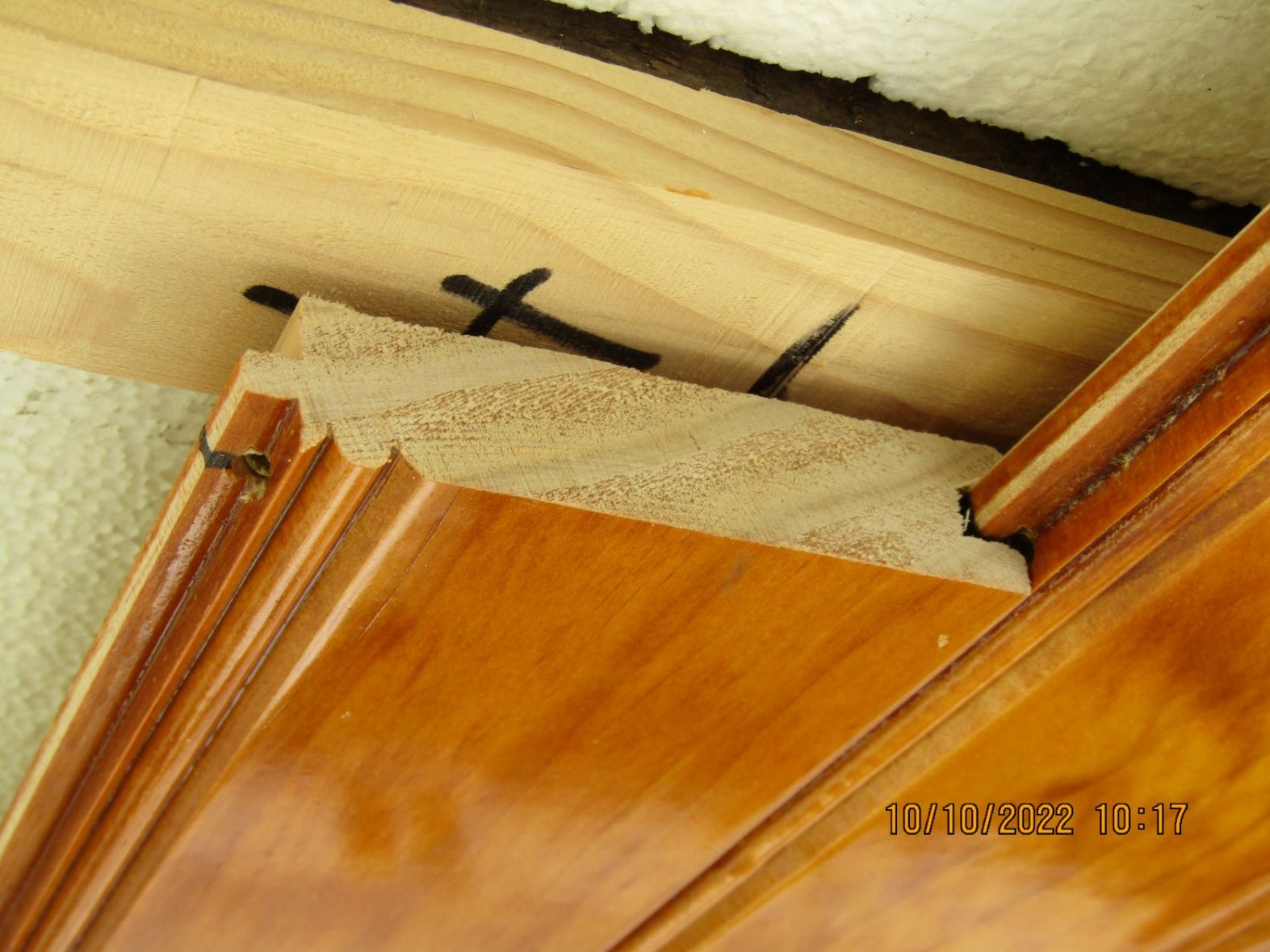

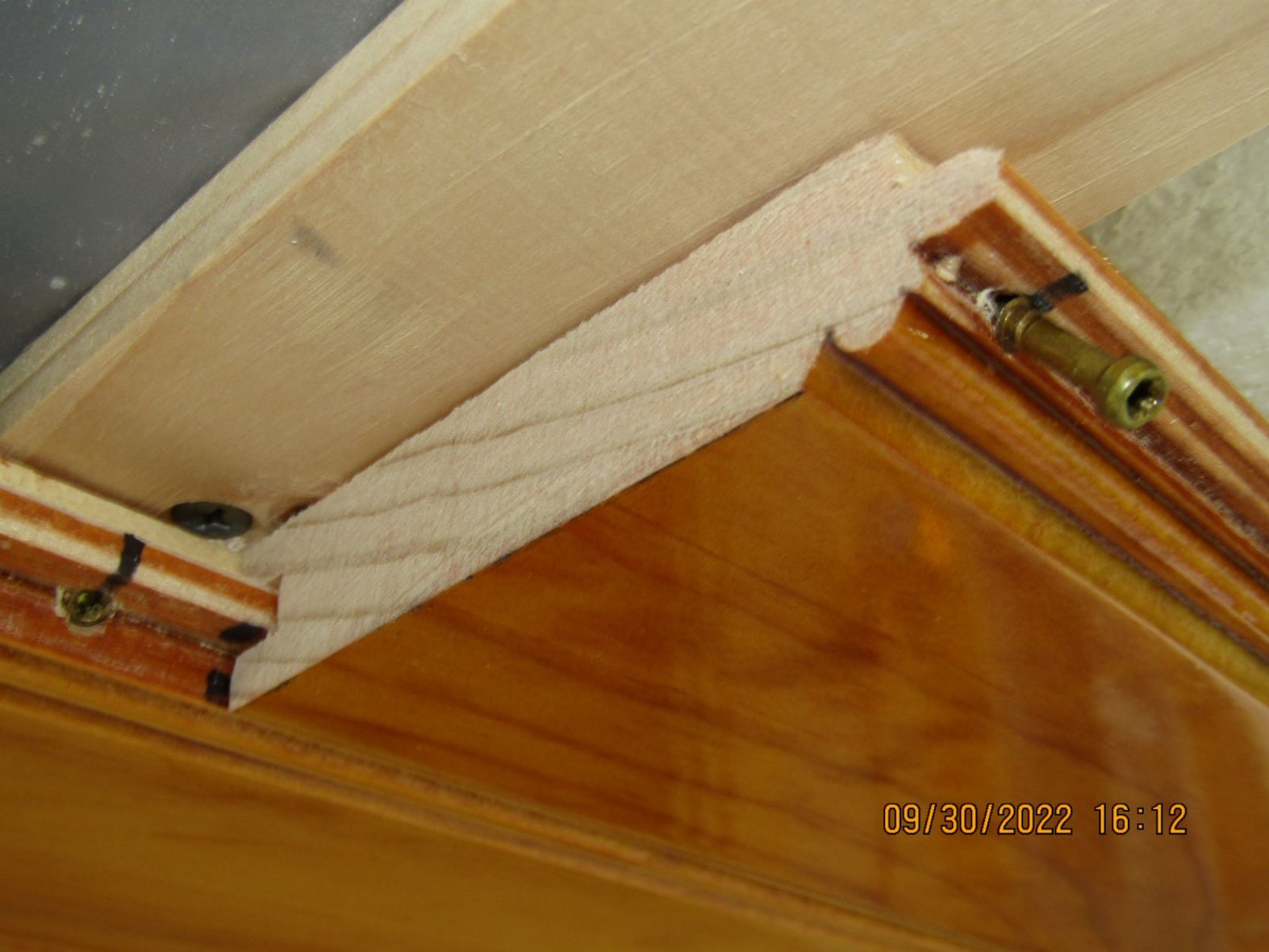

I mounted the boards using the classic hidden-fastener toenail into the tongue, but I used screws not nails. This was a good choice. See pictures. I used "trim head screws". These have a finish-nail profile but they screw in. They have a small star-drive head. I pre-drilled for each of them to avoid split wood. These screws worked great. They gave me the option to back off the screw to get a better fit with the abutting board. Even with all the careful millwork + laser-levelling, board-to-board butt joint matchup was a challenge, and these screws gave me some adjustability.
I pre-varnished all boards before install. Used analine dye to bring out the grain, then 3 coats of Helmsman. Varnished and dried on an indoor rack. 2 coats wet-sanded and the third coat was laid thick and no sanding. Very good result I think.

- Beadboard indoor drying rack
- IMG_2371.JPG (365.28 KiB) Viewed 2636 times
- Old ceiling teardown - a mess
- IMG_2381-2.JPG (344.35 KiB) Viewed 2636 times
- Planing and scraping T&G for better fit
- IMG_2468.JPG (79.03 KiB) Viewed 2636 times
- Screws instead of nails
- IMG_2475-2.JPG (275.99 KiB) Viewed 2636 times
- Screws instead of nails (2)
- IMG_2480-2.JPG (186.11 KiB) Viewed 2636 times
- Screws helped to adjust board-to-board fit
- IMG_2484-2.JPG (226.94 KiB) Viewed 2636 times
- Predrilled the tongue to accommodate the screws
- IMG_2489-2.JPG (252.61 KiB) Viewed 2636 times
- Biting off the tongue to fix a misalignment
- IMG_2490-2.JPG (204.11 KiB) Viewed 2636 times

"Wondering if you had much splitting with screws on this? Also, what brand & color dye did you use?"
The dye was a mix of Transfast and Moser's, analine powder, water soluble. Orange + Golden Oak colors.
I had no wood splits with the screws because I pre-drilled. More up-and-down on the ladder but very worth it.
The screws also completely eliminate damaging the finish by hammer.
