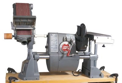

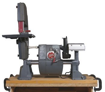

Shopsmith makes what they call the Shop Deputy kit which is two 26" long Way Tubes plus hardware which can be seen at the link below and is shown in the pictures below.
https://www.shopsmith.com/ownersite/cat ... deputy.htm
As I understand it from your original post, you want to have both the Bandsaw and the Belt Sander mounted at the same time. 26" Way Tubes look to be too short for that purpose. You need to allow for the Belt Sander to overhang the Way Tubes when mounting it on the right side of the Headstock. The Bandsaw can only be run correctly from the left side of a conventional Headstock. The Belt Sander can be run correctly from either side of the Headstock having the drive shaft on both sides of the drive drum. Remember Bench Tubes are 3/4" longer than Way Tubes.
