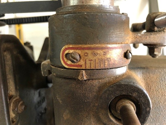

I put the shorter AL220 belt on the headstock's smallest pulley step (2") and the longer AL250 belt on the largest motor pulley step (6"?), trying to keep the tension equalization springs even. However this arrangement left the belts surprisingly slack. To get 1/4" pinch tension in each belt I had to pull back the engine to the point where it's almost falling off, and the speed changer's indicator read below 0 -- but I'm not sure where I went wrong. I have supplied pictures to help pinpoint my error.

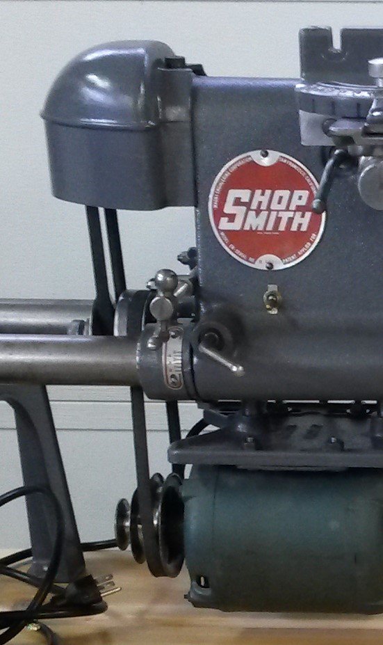

As Ron and Darren have said the Speed Changer Pulley is not adjusted correctly. The belts Skip supplies are very good belts and not the problem. Right now the Speed Changer is simply transmitting the motor pulley speed to the headstock pulley since both belts are "bottomed out" on the Speed Changer's Pulley. Turning the crank is only risking breaking the assembly. I would recommend removing the belts and take the Speed Changer Pulley off to adjust it and likely maintenance. Without the belts in place simply unscrew the knob on the end of the shaft and slide the pulley assembly off. Now is a good time to check for any needed maintenance. Clean the assembly if necessary. Lubricate if needed so the floating sheave slides freely back and forth between the fixed ends. I like to adjust the fixed ends of the pulley assembly while it is off the rest of the Speed Changer assembly. One belt should almost touch the bottom of the pulley while the other belt is held at the outer edge of the pulley. The ends of the sleeve the pulley sheaves attach to should protrude near evenly on both sides. The picture below shows a Speed Changer mounted on a Model 10ER and note the belt is low on one side of the pulley assembly while the other belt is at the top.

I believe you understand the concept. Your drawing shows about where your belts are in the picture in your first post. In the diagram below, from a Speed Changer Manual, it shows the belt positions for both the low and high ranges. Notice that the belts are near the end of the speed range on the Speed Changer pulley. This is near where you want to get to. Adjust the outer fixed sheaves inward toward the floating sheave to have one belt almost touching the inner sleeve while the other belt is flush with the outer edge of the pulley assembly as I indicated before. Once the pulley is adjusted properly the speed indicator, shown in the fourth picture from you first post, can be set. With the speed at the lowest for the range of either low or high, loosen the two screws on the 0 to 5 indicator and align the 0 with the arrow. This will then give you the approximate speeds shown on the chart. With a properly adjusted pulley the speeds should be quite close.
Remember, NEVER try to turn the speed adjustment crank past the point the springs begin to compress to avoid damaging or breaking the castings.
