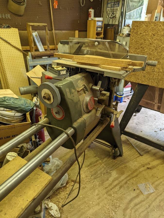

Speaking of Greene, if I attached the picture correctly, the end cover with the Serial and chassis is green, the head seems to have 2 forms of tan, may have been replaced at some point? Not sure if there is any way outside of the serial to understand more.
1955 Mark 5 Greene "A"
Needs Un-Gilmer'd and some love.
Re: Just bought a Shopsmith Mark V
Yep there is.
You have a "Type "A" headstock. It is the earlier sand cast version(heavier, thicker walls)
The belt cover screws tell the tale. And the wide headstock mold sprue [aka joint].
The two tone casting/motor pan colors is the result of the passage of time.
The saw blade cover(s) is not period accurate, but is an example of the upgradability.
You done good!

DaOldGuy wrote: Fri Jun 24, 2022 10:01 pm What I was reading indicated how the pipes clamp into the frames and the newer had a set screw/pin from the top that prevented that separating with the lathe pressure.
The newer machines have that set screw on top of the way tubes. They are simply relocated from the bottom for convenience, nothing new structurally.

Yep just like a M10! I do not understand WHY they were relocated on the M5 unless the same mentality that decided to fill in the headstock set screws with whatever that stuff is to prevent unwary souls from monkeying with them.

Indeed the saw was an upgraded version, there is much plastic involved. I took it all off yesterday to use my Mahindra to lift, with straps, off of the trailer and set in the garage. The Jointer was very old like the rest.
Cleaning and recommended maintenance will be next and setting it up.
