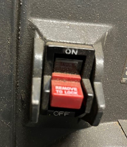

I have a shopsmith that stays running unless the power is disconnected. There is a safety key in it that looks like it is not in all the way but it should not start with it out. Any ideas would be appreciated

The only thing that interrupts the power to the motor is the switch. Seems like you need a new switch. Something is wrong with the switch mechanism if the safety key will not go in all the way.

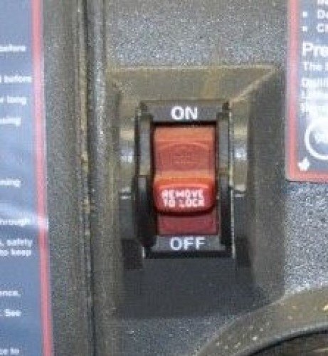

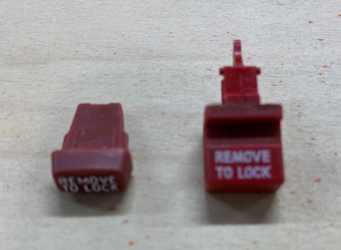

The Red Safety Key Switch is used in all "C" Headstocks. That is any headstock from 1991 on. There have been two different Red Key Safety Switches used since the "C" Headstock introduction that I know of and the keys are different. Outwardly the switches look very similar but the keys are very different. The problem may be a damaged key which is more likely in the early switch, damage to the switch itself or something in the way of the key fully going in. Remember if the switch is in the on position the key would have to be reinserted with the receiving part in the on position. The picture below is the two different keys used in these switches. The one on the left is the newer style key and the one on the right is the older style key.
_ .
Below are the complete switches with the first being the newer style and the second being the older style.
_ .
If there is no damage to the key for your switch, try to SEE if anything is in the way inside of the switch that is keeping the key from going all the way in. If nothing is seen blocking the key it is likely a problem that will require replacing the switch. The switch is part number 556089 Headstock Locking Rocker Switch and is currently on sale for $25.93.
