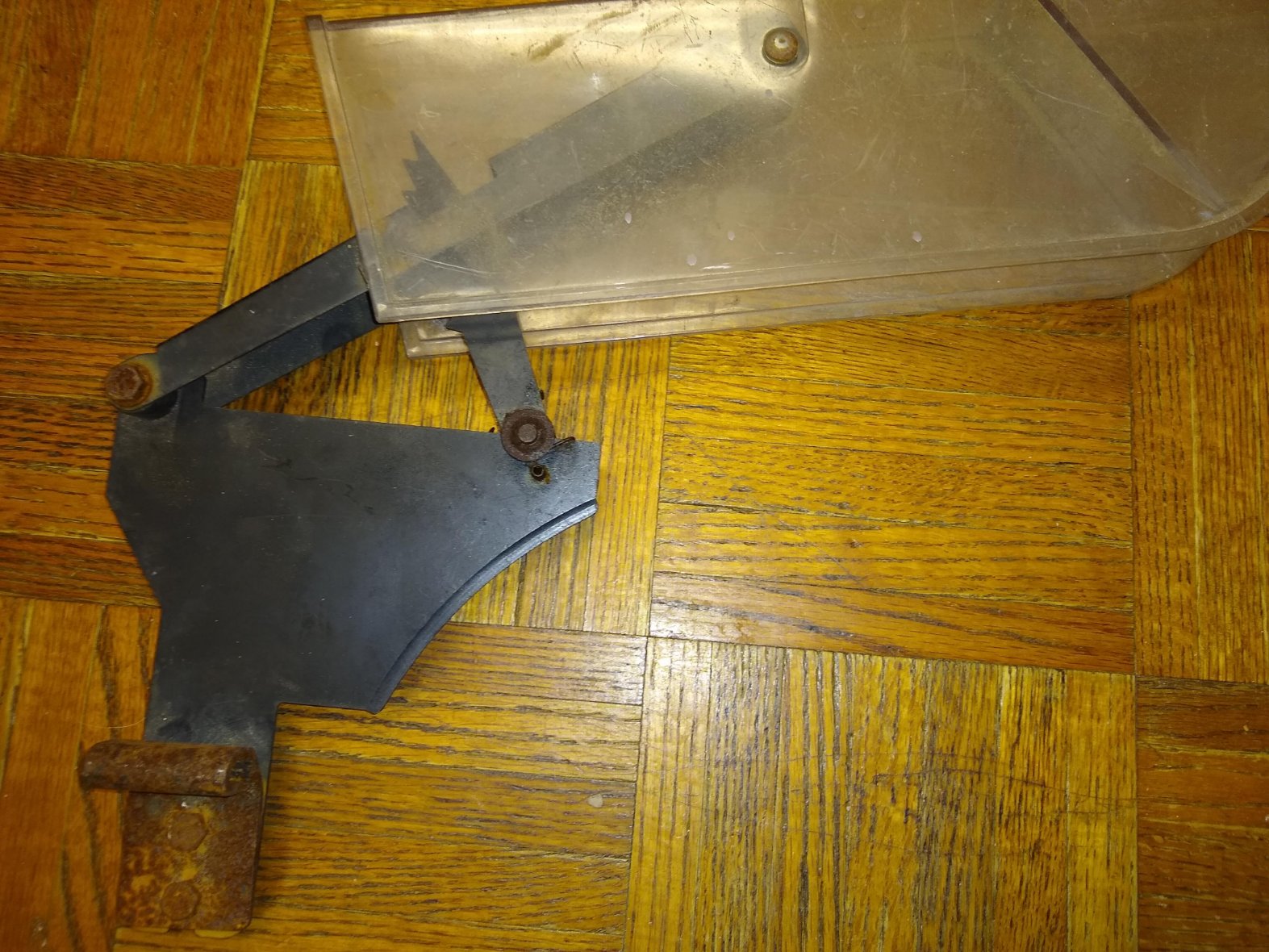

By the way, anyone know what this guard is for? It came with the parts I got on my used Shopsmith.

The picture you posted above is an Upper Saw Guard (stating the obvious here) but for what saw. Not a Shopsmith one. Many times non-Shopsmith parts get mixed in when you buy a used Shopsmith tool. A Mark V I bought a few years ago has a Craftsman Table Saw Guard with it which I recognized since I have one. The seller had a Craftsman Table Saw sitting across the room and I had him keep it for the correct tool.
