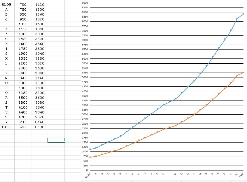

I am attempting to make sense of this chart. I think the content of this chart is from Shopmith.
700 1120 Slow

5250 8400 Fast
The numbers are, at best, close approximations of my real world numbers.
I would expect the ratio of motor speed to idler speed (3450) to be consistent but it certainly is not.

Re: Mark V Speed Control
Plot of above speed chart submitted by OP. Shows a (moderately) nonlinear relationship between dial marker (equally spaced letters) and actual speed.
The geometry of variable belt drives can be tricky to predict. Exact linearity of output speed across the dial is not to be expected, but the deviation from linear appears to be not much. Why the '"real" speed differs so much from the chart speed is not clear. The 1.6 multiple does not explain it.
