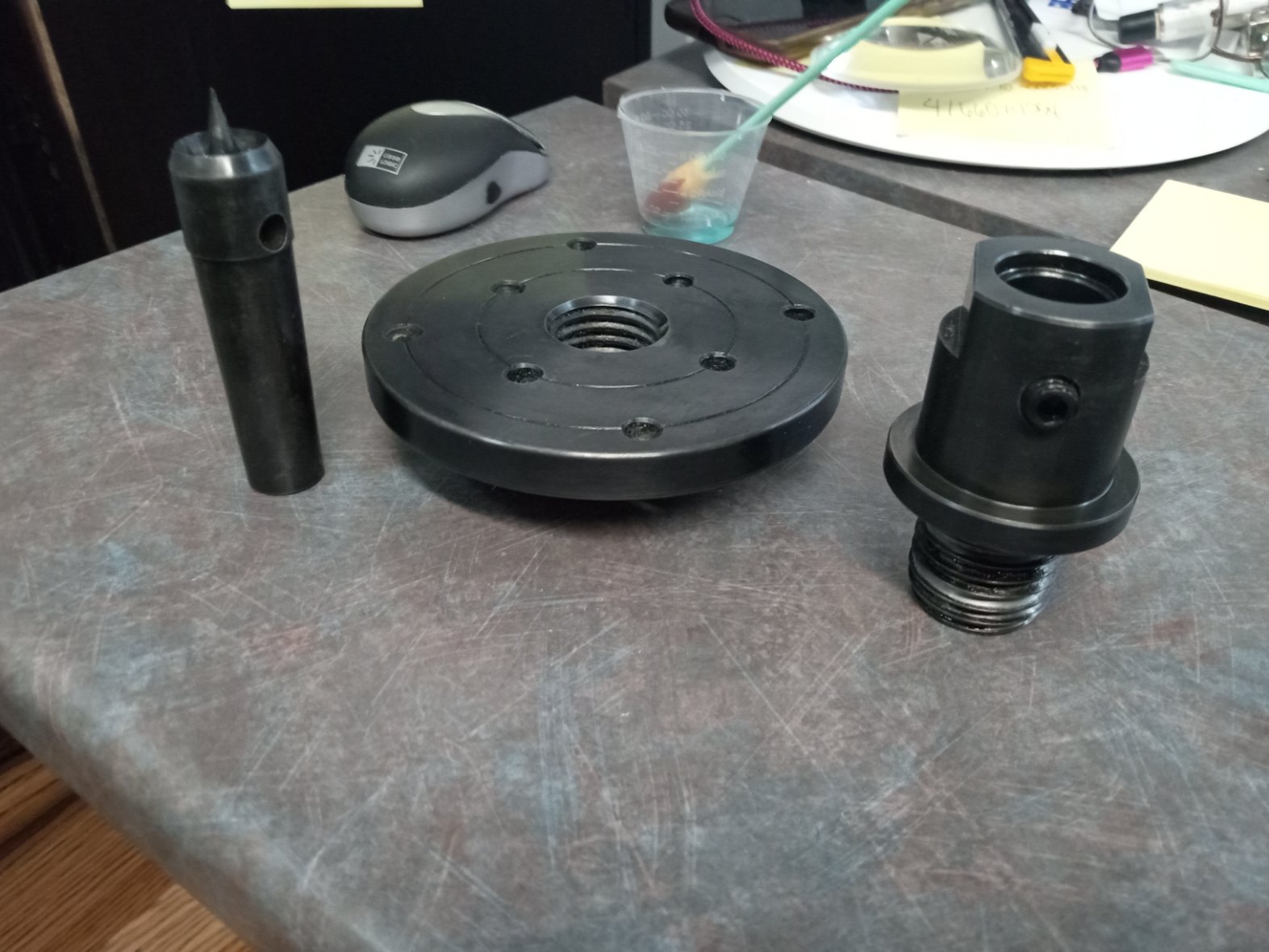

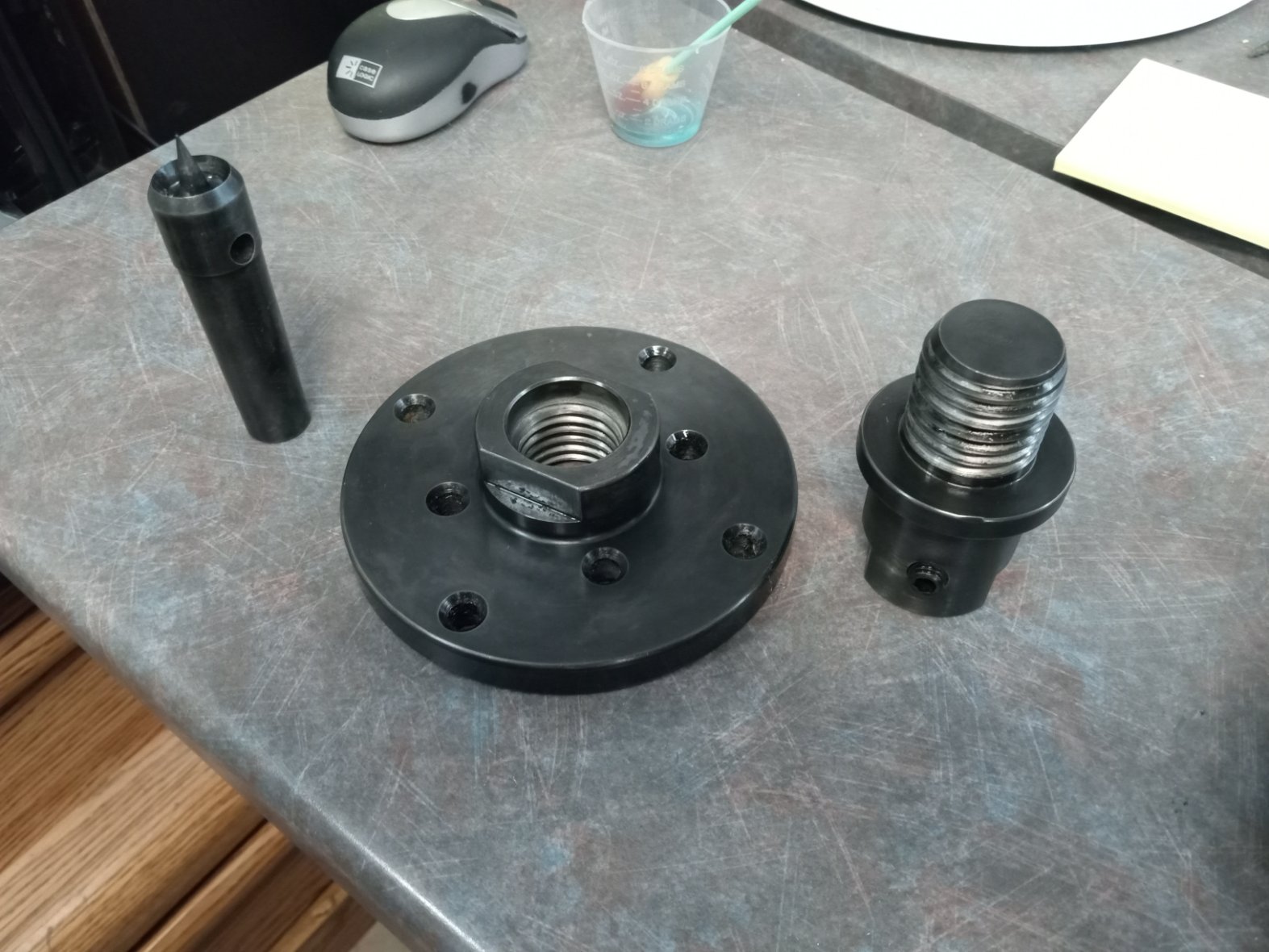

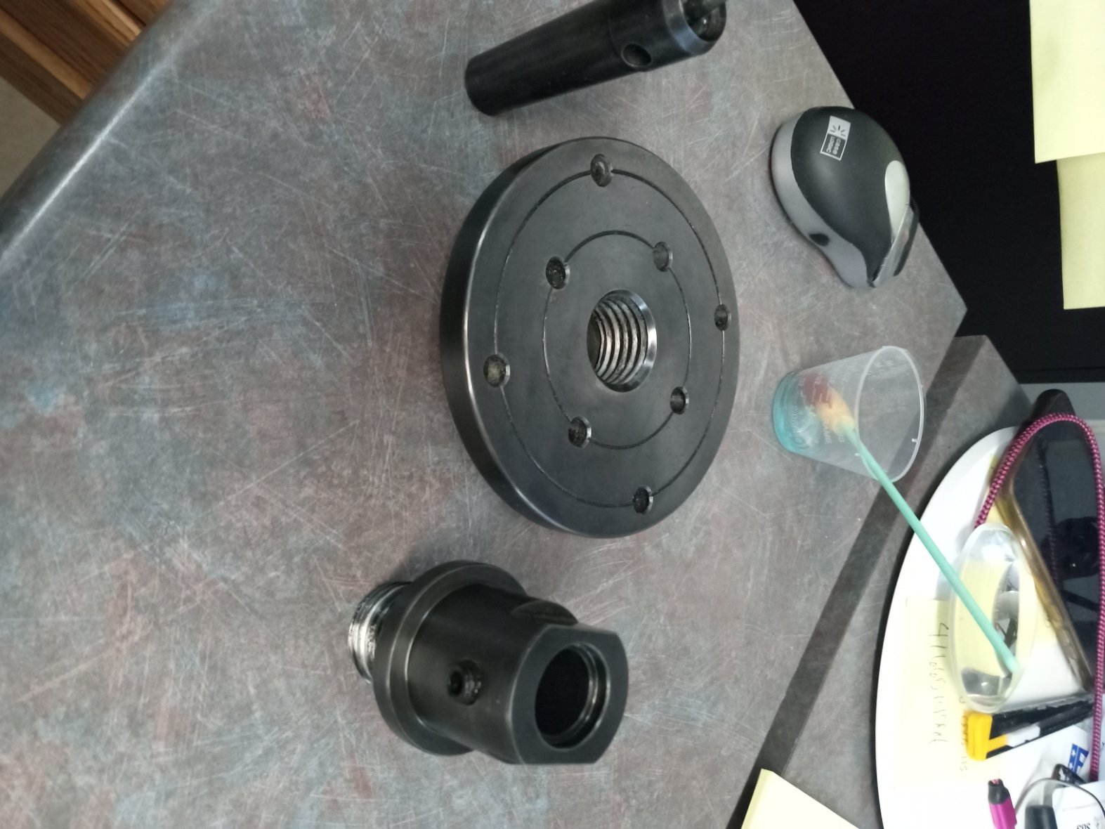

Hi Folks,
On another thread there was a short discussion around Bluing Shop Smith parts at are prone to surface rusting.
I got my Super Blue Kit the other day and I must say I am impressed with the product.
Today's first items
NEW Shop Smith 5/8 shaft to 1 inch 8 thread for adding the Chuck and Plate.
NEW 4 inch Mount Plate
Used Rusted Original SS Dead Center that had been rust reclaimed.
Acetone wash all parts
Scuff with Scotch bright and Acetone again.
Pour Bluing into small cup for foam brush (never dip in bottle)
Coat item wet with bluing and then rinse with water.
Pat and air dry.
Light scotch bright scuff to even out bluing and Acetone wipe
Coat again with Bluing and rinse with water.
Wipe and air dry.
I could have done another pass but they look good to me.
NOTE: Rust removal was completed with Loctite Navel Jelly
1955 Mark 5 Greene "A"
Needs Un-Gilmer'd and some love.

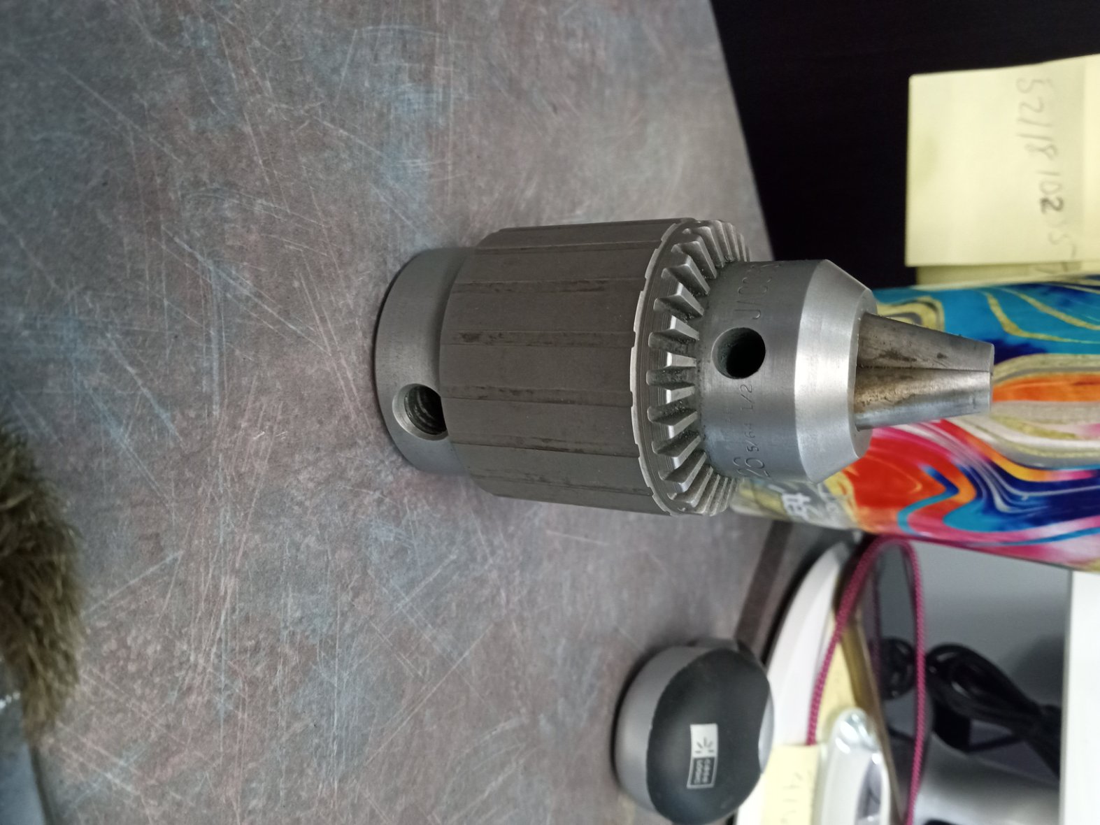

The Next contestants to be processed... I did the head for the Jointer, but forgot to get a picture of it. Since these photos they have been scuffed and took a soak in acetone. The Chuck I want to take apart, but I have to take it to town to put it in a Press.
