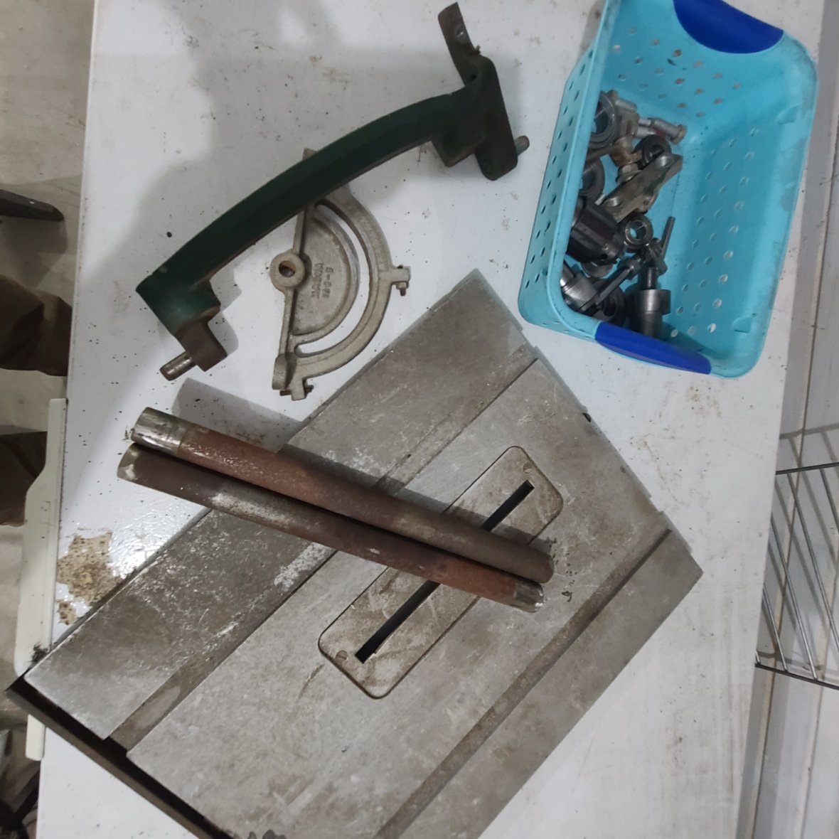

Help. What Are These Parts That Came With My SS 10E?

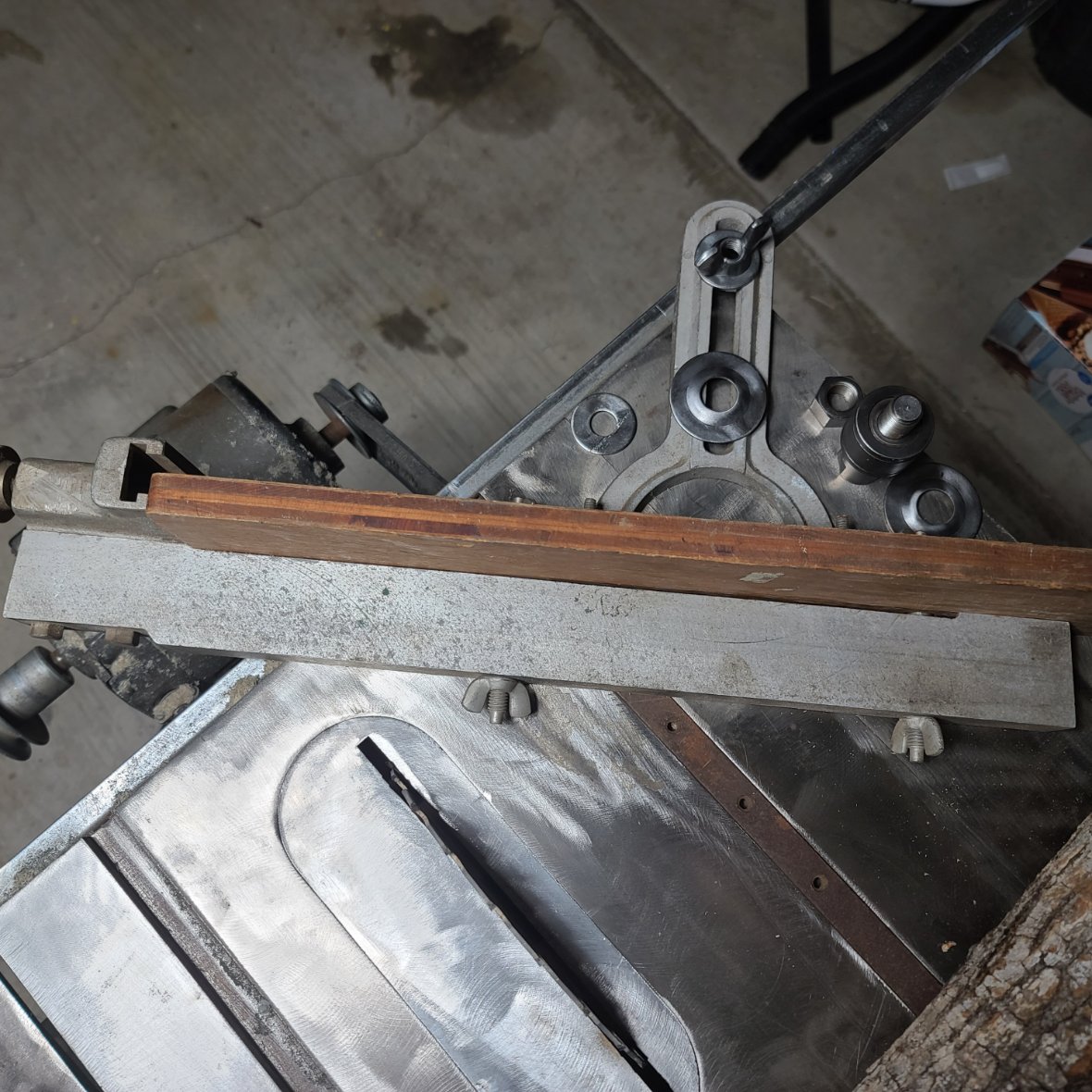

The Wood Extension Table does look like it could be original based on the size in relationship to the Fence. In your pictures the Fence blocks seeing the mounting holes. I have some of the original Wood Extension Tables and they are not in good shape except one is in pretty good useable condition still. I have made several replacements. There were actually two versions of the Wood Extension Tables. The difference is the holes and how the wood is mounted to the bracket.

I do think the table is original. The miter guage is for my Delta Rockwell saw though. I am getting in the habit of collecting good solid equipment that just needs some polishing.
I didn't get an SS miter guage with mine, i just got the extension table, fence, and saw guard. And the saw table, which is still in rough shape.
I did not get the sanding disc. I need to do an inventory from the packing list here on the forum to see what else may be missing.

chapmanruss wrote: Tue Aug 02, 2022 2:19 pm The Wood Extension Table does look like it could be original based on the size in relationship to the Fence. In your pictures the Fence blocks seeing the mounting holes. I have some of the original Wood Extension Tables and they are not in good shape except one is in pretty good useable condition still. I have made several replacements. There were actually two versions of the Wood Extension Tables. The difference is the holes and how the wood is mounted to the bracket.
Thanks again Russ, i really appreciate all the info. I do think this table could be original, it is in great shape aside from discoloration from age so I don't think it has seen as much use as the rest of the tool.

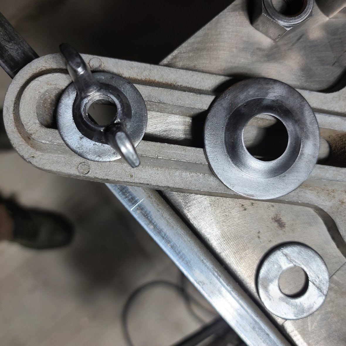

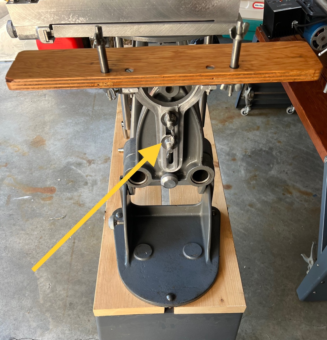

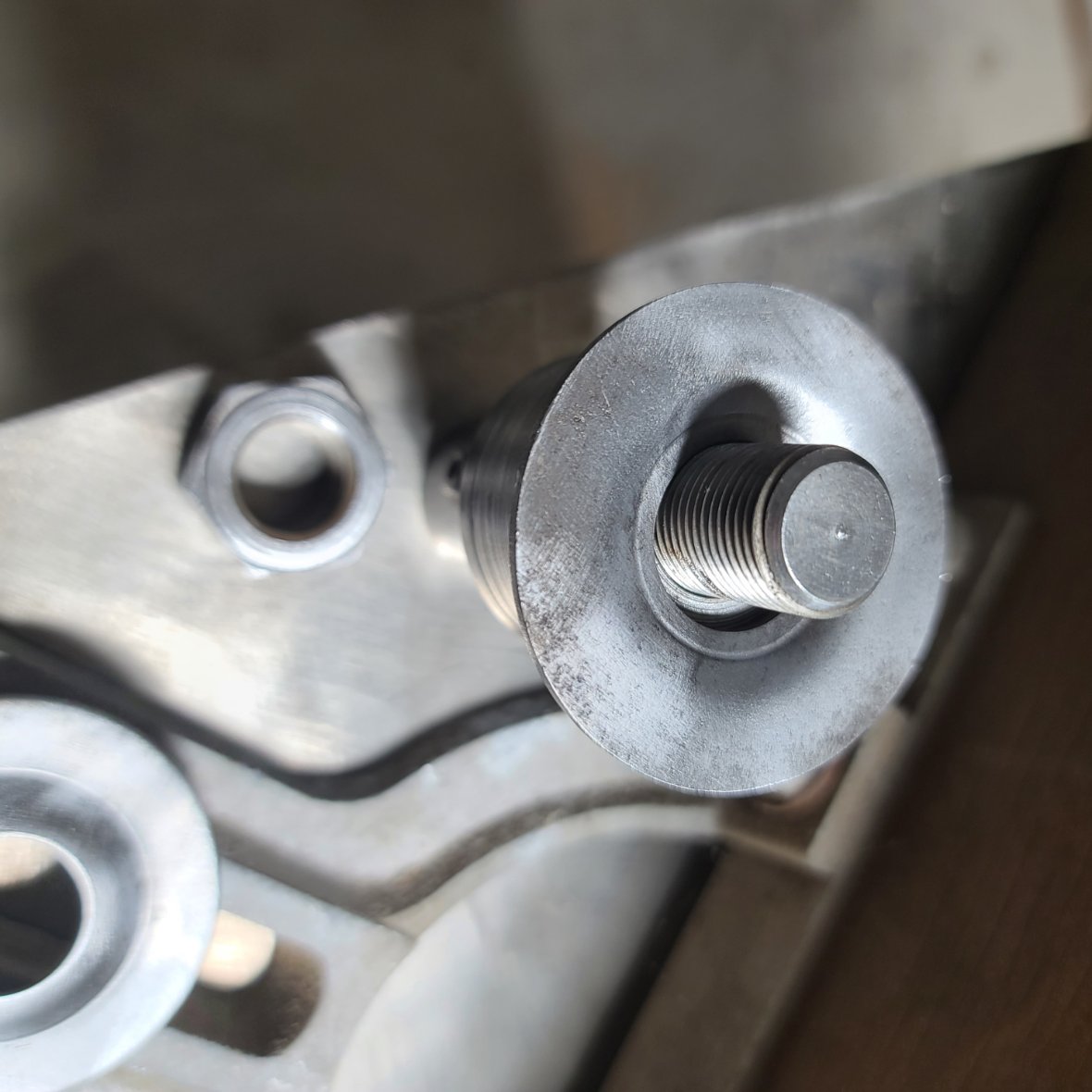

Joel - I’m a little late to the party on this thread, but I recall unraveling a similar pile of parts on my recent 10-E restoration, and was also perplexed with the washers you show attached to #11 in your original photo.
Turns out, those go underneath the wing nuts that attach the extension table assembly to the tailstock.
(And your plywood table looks to be original and similar to mine in my picture)

Actually, the washers on the post, item #11 are not the washers that are used under the wing nuts to attach the Extension Table Bracket to the Tailstock. Those washers are flat washers but the ones on item #11 have the raised center commonly used on arbors but not Shopsmith OEM ones.

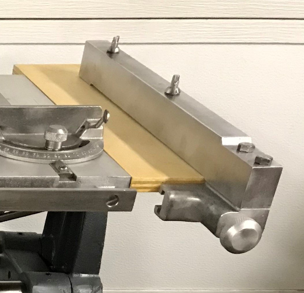

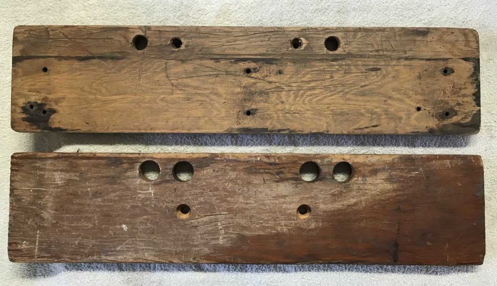

John's picture of the wood Extension Table is a good example of the later version. Below is a picture of the two different ways mounting holes were done for the Wood Extension Tables.
_
10E Wood Extension Table - both versions r.jpg (162.6 KiB) Viewed 1384 times
The top one is the second type having smaller countersunk holes for mounting to the bracket like John's. The extra smallest holes were made by a previous owner for some reason. The bottom one is the early type having larger holes where the wood mounts to the bracket and bar to allow the hex bolt heads room. This one has screws holding it to the bar from the underside. This one has two extra countersunk holes made by a previous owner probably because the screw holes underneath stripped out making it loose on the bar. The second way, like John's above, of mounting the wood to the bar and bracket was much sturdier than the early mounting. These are in pretty bad condition and I have made replacements for them.

jpdalton wrote: Thu Aug 04, 2022 8:04 am Turns out, those go underneath the wing nuts that attach the extension table assembly to the tailstock.
You are welcome to the party anytime John!
I like your idea, but i got those washers out and took a closer look and it appears Russ is correct, the hole is too big and the extrusion doesn't really make sense. I did find 2 additional smaller washers left in my goodie box that are a perfect fit, so you did wind up inadvertently solving that for me. Nice work.

chapmanruss wrote: Thu Aug 04, 2022 12:56 pm the ones on item #11 have the raised center commonly used on arbors but not Shopsmith OEM ones.
Yep, I think you have this right, and they are clearly not built for the arbors on the SS either -
They are likely from some non SS tool that may have been bolted onto this SS at some point in history, or maybe just unrelated, dropped into the box, and went for a ride to my house 🤷‍♂️

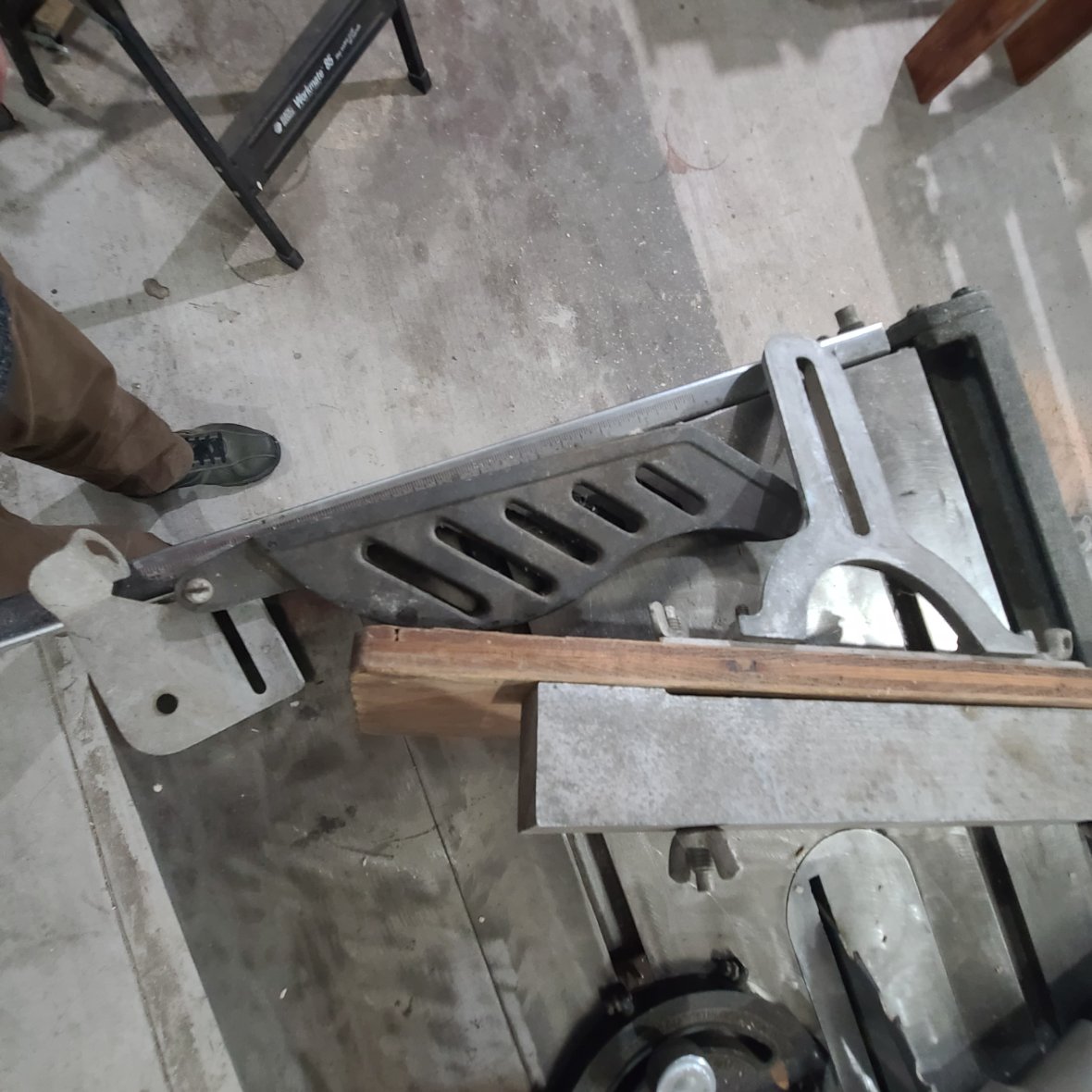

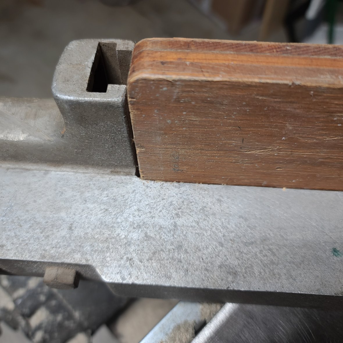

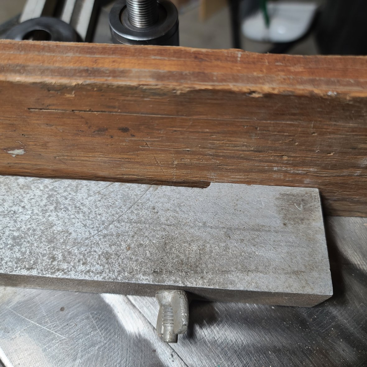

The extension table isninteresting. Mine is drilled like the top example in the picture. One thing that is not making sense is the way the fence sits on the table.
There is a small foot on the end of the fence that makes it sit unevenly on the table. That seems uncharacteristic for this well thought out tool. Am i missing some spacers or something that would level out the fence?

There is nothing wrong with your Fence or your wood Extension Table, it's just how the fence is made. All the Model 10E first version Fences (ones without a rear lock) I have owned are the same as yours. Below is a picture of one of mine sitting on a recreation wood Extension Table. It sits the same way as yours does. When mounted on the Main Table the Fence Base (P/N 107-1) attached to the Fence Bar (P/N 103-6) keeps the gap at the infeed side too. I don't know the reason for it but that could explain the design with the gap even over the Main Table. This does make the outfeed end of the Fence sit slightly higher than the infeed end of the Fence when on the wood Extension Table. This is not a problem while it is in use.

One downside of using the Fence on the Wood Extension Table is you have to align it every time you use it. You can have it very close with an initial alignment of the Table to the Bracket and Bar to the Extension Pins (double ended threaded posts) but there is still a little wiggle room there. Magna made the Metal Extension Upgrade available to existing 10E owners which was better for change overs not having to check alignment each time using the Fence on the metal Extension Table. One of the Model 10E's I have restored came with that upgrade along with the original wood Extension Table parts.
As for those raised center washers, I have had many non Shopsmith parts included with the Shopsmith's I have purchased including non Shopsmith Arbors.
