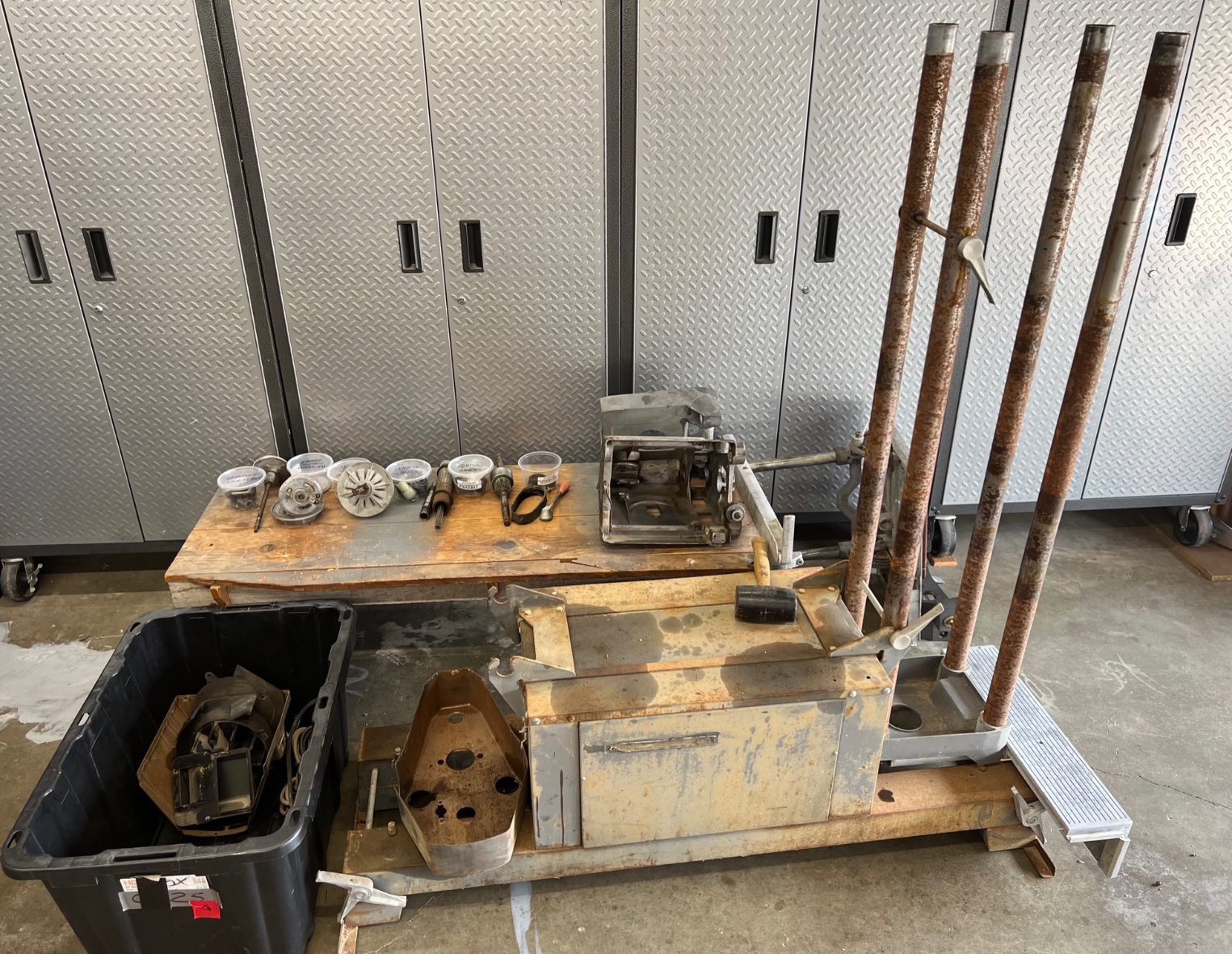

Almost completely broken down and JPG’s restoration thread was a lifesaver. Bearings were a bit.h to get off, everything else not so bad. Missing a few parts but nothing affecting basic operation. Motor sent out for rebuild as needed. Lots of elbow grease needed and JPG’s assembly drawings.
- 1288D7B2-BBD6-41AE-829C-D569376FC251.jpeg (756.91 KiB) Viewed 7759 times
I may be old but I’m slow

Hi Mike- what I get and what I asked for could be 2 different things. It’s a GE and I asked for new bearings, relay, the black tube thing, any wiring, an original switch if available or a switch that can provide forward/ off/ reverse function and I’ll make a custom plate and anything else that will make it as “like new” as possible. So everything and the kitchen sink in a perfect world but we know that will not be the case.
I noticed in your sig line you have a back up VII or parts. I’m missing a few parts if you have some available?
I’m really starting to appreciate this machine and the design. At 1st glance I didn’t know what to think but now I’m scratching my head in a positive way.

Hi Mike- been reading all the links and copied almost everything, with regards to disassembly, that JPG has put up. Will do same with reassembly when I get there. Your posts, JPG’s and many others are so very helpful and I thank everyone for all of the knowledge and kindness that’s been offered. Thank you for info on the switch and I read the back and forth on that so can make an educated decision down the road. Hope to find an original but can make a nice cover plate if not.
Other stuff I’m looking for at present:
1. Switchkey lock
2. Back cover of vacuum box
3. Vacuum bag and hose- though may never use them
4. Front cover of vacuum box if it has a good decal, or decal might be available?
5. Cam clutch assembly parts 4,5,6,7 in parts breakdown from manual
Other than item #5 I don’t believe I’m missing anything I can’t find a work around on or need to start it up. Not even sure if item 5 is 100% necessary but need to learn more about it.
Thanks for the assistance!
