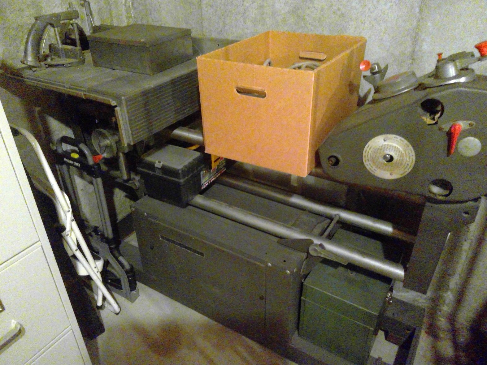

Hi, new member here looking for some advice. I have had my dad's old Mark VII sitting in my basement for nearly 20 years now. I used it a lot when my dad was alive. About 5 years ago I tried to use it, but the motor just hummed and wouldn't turn. I think it even smoked a bit before I shut it off. I took the motor out of the headstock and tried bypassing the switch and it still wouldn't turn even after hand rotating it. I packed it back into the basement and tried my best to forget about it. My dad's been gone about 12 years now, and it's really bugging me that I am not using his machine. I'd like to try and fix it. I could never get rid of it, so it's either repair it and use it, or just let it sit there until I'm gone too.
Should I be looking for a "commonly used" new motor that would work as a direct replacement, or is it worth trying to get the original motor repaired? Not sure which direction to go here.
I don't remember the original three button start/stop/reverse switch ever really working properly. When my dad handed it over to me to use, the switch was stuck in the run position and I would just use an on/off switch at the wall outlet. Maybe that is what burned out the motor over time. I have not had any luck finding this switch, or even a similar replacement switch. I have read posts about rewiring and using multiple switches, but that all sounds pretty complicated. Hoping someone knows of a similar switch, even if it must be mounted differently?

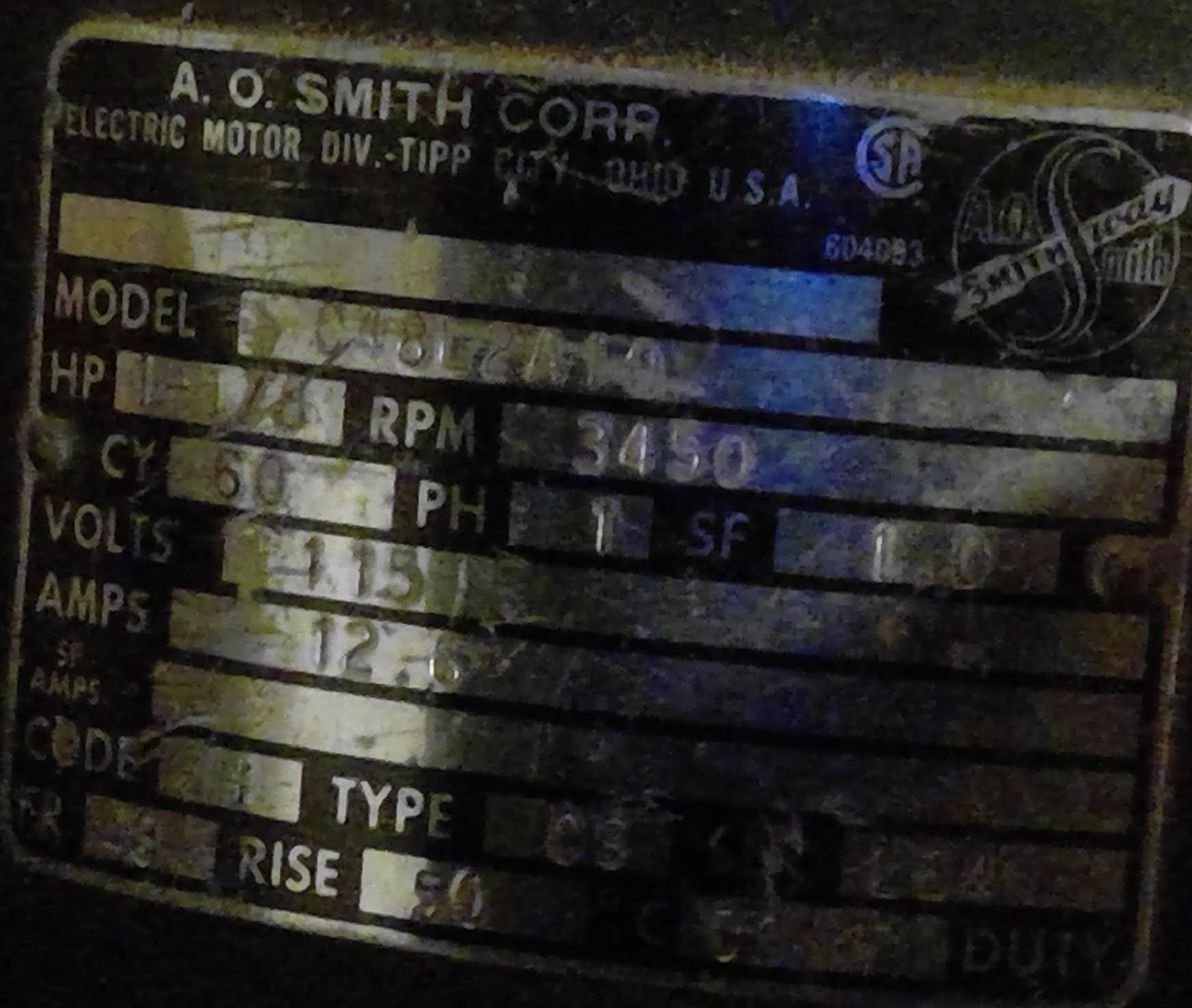

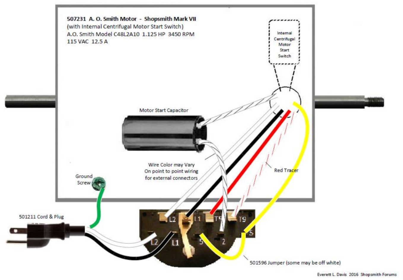

Since different motors were used with the MVII, we need to know which you have. GE? A.O. Smith?, with start relay?. The wire colors differ among the 4 versions. The next step would be to connect the wires independant of the switch for testing purposes to see if the motor WILL run. Smoke is not a good sign if there was very much of it.

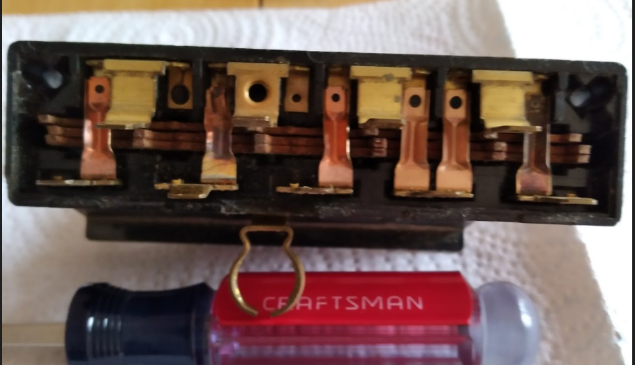

Thanks guys, I really appreciate the help. So I took the switch apart and I learned a lot reading through the info here. Basically, a couple of the contacts in the switch were gone, and the connectors were a little loose in the plastic housing, which probably created some arcing.

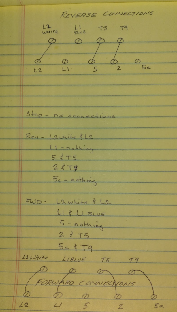

I created new contacts using solder, and glued the contact connectors in tight. I know they wont last, but the idea was to get the switch working good enough to test the motor. The motor would just hum when connecting it direct, as I was bypassing the start capacitor. After reassembly, I continuity tested each connection, and drew it out on paper. If everything worked out I was planning to get a change over switch something like this one: https://www.amazon.com/Taiss-Universal- ... 217&sr=8-1

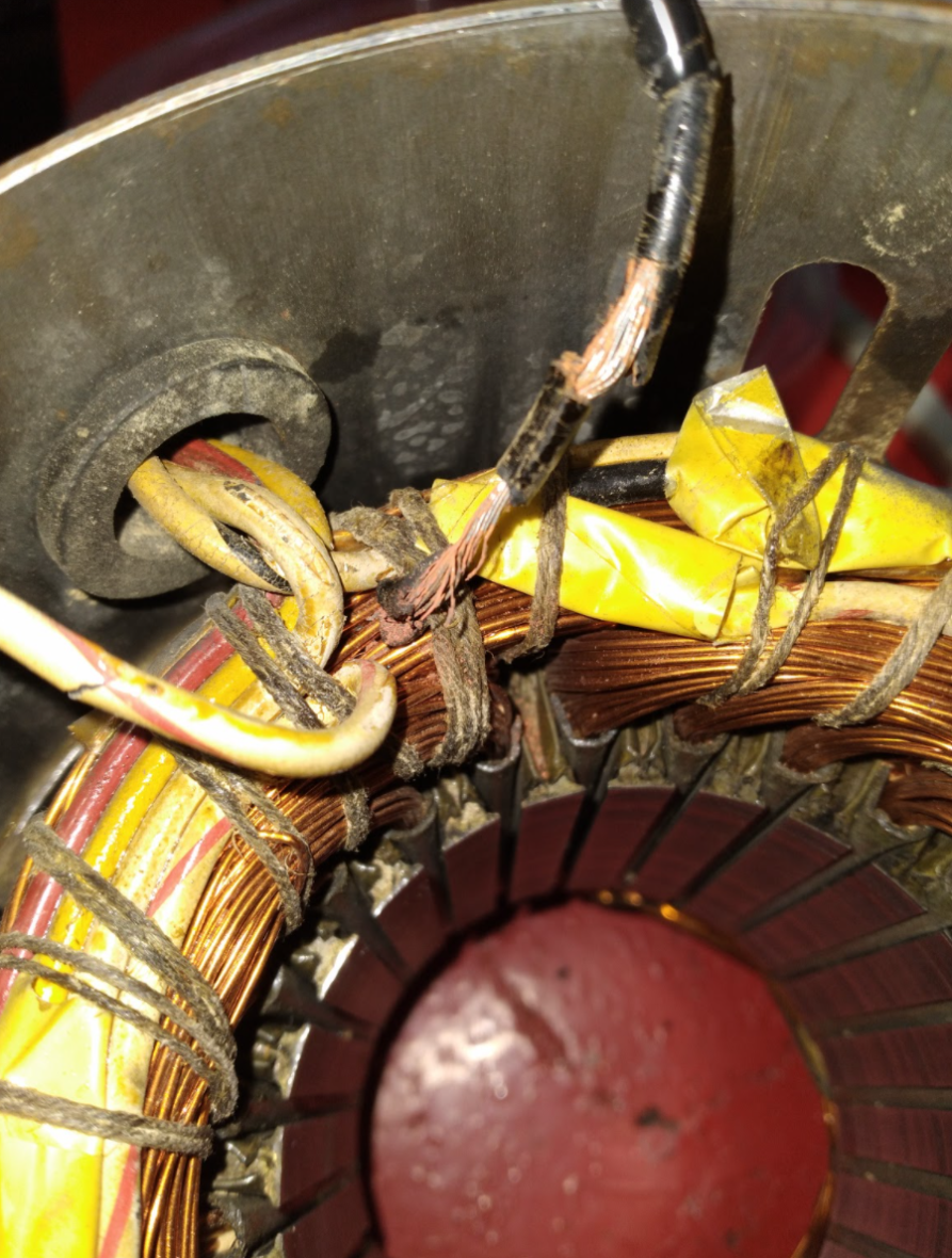

I connected it back up to the motor and realized that the switch had been modified (bypassed) to only operate as a direction switch. The power contacts were not being used, only forward and reverse. This is why I had to use a separate switch for power. Anyway, it worked! So the motor started good, ran quiet, and the capacitor is good. Unfortunately, the wires coming out of the motor are badly decomposed. I wanted to cut them back and replace them, but they just got worse each time I moved them. I now have the motor apart and I started chasing the wires back to where I could possibly solder on new wires, but I am thinking it may be a lost cause.
I have the C48L2A10 A.O. Smith motor. If someone knows of a replacement please let me know, but I am thinking this is likely over my abilities to swap out the bearings and armature, etc. I'm not giving up, but not really sure where to go with it at this point. Maybe take the motor to a repair shop?

Shrink tubing to fix crumbling insulation.(keep track of original colors). Maybe a motor shop can do that for you. They could replace the bearings also.
You have documented the switch action correctly except the missing L1 - L1 reverse connection. BTW 5 and 5a should have a permanent jumper.
I would be interested how you expect the taiss switch to accomplish the switching needed. I see a way to control direction, bui not ALSO power on.off.
I consider the 'fix' linked to to be wishful thinking. May work for a while. Contact cleaner simply will not repair poor tension and corroded contacts.
