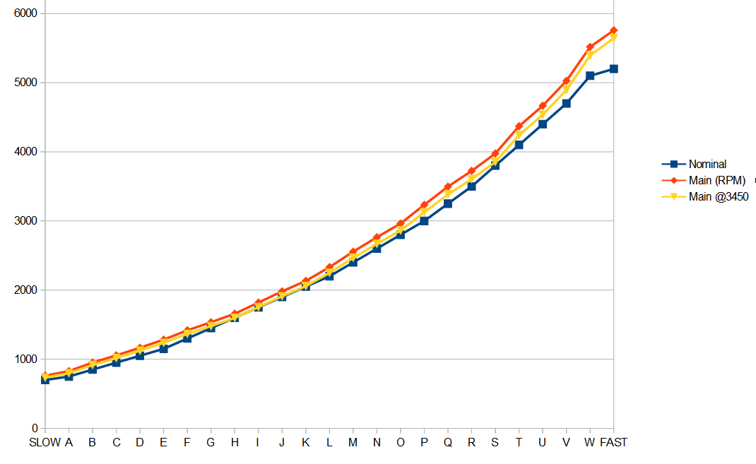

Here is a graph of the speed data I provided earlier:
520 Speed Chart.png (57.1 KiB) Viewed 7376 times
Nominal is from the speed chart, Main (RPM) is measured, Main @3450 is projected speed at the full load speed of the motor. In this case I calibrated the speed dial at K using the tach, as opposed to the method used in high speed adjustment. In hindsight, K was not the best choice for minimizing error to nominal.
- David

DLB wrote: Tue Aug 09, 2022 4:05 pm Here is a graph of the speed data I provided earlier:
- David
Excellent.

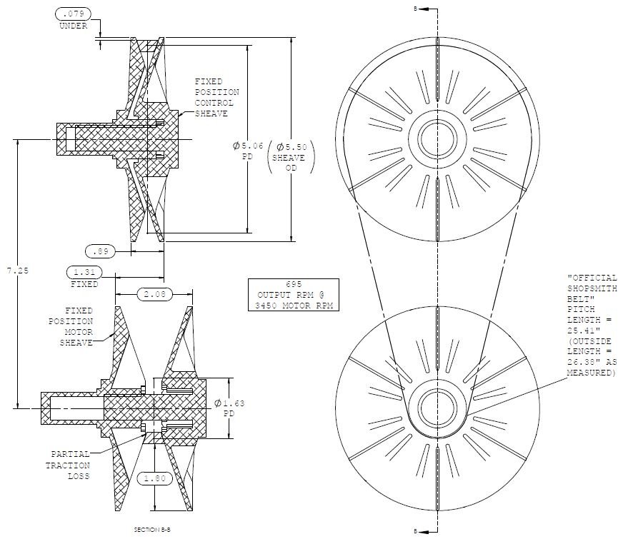

For those of us who are measuring geometry within the headstock, the attached drawing is supplied.
Shows what the drive geometry should look like, and measure, when running around 700 RPM and using the "Official Shopsmith Belt". All the circled dimensions should be measurable from within the case.
Note the "partial traction loss" of the belt. I think this condition is unavoidable if 700 is desired. A built-in Shopsmith design flaw in my opinion.
If 700 cannot be reached, it must be because something is blocking the drive from attaining the geometry shown. I have not measured my drive against this drawing nor have I measured actual speed.
postscript - the section view shown is looking toward the rear side of the headstock - opposite the operator side.

SteveMaryland wrote: Wed Aug 10, 2022 8:17 am For those of us who are measuring geometry within the headstock, the attached drawing is supplied.
Can't see why 700 cannot be attained unless something is blocking the drive from attaining the geometry shown. I have not measured my drive against this drawing nor have I measured actual speed.

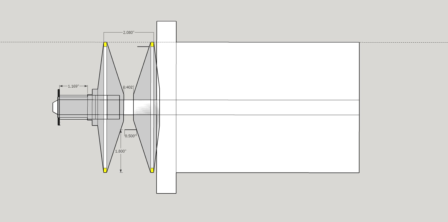

Your drawings depict a lot of the same information that I have but one detail that you are missing is the prohibition imposed by the spring on the motor shaft. Once that spring becomes fully comprised further adjustment is impossible. On your drawing you show the distance separating the two sheaves to be 2.08". I believe that tyhe spring will limit that separation at about 1.71".
As I read your drawings, I also believe that the belt will have been pulled into that area where the belt becomes seized. Further adjustment is impossible and you are now required to retrieve the belt from the crevice.
Inconsequential mislabel: Fixed Position Motor Sheave

If the motor spring will not let that dimension get to 2.08, then that should explain why people cannot get to 700. Mystery solved?
As for the belt dropping inbetween the sheaves on the low speed end, I think that could happen but only for a narrow or worn belt (the belt width shown is a full .59" (15mm officially)), others say their actual width is narrower. And no belt would fall in if that 1.71" limitation is real. At least on the low end of the speed range. Maybe on the high end a jam could still happen (on paper), but a high-speed jam would be very unwelcome. another reason to stay away from the high speed end.
Cutting a few coils off of the motor spring would partially fix the low speed problem but would also reduce the spring force when extended to the point that the highest speeds could not be attained. An improvement? I think most users would rather have a lower min speed even at the cost of lower max speed.
So how can Shopsmith keep claiming 700? Maybe long ago they could get to 700, but subsequent design changes to spring, belt, dial etc. now prevent it.

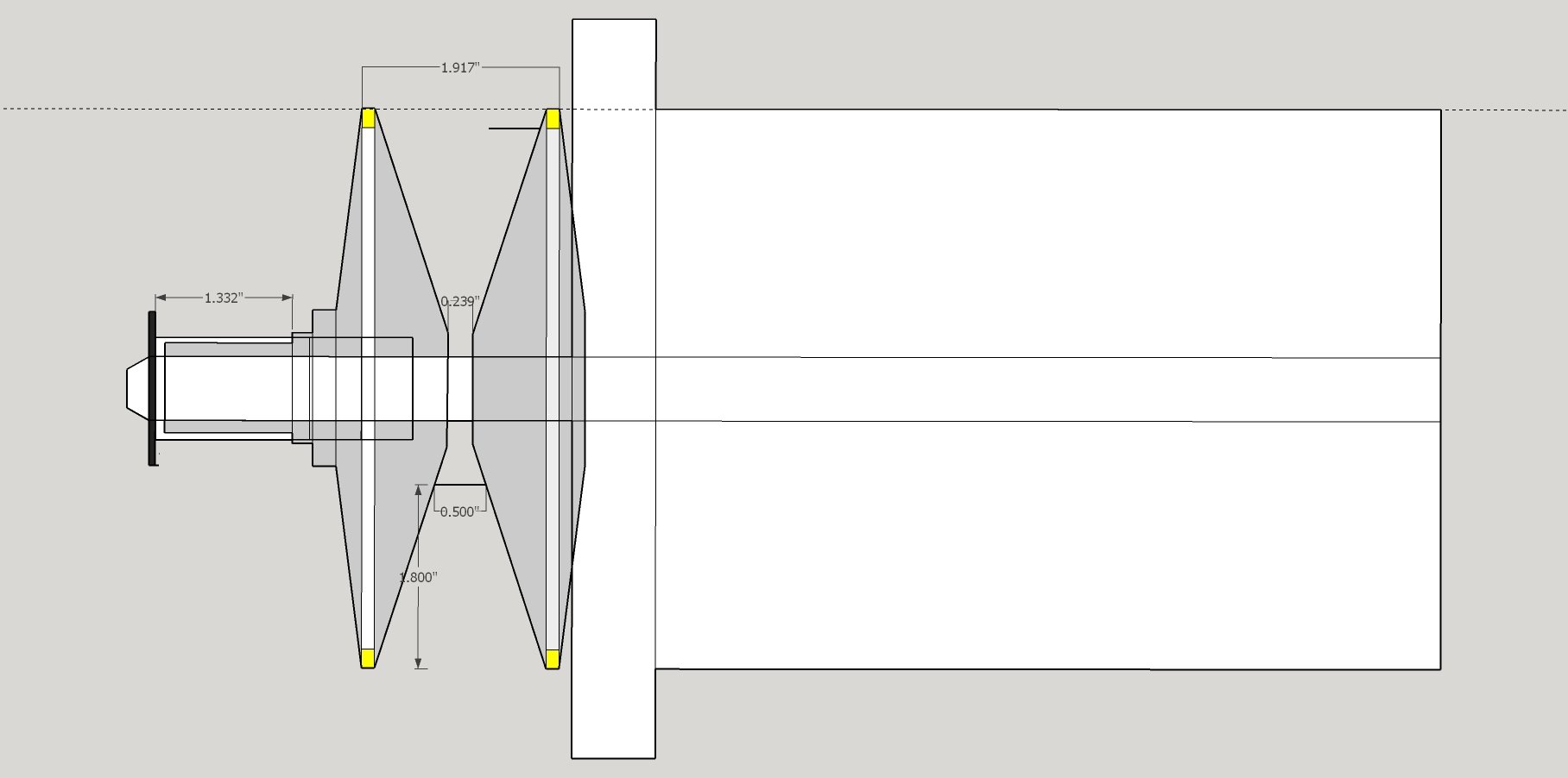

We agree in principal but our drawings differ in detail and thus in the numbers. Notice in view two that the left end of the floating sheave is approaching the washer which would be a hard stop (before your numbers are achieved).
There ares ome hard stops in the design even though they are not discussed in Shopsmith documentation.
Study of Sheave Movement, Fan and Floating View 2.jpg (73.78 KiB) Viewed 7306 times
Study of Sheave Movement, Fan and Floating.jpg (65.59 KiB) Viewed 7306 times

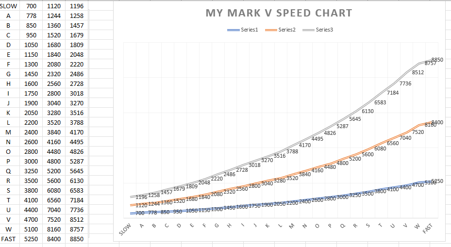

After seeing your chart, Dave, I decided to plot my data. I had not done so even though I feel that there is something amiss with my Mark V.
The High Speed Stop has been set and the Speed Dial properly positioned (I think). The motor in this Mark V runs at 5480 rpm as it came from Shopsmith moons ago. I hardly ever operate on the upper end but when up there the machine does not feel/sound right.
Column "B" is the Main Drive. When the Main Drive is at Motor Speed (3580 rpm) the speed dial is between K and L.
Please ignore the numbers on the left side of the graph. They do not correlate with the graphed data.
My Mark V Spoeed Chart.png (82.28 KiB) Viewed 7204 times
