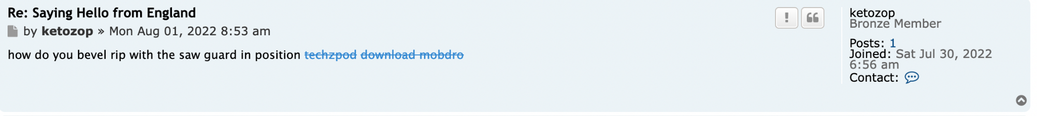

Screen Shot 2022-09-08 at 9.33.19 PM.png (254.38 KiB) Viewed 8523 times
