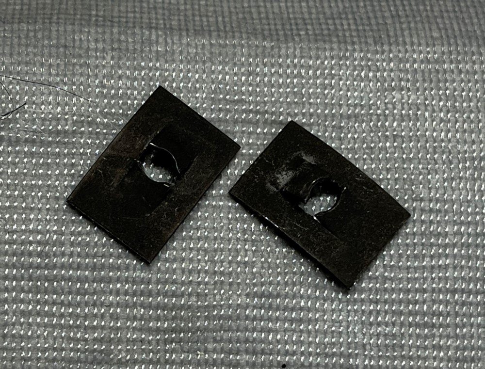

Tinnerman Nuts as they are called in the Owner's Guide for your era Mark 5 are also known as Speed Nuts and are shown in the picture below. They go on the posts of the SS Name Plate inside the headstock along with two rubber washers. They may still be on the SS Name Plate's posts just not pressed up against the Headstock Casting to keep the Name Plate tight. The service techs probably never tried to push the Tinnerman Nuts back on tight after trying to pop the Name Plate off. This way of holding the SS Name Plate on the back of the Headstock was specific to the "A" Headstocks only. The "B" and "C" Headstocks have an access hole behind the Name Plate.
_ .
Do you have the manual for your Mark 5? It will be either the 2nd, 3rd or 4th edition of the Owner's Guide depending on when in 1955 your Mark 5 was made.
Because the "A" Headstocks do not have an access hole behind the Name Plate the motor and motor pan has to be separated from the Headstock casting to reach the back of the Idler Shaft for lubrication. Doing this will give you a good view inside of the Headstock to see if everything looks okay. Inspect for rust or other problems. Besides applying oil to the sheaves of the Idler Shaft you can inspect the back of the Speed Control Assembly and use a dry lubricant on the worm gear. Yours being an early Mark 5 it may not have the oil holes in the movable sheaves of the Idler Shaft Assembly and Motor Pulley Assembly.
