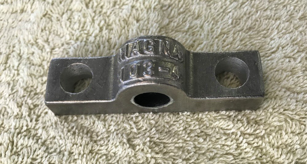

Just a heads up. When reassembling the Main Table Assembly, it is easy to install the Table Bearing part # 103-4 shown in the picture below upside down. The bump with the part number and MAGNA should face the bottom of the table. It seems more natural that the bump would face down away from the bottom of the Table and the part number and name would be visible. I have made this mistake a couple of times and it becomes impossible to align the Main Table to the Spindle.
