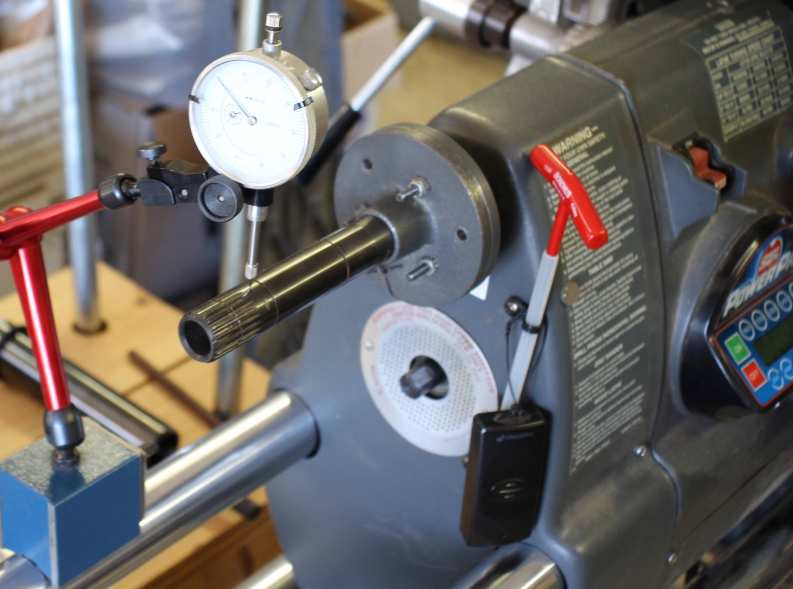

I eventually determined that the runout problem I experienced with the Drive Sleeve was caused by the shaft itself. To confirm I used this setup to measure runout at the approximate center of the bearing location of each of two shafts. (I had a disassembled 'old style' Drive Sleeve in a pile of parts and used it for comparison.)
Setup
Setup
IMG_9213 (2).JPG (199.83 KiB) Viewed 3759 times

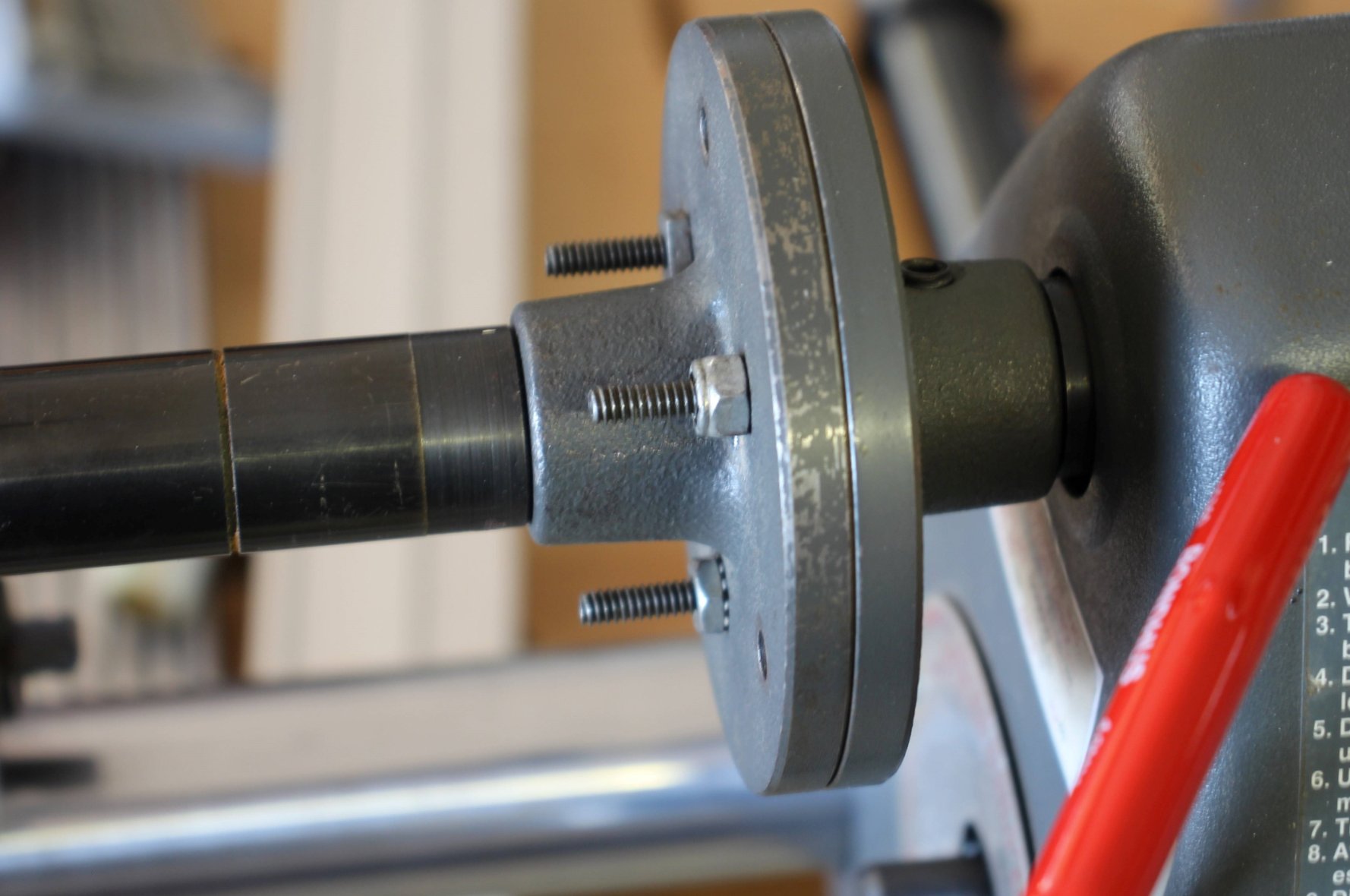

I assembled a shaft adapter from 2 3-3/4" lathe faceplates:
Shaft Adapter
Shaft Adapter
IMG_9211 (2).JPG (180.47 KiB) Viewed 3759 times
This is no kind of lab setup for measuring, there is unknown runout at the PowerPro output shaft and each of the faceplates, plus how accurately they are assembled, contribute runout. But with a known good shaft for reference it is clear that the suspect shaft is bad. My baseline (old-style) shaft measured 0.009" TIR at the inner bearing location and 0.005" at the outer bearing location. The suspect shaft measured 0.053" at the inner and 0.023" at the outer.
I'm a bit disappointed in the quality but glad to have isolated the cause. Also glad I checked the shaft before installing new bearings on it. I'm reasonably certain that the runout led to premature wear on the Drive and Ring, causing the slight rotational slop I noted and the startup noise I have recently noticed when spinning up a saw blade.

The new drive sleeve, measured as similarly as possible to the previous, measured TIR of 0.004" at both bearing locations, a bit better than my old-style 'reference' shaft which measured 5 and 9 thou at the outer and inner bearing locations. The setup was slightly different because the new shaft is fully assembled. Keeping in mind that my setup was not lab quality, this is excellent.
For those measuring by eye, runout (wobble) was very visible on the bad drive sleeve with a small lathe faceplate. With a sanding disc, it was ridiculous. I never noticed it with an SPT coupler.
