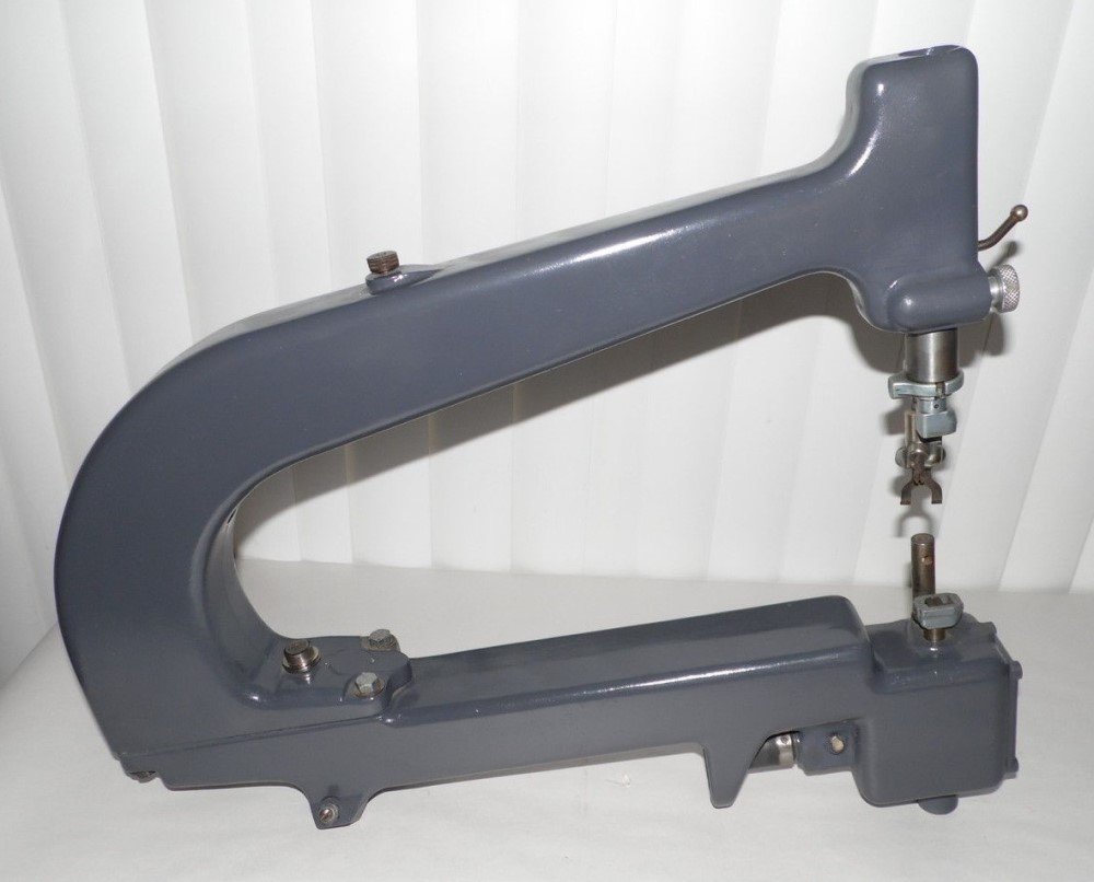

For clarification the later version of the A-34 Jig Saw is shown below. The easy way to tell this later version from the early version is the partial belt cover.

As I said before there is very little difference between the two versions which are the Lower Frame Assembly, Drive Housing Cover and the number of screws to hold the cover on. I have both versions but prefer the later version for use. This is not just because it is a bit safer having the partial belt cover but is actually the difference between the construction of the Lower Frame Assembly. The Lower Frame Assembly in the early version is open throughout and saw dust can get into the gear box. I have found saw dust in the gear box of all 3 of the early version A-34 Jig Saw I have restored. The later version corrected this by closing the gear box off from the rest of the frame.
The biggest difference between the A-34 Jig Saw and the Magna/Shopsmith Model 610 Jig Saw made after the introduction of the Mark 5 is the A-34 uses the Model 10E or 10ER table while the Model 610 Jig Saw is a more complete unit only needing a power source.

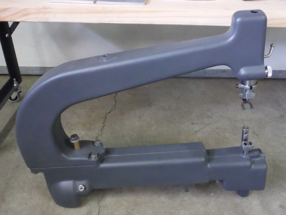

The Model 610 Jig Saw is shown below for comparison. This Jig Saw has either the "Greenie", "Goldie" or gray paint scheme depending on when it was made. A "Greenie" painted one I restored is shown.
610 - 76158.jpg (83.59 KiB) Viewed 15911 times

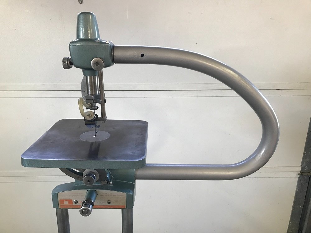

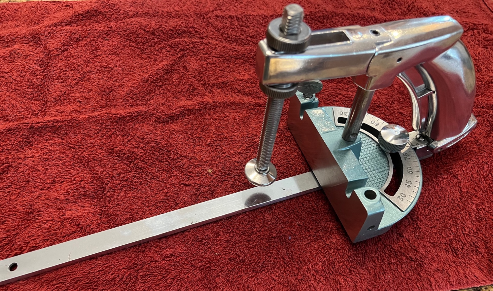

More 10-E Accessories
I finally got back to painting in the garage this fall, so got a few more accessories completed for the 10-E I showed here back in July. The original owner of the machine apparently really liked to add the latest gadgets when they were developed - lucky for me…!
(“before” shot)
John Dalton

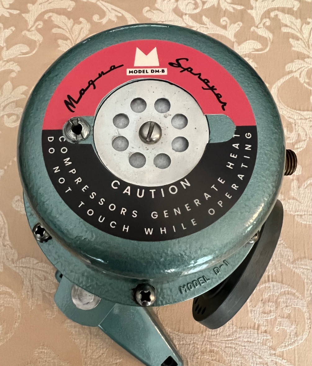

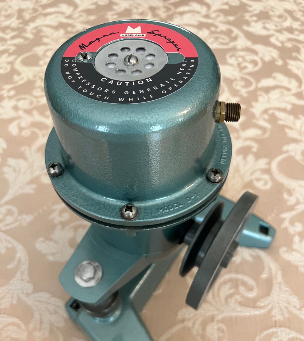

chapmanruss wrote: Sun Mar 27, 2022 1:30 pm Something I have been looking at is recreating the label for the top of the compressor. Mine are a bit beat up and it will be better to remove the old label and replace it with a recreation to finish the restoration.
Russ - I recently topped off my restored Magna Sprayer compressor with a new recreation label. Pretty happy with the results. I have extra copies of this one if you’re interested.
John Dalton

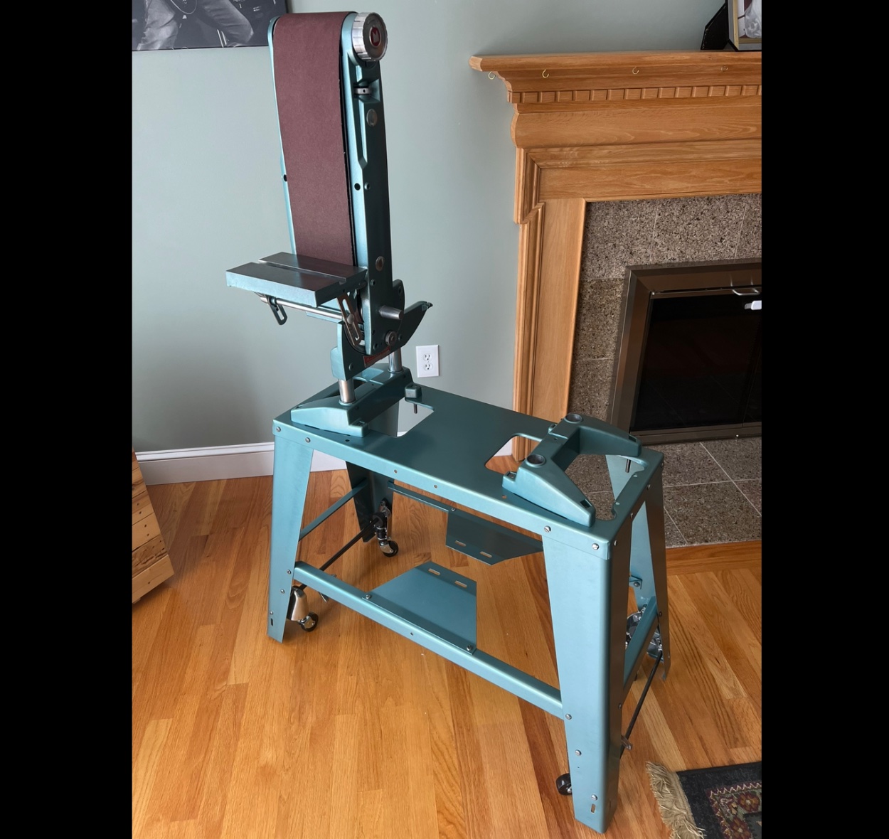

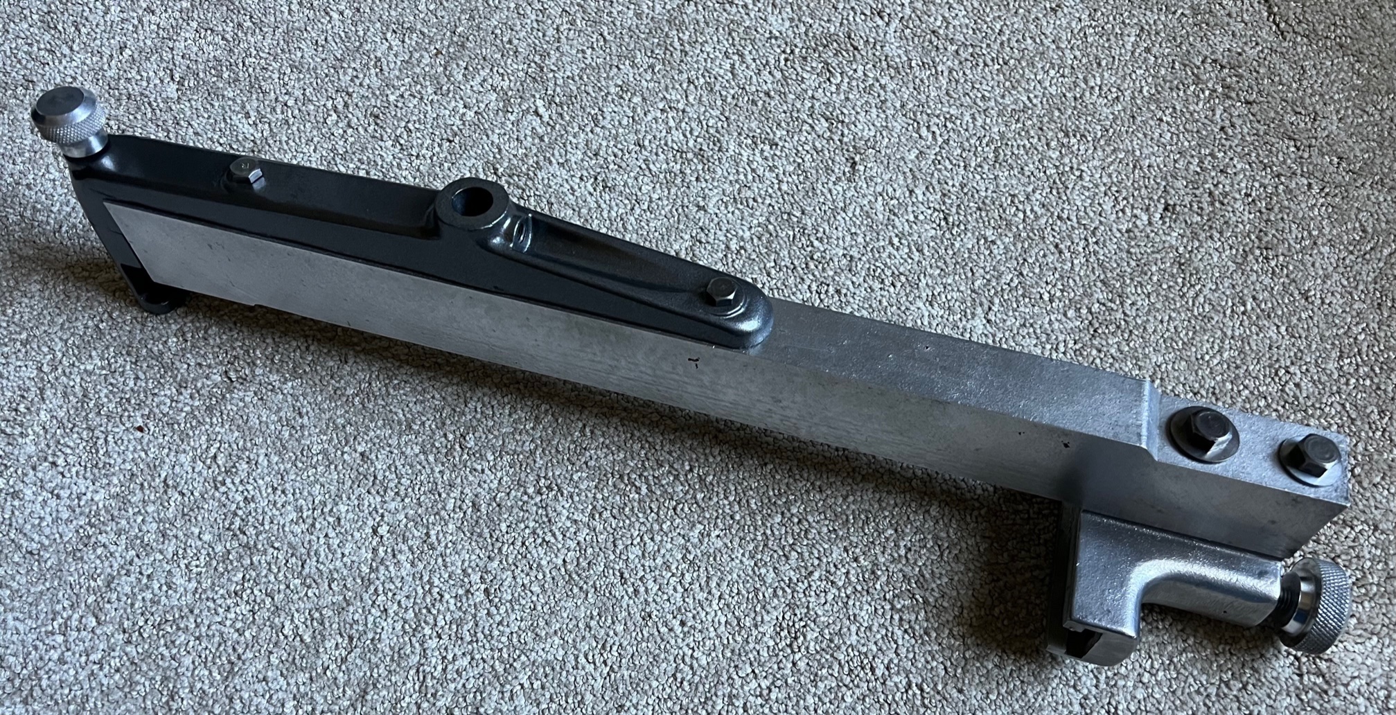

Magna-Line Dual SPT Stand
I’ve finally had some time to work l on this Magna-Line stand I picked up last year. Still have a long way to go, but it’s starting to come together…
The original Powr-Kraft branded motor that came with it still needs some work, so still missing from the last picture.
John Dalton

Post by Mike »
looks like it should be on display in a Shopsmith museum. Very nice
