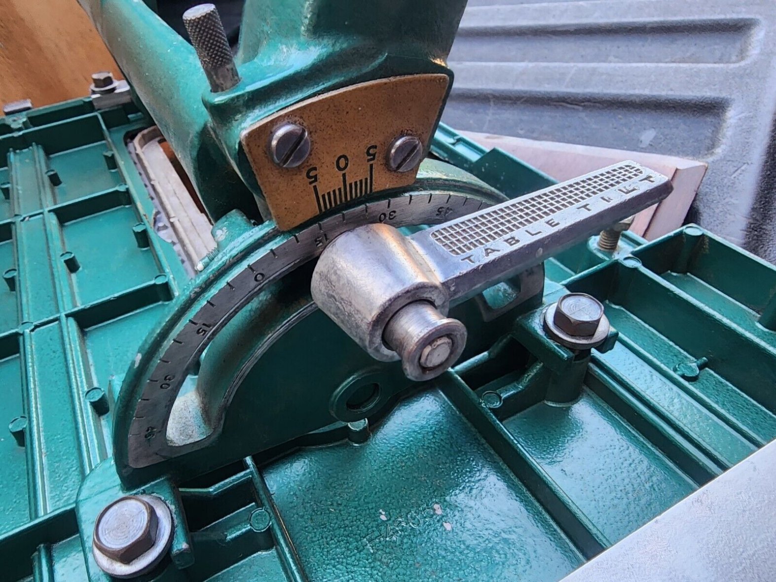

Mark V / 500 table with second slot question
Since this older thread talks about the second slot, I am asking my questions here instead of creating a new thread.
I am considering getting a Mark V / 500 table with the second slot for a couple of reasons. First, for the ability to rip larger widths without trying to bridge the main table/auxiliary table gap or having to add spacers to the fence while the fence is entirely on the aux. table, and second, for the ability to change tables out when one is set to a specific tilt and I want to use a different angle without having to risk losing my setting. The table has the bolt on fence rail as opposed to cast-in-place. The table tilt lock looks slightly different than my 1980 Mark V ... is it a plunger in the middle?
The table that I am considering appears to be in reasonable shape, but I am also wondering about the green paint color. Does this look like an original color for a greenie at some point in it's history? Were the undersides of the tables painted at some point? The fence and miter gauge offered by same seller are same color green.
