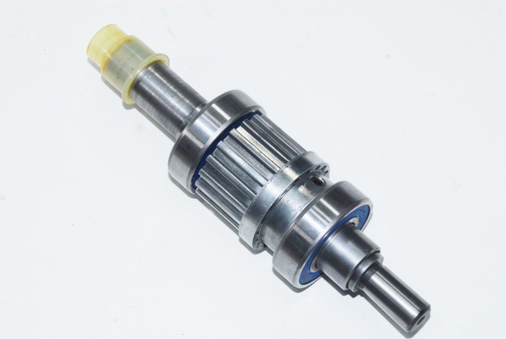

I chose to answer here instead of the other threads. Your Grandpa's Mark 5 was likely made in March 1954, the same month as the Mark 5 was introduced. Serial Number 262398 is earlier than the first known production date number of April 1954 starting at S/N 263051. As one of the early Mark 5's it had some of the issues that were later resolved. It has an "A" Headstock so no rear access hole under the Logo Plate for maintenance. The only thing holding the Idler Shaft Assembly in place in the Headstock casting was the clamping pressure of the bolt and nut. Later Magna added the Bearing Retainers to keep the Idler Shaft Bearing from moving in or out of the casting. The early Mark 5's had a non-clutched Drive Sleeve Assembly that tended to break Gilmer belts when a jam occurred. The clutched Drive Sleeve Assembly came out about the time of the second Owner's Guide dated July 1954 and is shown as assembly number 202100 in the parts list. The slippage allowed by the clutched Drive Sleeve Assembly helped save Gilmer belts when a jam occurred. The pictures below are first of the non-clutched Drive Sleeve Assembly followed by the clutched Drive Sleeve Assembly.

Notice the non-clutched Drive Sleeve Assembly has the set screw in the gear teeth. The clutched Drive Sleeve Assembly has the set screw in the collar next to the clutch plates.

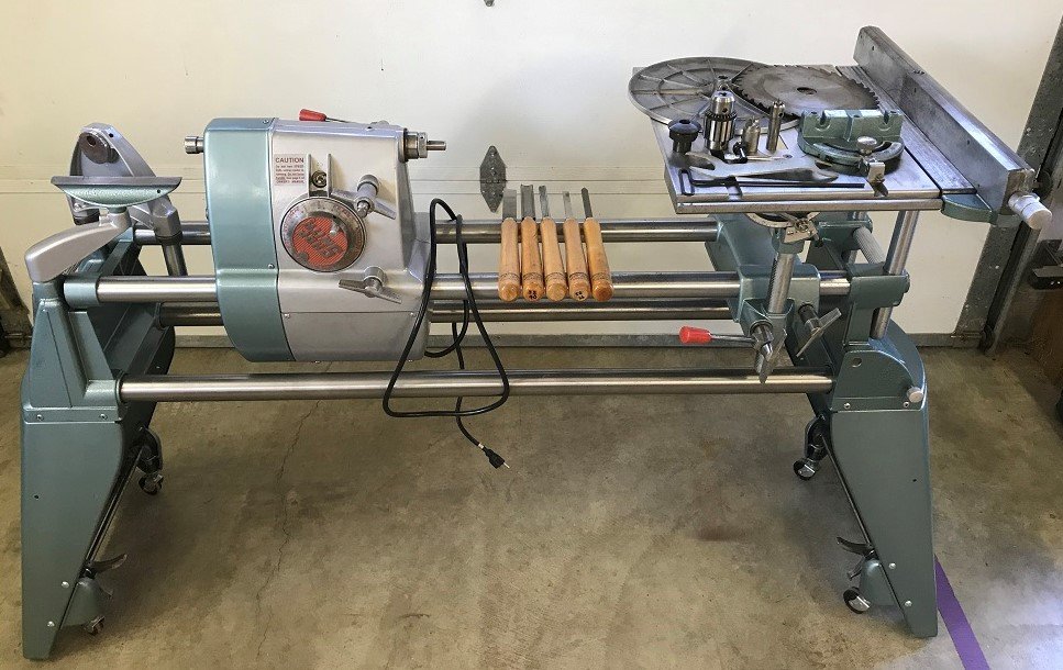

The original colors for the Mark 5 were green and silver in a hammered finish although over time the silver could look more like a light gray. Most parts were green while the Headstock casting, Motor Pan, Tailstock and the Lathe Tool Rest Arm were silver. A restored Greenie is shown below. It is a later one than your grandfather's with the "B" Headstock.
_
The restored one above has a new grounded power cord. After 68 years your grandfather's Mark 5 could use a new power cord if it hasn't been previously replaced. Maintenance including lubrication would be needed items if it hasn't been used for some time or hasn't been done recently.
Since it has the non-clutched Drive Sleeve Assembly you may want to consider upgrading it to the Poly V Drive which uses a different belt and can actually slip on the pulleys in case of a jam. This could be a desired upgrade if you plan on using it much. It would require a Poly V Drive Sleeve Assembly, newer Quill and the correct parts for the Idler Shaft Assembly. Simply replacing the non-clutched Drive Sleeve Assembly with a clutched Drive Sleeve Assembly may not be a good solution. Since these were made only until the change to the Poly V Drive in 1961 their condition is questionable. Too little friction in the clutch and you will have slippage and too much friction in the clutch and it would be like having a non-clutched Drive Sleeve Assembly. The clutched Drive Sleeve Assembly is not easy to work on.
