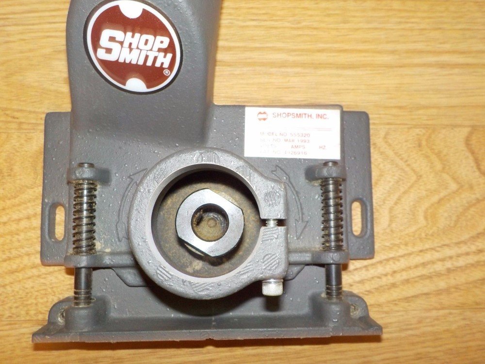

There have been two versions of the Biscuit Jointer that I know of. The early one is shown below.
_ .
The current version is shown below.
_ .

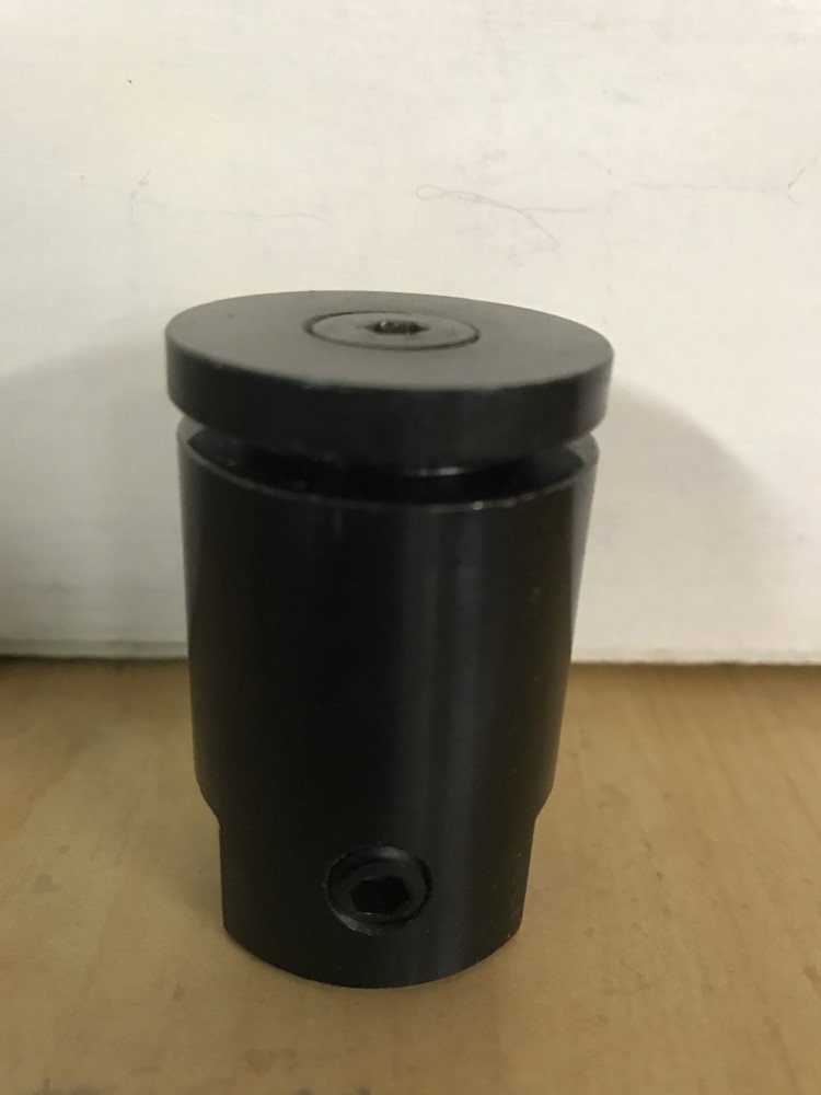

The only real difference between the two is the tabs on the sides added to the current version. The arbor for the Biscuit Jointer is specific to that tool. That Arbor is shown below.
_
_ .
_ .
_
