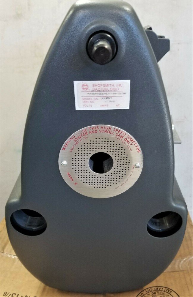

To better help in locating the Date Code Sticker the pictures below show what I was describing in my previous post. A they say a picture is worth a thousand words.
The picture below shows the most common placement of the sticker when it was between the Idler Shaft Vent Plate and the upper Drive Shaft. Some stickers were below the Vent Plate.

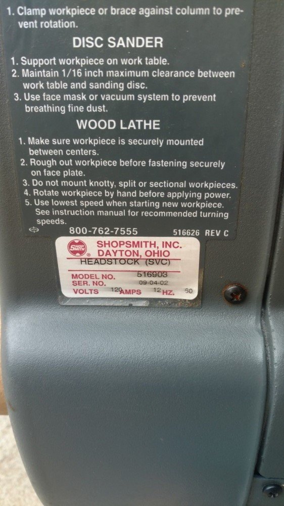

Below is the later location for the Date Code Sticker at the bottom of the Information/Warning label on the side of the Belt Cover.
_ .
If the Information/Warning Sticker has the extra "tab" space at the bottom the sticker, like the one shown above, the Date Code Sticker would have been there.
It is interesting that the Date Code Sticker is missing and has me wondering about the tool's history. It is not something that would easily fall off.

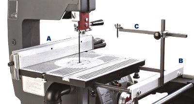

In my previous post I mentioned you will need to get the Bandsaw Fence Notched Bar part number 516687 along with the Aluminum Bandsaw Table. It does not come with the table itself but would come with the Fence Kit. That bar looks the same as the Extension Table bar for the Bandsaw except it has a notch for the Miter to pass over which aligns with the Miter slot in the Aluminum Table. If I remember correctly there were early Fences for the Aluminum Table that did not use a Fence Bar. If your Bandsaw Fence looks like the one pictured below you would need the Fence Bar to use the Fence on your Bandsaw.

If this label must be a "paper sticker", I would prefer it be on the end of the headstock. What I would really prefer is an aluminum plate with the data stamped in and attached "permanently" with rivets. Sorta like someone thought it might last for decade or two!
After thought. Since screws and washers now cost $3 each maybe I can't afford am aluminum ID plate.

There's some unused space on the vent plate.dusty wrote: Sun Nov 06, 2022 1:41 pm If this label must be a "paper sticker", I would prefer it be on the end of the headstock. What I would really prefer is an aluminum plate with the data stamped in and attached "permanently" with rivets. Sorta like someone thought it might last for decade or two!

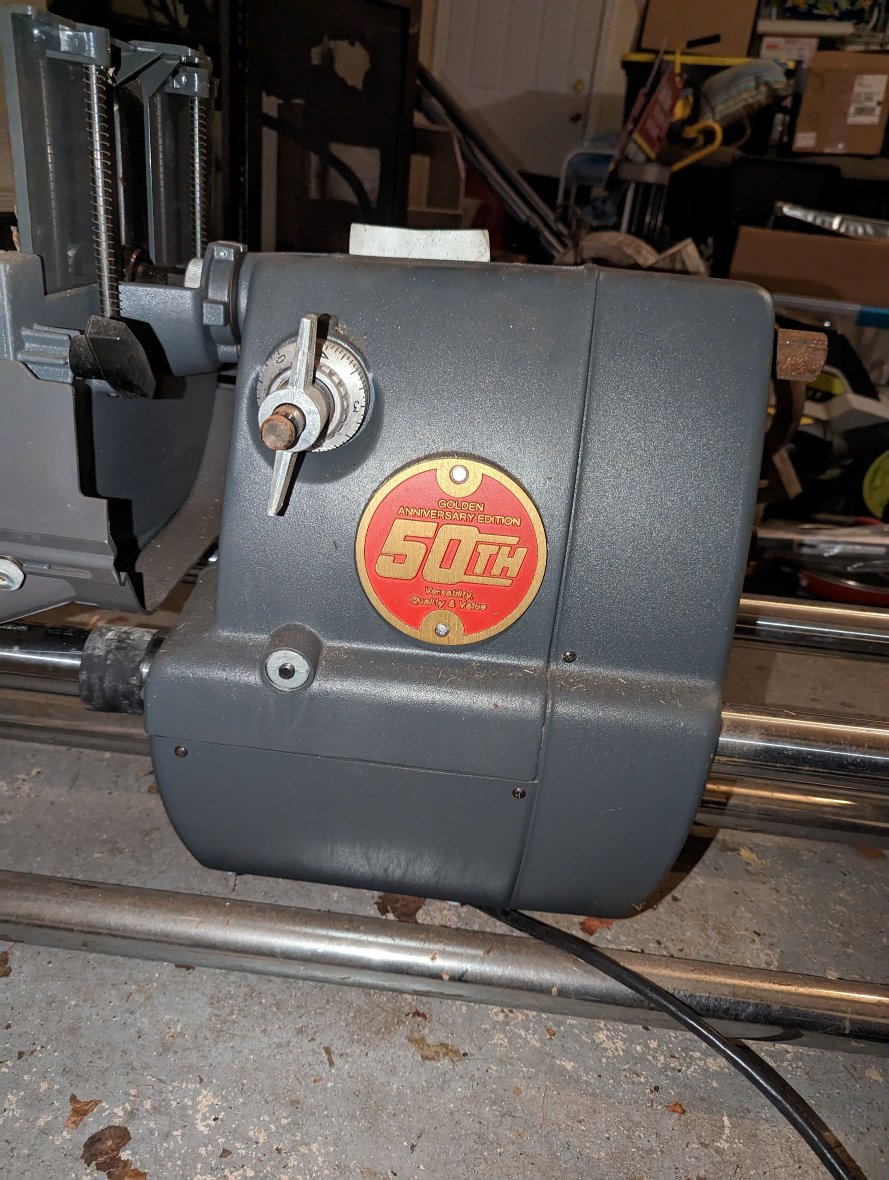

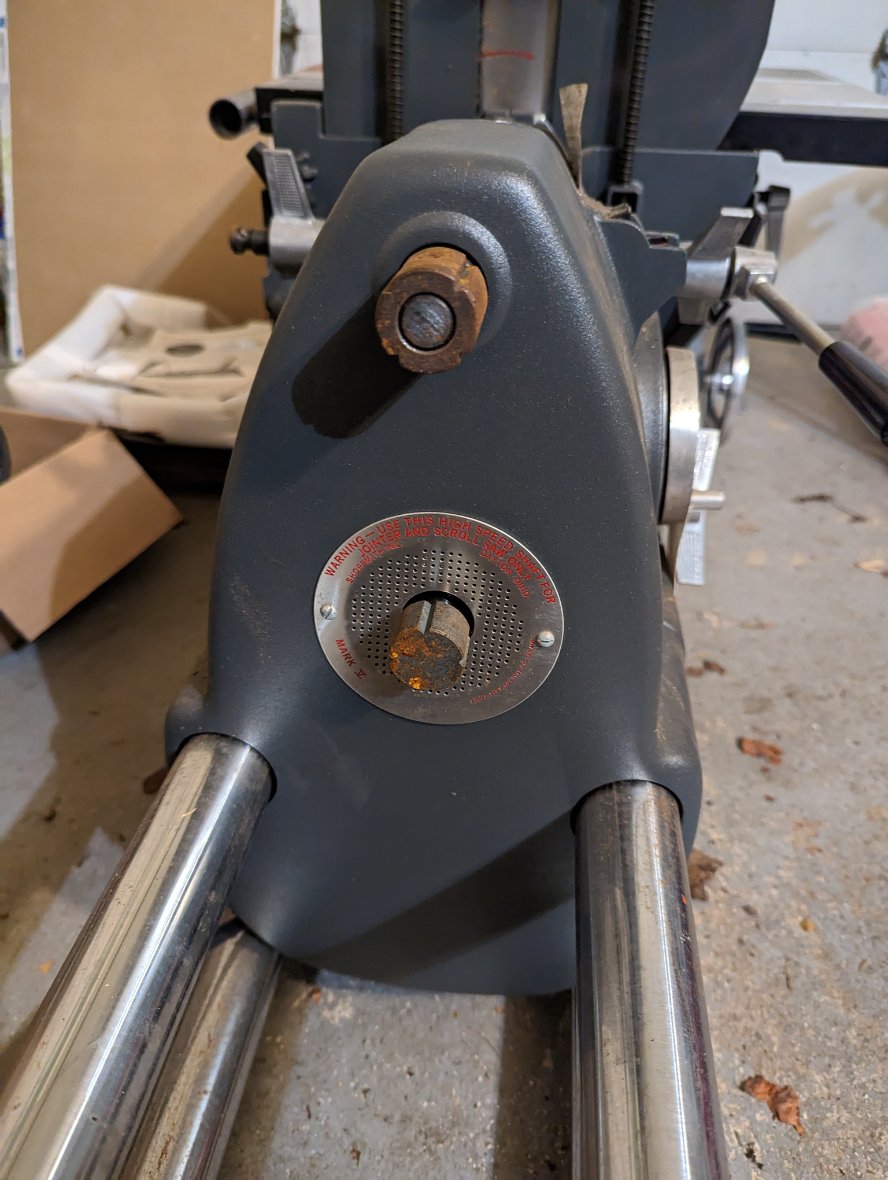

Looks like the date sticker is definitely gone. I'm attaching some photos of the headstock (sorry for the poor quality, it's dark in my garage right now), and no signs of a sticker. Wherever this thing was stored, it definitely had some moisture issues. There's some light surface rust here and there on the Shopsmith itself, and some of the accessory parts are pretty well rusted. The jointer in particular is quite bad, and the mortise and tenon boxes are particularly water damaged and the parts very rusty. I have parts of the jointer in a bath of Evaporust right now, and it's working wonders. Anyway, I assume the machine lived in a fairly damp (and maybe hot?) environment and the sticker just fell off. You can see the other sticker on the headstock has partially come loose.
I'm fairly certain it actually is NOS, though. You can see the caution tag on the speed control, and there was a paper tag on the end of the power chord (which I pulled off so we could plug it in and be sure it worked before I bought it). The legs are in perfect shape with the bag of hardware zip tied to them, and there are no witness marks anywhere of it having been assembled. Many of the accessories are in their original boxes, and all of the hardware is in stapled plastic bags. If it isn't NOS, somebody worked really hard to make it look like it.
I suspect I probably have the band saw fence notched bar. I have an unopened box that contains the bandsaw fence, so I will assume it's in there. (Probably going to leave the box unopened until the table gets here--harder to loose pieces that way). I appreciate the heads up on that, though.
