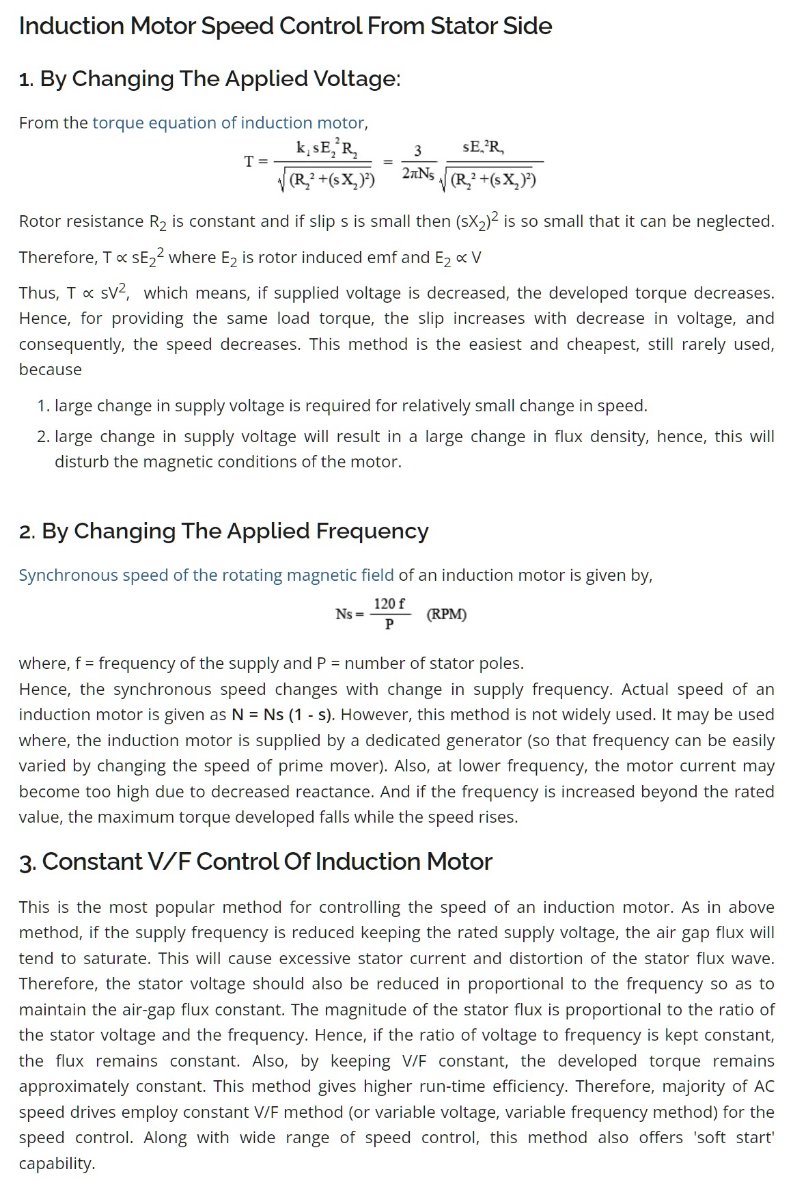

I hadn't heard of that type of speed control being used for single phase motors. So far I've only had a quick look at that link but it sounds like an expensive approach even if feasible. I also recall that controlling AC frequency for variable speed is bad for the motor, but I don't recall why. However, those motors are optimized to work with the limited conditions of common line frequency and voltage. I want to go over that article in detail but it is from 2004 and the links it has to details on the 3 options it discusses aren't working.

Single Phase Induction Motor Speed control is possible, but not for every type of motor. I believe it can be done on PSC, shaded pole and AC synchronous induction motors, but won't work for example on motors with a centrifugal starting switch, capacitor start, etc., etc. Even though it is possible, I have never seen these used in any applications anywhere so if anyone has I would appreciate them posting about it showing a real world example. Some of the key reasons are detailed below. IF you just change the supply voltage then a large change in supply voltage is needed to get a relatively small change in speed, but doing so will greatly alter the magnetic field inside the motor. Changing the frequency has torque implications and other issues. In my opinion, this is more of an academic exercise, i.e. sure it can be done but you likely won't get the speed control range and/or torque that you want out of it and it won't be cheap to generate the V & F control circuitry. Likely cheaper to buy a suitable 3 phase induction motor and a corresponding VFD by comparison. Hence, StriaTech reinvented the switched reluctance motor and sold it to Shopsmith to put in the PowerPro.
