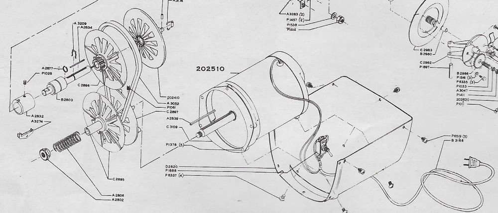

The Drawings in the Owner's Guide for the first three editions were not very detailed for the motor itself as shown below.
_
Motor p26 8-55 .jpg (105.66 KiB) Viewed 585 times
This is from the third edition but the motor is drawn the same. This also shows the Bearing Retainers (far left under the eccentric) mentioned in the other thread. In the next edition (4th) of the Owner's Guide the motor drawing changed to having the capacitor mounted on the rear. The Spring Cup and Retaining Ring replaced the special nut on the motor shaft.

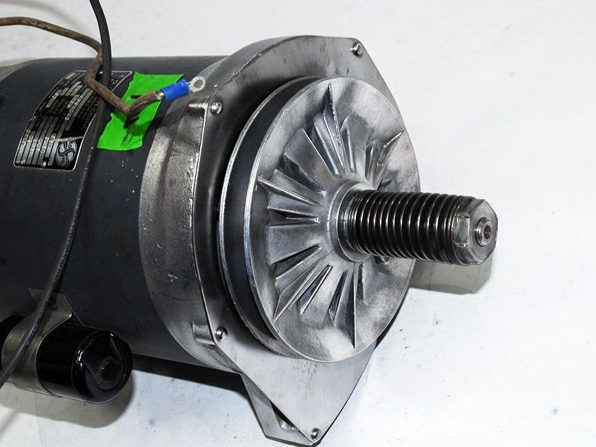

Just so you can see it below is a picture of the shaft end of an A. O. Smith 3/4 HP Motor.
