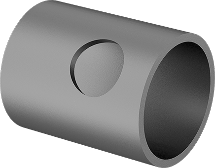

I recently needed to adapt a SS chuck (Jacobs 3326) to a 1/2” cordless drill, so that I could chuck up a slightly larger workpiece in the cordless drill. A sleeve bushing from McMaster, plus a 1/2” dowel pin, worked nicely for that. The clearance hole for the set screw was exactly where it needed to be.
https://www.mcmaster.com/6420K17/

Perfect. Thanks! My local Ace hardware store has a whole aisle of bushings, bearings and oddball fasteners. I'll see what I can find there, otherwise McMaster will be my next step.
