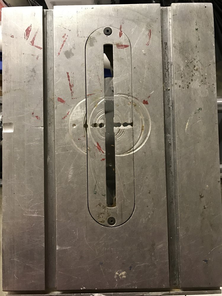

Although I do not have any Mark 5 or Mark V 500 Shopsmith's at this time I do have two of the Main Tables. One is from a 1983 Mark V I restored that had damage and the other is an 1980's or later Main Table. The 1983 Main Table is flat, but the other Main Table is slightly bowed down in the center toward the insert opening as you described. What I find interesting looking at the two Main Table I have is the 1983 obviously was used in drill press mode as evidenced by the damage (see picture below) but is still flat.
