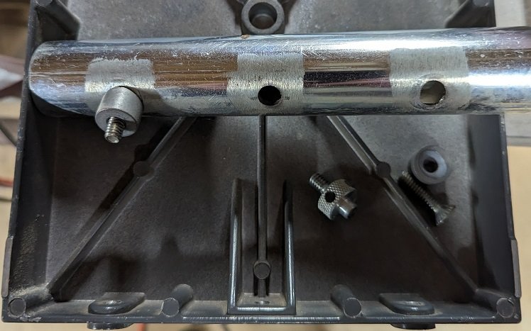

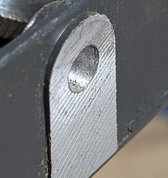

Ok, there's no interface material. It's just the casting that's been ground and polished. That process leaves a burr that extends out to the sides enough to stick a finger nail under and it will even bend in some places. The intent was clearly to provide a clean flat surface for spacers to butt against on the flat side but as I mentioned those spacers may not be regularly shaped.
Here's an old gray table disassembled. The casting is tapped for the rail mounting screws but a lock nut could still be added on the inside of the table. The rail is different from the others, it has a shiny exterior coating and something corrosion resistant inside.

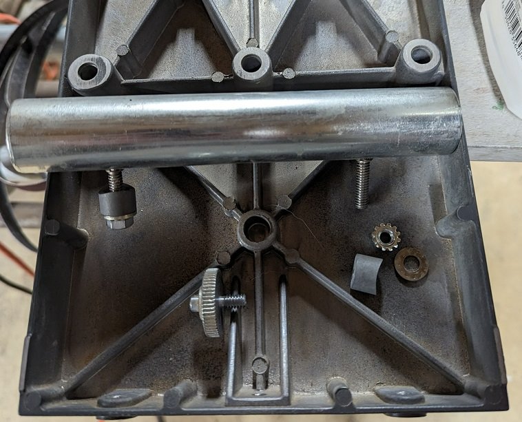

Here is a newer gray table disassembled. The knurled knob is larger and the bolts are welded(?) to the rail which is then attached with a lock nut inside. The rail has a dull finish but inside and out.
This pic shows the ground mounting surface on an old gray table. It seems to be the same for all versions except the oldest ones have threaded holes. You can see a little bit of the burr on this one.

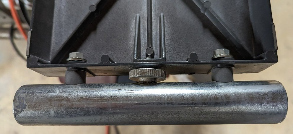

This is a newer black table. It has had minimal use but you can see that the spacer were mounted off center on that ground portion of the casting. I have to take it apart but I assume the holes were not drilled in the right place. The rails on the black table have a shiny coating on the exterior, but the interior appears to corrode easily. The rail is also skewed away from the table side, the rail is further away from the table on the left side. You can also see the concave side of the spacer does not mate well with the rail. Different tubing was used for the rails on each of the 3 types of table so it's not surprising to see dimensional differences in them.

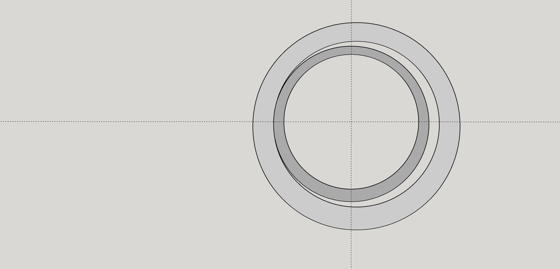

I think Scott over emphasized the sag problem, to me the biggest problem was pushing the thin end of a screw stud into a circular tube. If you hit the tube head ( exact axis of curve) on you had one height, if you hit the tube below arc of the tube it lifted the tube and you had another height. If you hit the tube on top of the arc you pushed the tube down and you had a third height. This of course was compounded because you had four places to cock the tube on the main table and two places to do so on the aux tables. This problem was resolved by the way they connected the fence tubes and connector tubes on the 520. Push up and into a extrude curve that fit the connector tube. To me the 510 was a cheap and dirty way to add versatility to the 500. The 520 to me was an engineered method that showed Shopsmith once again cared about their machines performance.
Also yes overall quality of Shopsmith is coming down. My 500 table was built to perfection with the table being dead nuts flat. I have not seen a 510 or 520 table that equals that. I have personally check every 510 or 520 table I can and never found one that I would call flat. I went through all the tables Bill Mayo at his place and Doctor Dave (at his school) had plus every demo table I saw and when they had the store almost every table that went through the store.
- Ed in Tampa
- Posts: 5834
Re: 510 versus 520
Dusty in your picture above ( which is great! Thank you) if the tightening screw comes in against the connector tube above the center line it will push the tube down, it has too! Likewise if it hits the connector tube below the center line it will push the tube up. This is the problem. When it comes up from the bottom it could push the table out but the table itself will stop it but there is nothing to stop it from moving the up and down axis. In there lies the problem. You have 6 screws at least trying to move the tube up down on the 510.dusty wrote: ↑Wed Jan 11, 2023 5:36 pm Pressing the Table Tube(s) upward(as om the 520) or or outward (as on the 510) is IMO the same with the same result. On the 510 the Table Tube is pressed against the inside of the tubular Table Rail. On the 520 the Table Tube is pressed upward against the top of the Table Rail into a mating curved extrusion. I feel that both ways are equally effective in accomplishing the intended result (positioning the Table Tube properly in the rail).

Another great drawing showing relationship of the sizes of the Fence Rail Tube and the Connector Tube. That 1/16 of an inch, as I measured it, really looks like a lot of space.
