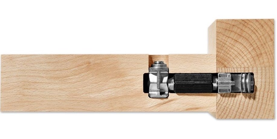

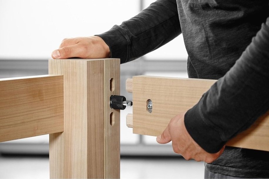

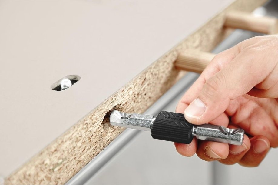

algale wrote: Tue Jan 10, 2023 6:24 pm Hey RFGuy, I don't begrudge you your Festool Domino tool! I'd love to have one --just don't want to pay for one!
That knockdown hardware does indeed look pretty cool! Any reason you can think of why one who didn't own the Festool Domino couldn't buy the knockdown hardware from Festool and then cut the mortises the old fashioned way I describe with an appropriate-sized drill bit?
Alan,
Thanks. I am proud to own a Festool Domino and a few other tools from them, but I am not trying to brag about them here. So, I am cautious what I post sometimes. For me, they are an investment, just like all of my SS equipment, and I cried with every purchase due to the cost. I have a small shop (~200 sq. ft.) and only one Mark V, so when I decided to get on the Festool platform I saw it as more of an ability to offload some of my workload from my Mark V to these high quality hand power tools to minimize changeovers. In other words, for me, my SS and Festool tools are complementary. Being in such a small shop allows me to keep my Mark V dedicated to the main tasks I use it for (TS, jointing, planing, turning). I know others might argue that I could put more than one Mark V in this small space, but it is hard to describe, but the usable space is actually much less than 200 sq. ft. due to unavailable wall space and doors. I have a large Craftsman (pre-bankruptcy) rolling tool cabinet with the bulk of my hand tools and some SS accessories in it, but I also have an 8' Gladiator workbench on one wall that is my electronics workstation. So, wall space is a premium. Anyway, getting off topic here, but my point is that by buying into the Festool system I have increased my capability and efficiency in my shop without adding a ton more stuff into the space or eating up valuable floor space.
Just as Shopsmith is a system and you get synergies by adding more SS tools/accessories because they work well together, Festool is one as well. That is what I was trying to highlight about the Festool Domino. I am no expert on Festool, but the more I get into it, the more I can see the system benefits. So, the Domino connectors are the best KD fittings I have seen anywhere. Just like SOSS hinges, maybe there is an ultra-premium KD fitting out there in another brand that I am not aware of. In my limited knowledge before Festool, I always thought of KD fittings as those cheap ones like you can get at the HW store (or in IKEA furniture) and I have used them once or twice in the past. They work okay, but a desk or table put together with them tends to be rickety in my experience. I have also made my own hardware using brass threaded inserts and bolts, but these can be quite time consuming to layout, install & not strip out. In my opinion, the only thing that comes close to the Festool Domino Connectors in quality is the Lamello Zeta biscuit KD fittings that I have seen from a couple of YT woodworkers that I follow. For sure you could just buy the connectors themselves and install them without a Festool Domino. However, like all KD fittings they require a precise placement, size and depth. Otherwise they either won't fit or tighten enough to be a strong joint. I am sure you could create a jig to do it, but it likely would take a few iterations to get the placement just right, but definitely doable. This is why I spent all of the above space going on and on ( :D ) about Festool as being a "system". It is just easier and faster to do it "in the system" than outside of it. I have seen some very large furniture pieces done with the Festool Domino Connectors and they appear to be very sturdy. You can even use them in beds and I have seen many online woodworkers do this. IF they can take the stress and loads of a bed then they must be strong IMHO. Of course, the larger ones require a different Domino. I have the Festool Domino df500 which will cut 4mm, 5mm, 6mm, 8mm and 10mm thick mortises, but the Festool Domino df700 can cut 8mm, 10mm, 12mm and 14mm thick mortises. The df700 can also cut the same df500 sizes if you buy a cutter extension from Seneca Woodworking, but the size and heft of the df700 makes it rather impractical for working on smaller projects. Some glamor shots below to show some of the different applications and types of Domino Connectors. I can't wait to get some of these to try out... :)
P.S. Last pic below shows the mammoth Festool Domino df700. It is a beast of hand power tool!!!
