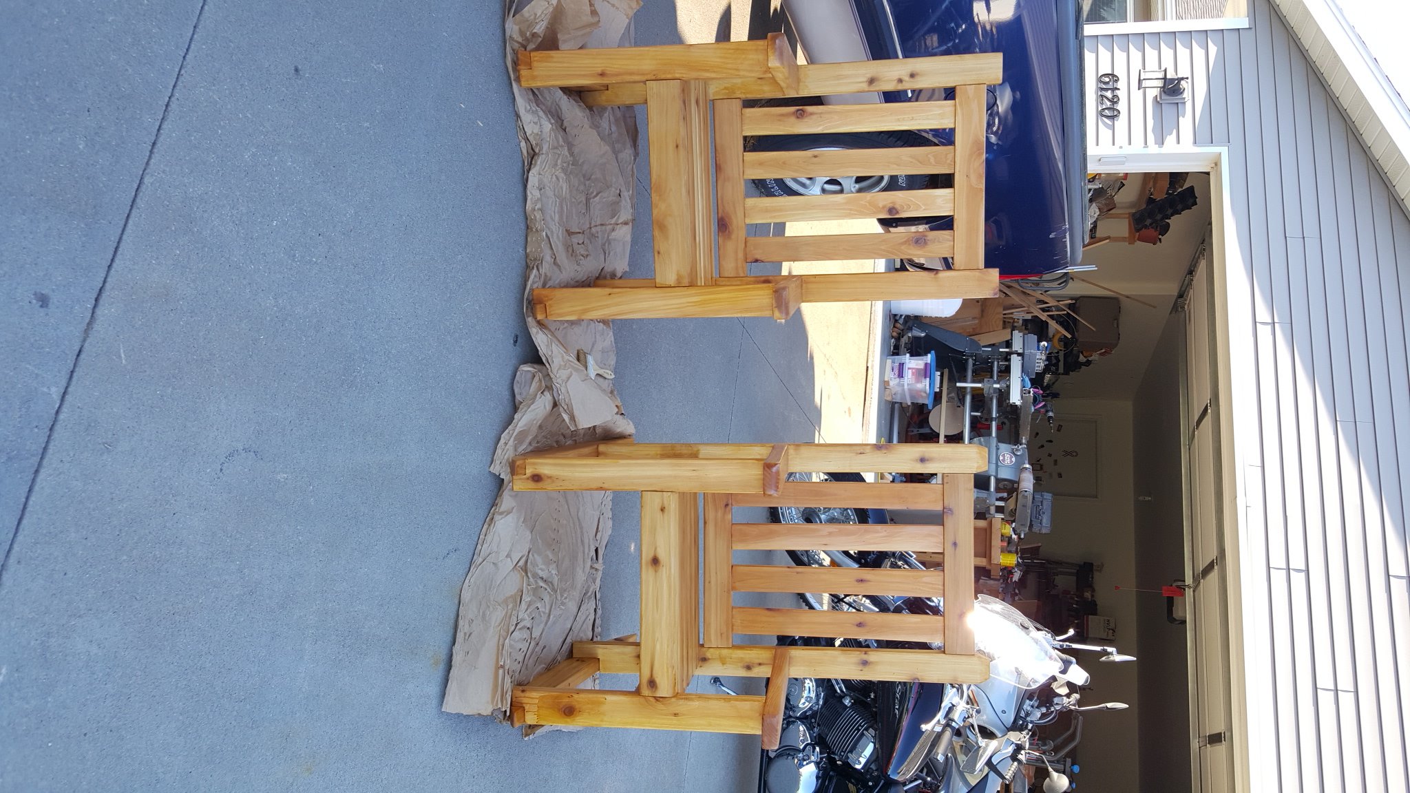

I did not want to make something that they could not get into or out of easily as my dad (RIP) had a bad knee. I left it with them to use to ensure the dimensions worked for them. I then made two more chairs out of cedar for outdoor use.
cedar rockers
cedar rockers

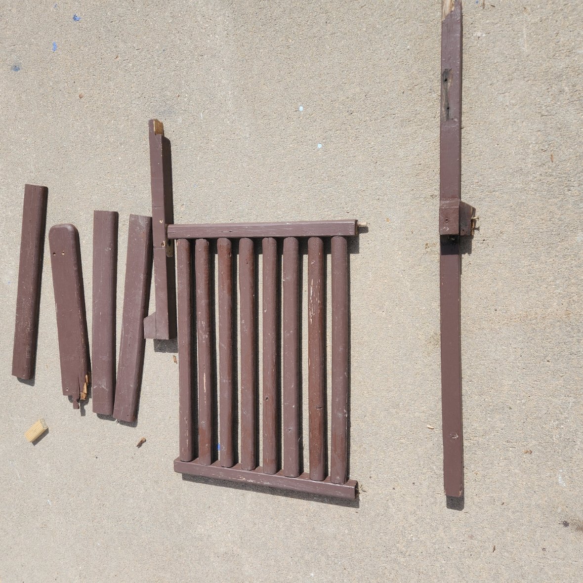

When these were presented, I was told they were too good to go outside so instead they found spots inside for them and the prototype, now painted, was used outdoors. I think the prototype got more use. This summer the prototype finally succumbed to rot. I was instructed to fix it but the more I looked at it the more rot I found.
Prototype pieces
Prototype pieces
So instead I decided to use it as a pattern to make an other rocker. I am using pressure treated construction lumber this time in the same dimensions as the prototype.

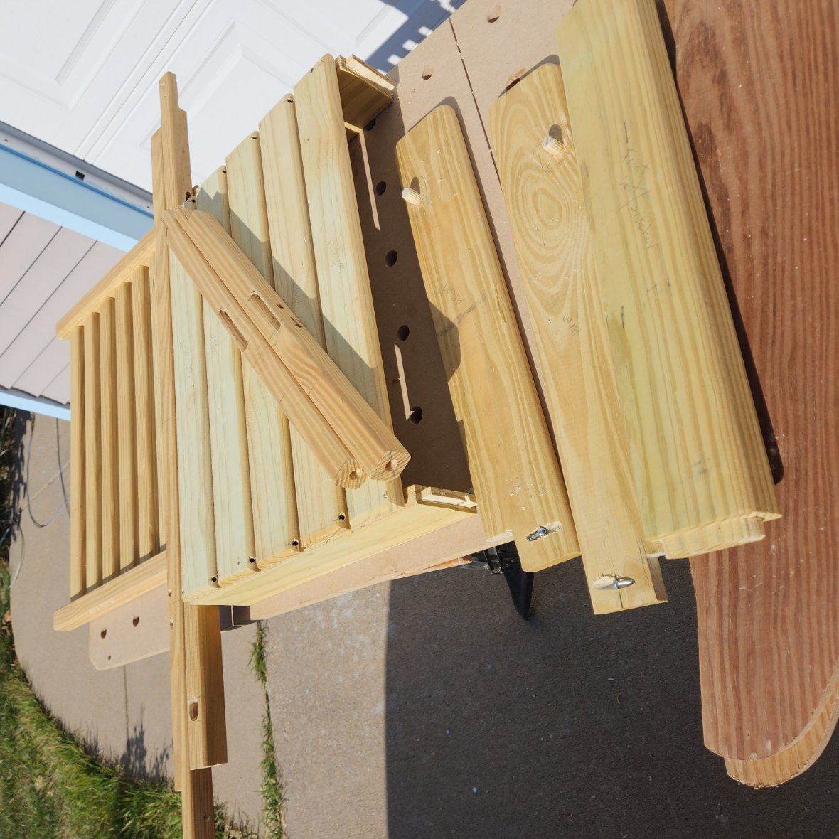

I finally got the rockers done. I made 2 of them to replace the one rotting one. I used mortise and tenon joints with screws. I figure the screws to hold it together while the glue dries and in case the glue fails in the future while outside. I made a couple of dowels to attach the arms to the front legs and used pocket holes for the back of the arms. I put a block under the arms that is glued and screwed to each upright to help support the arms. I am hoping these will last longer than the original prototype did.
parts to be assembled
I drilled through the mortises for the screws.

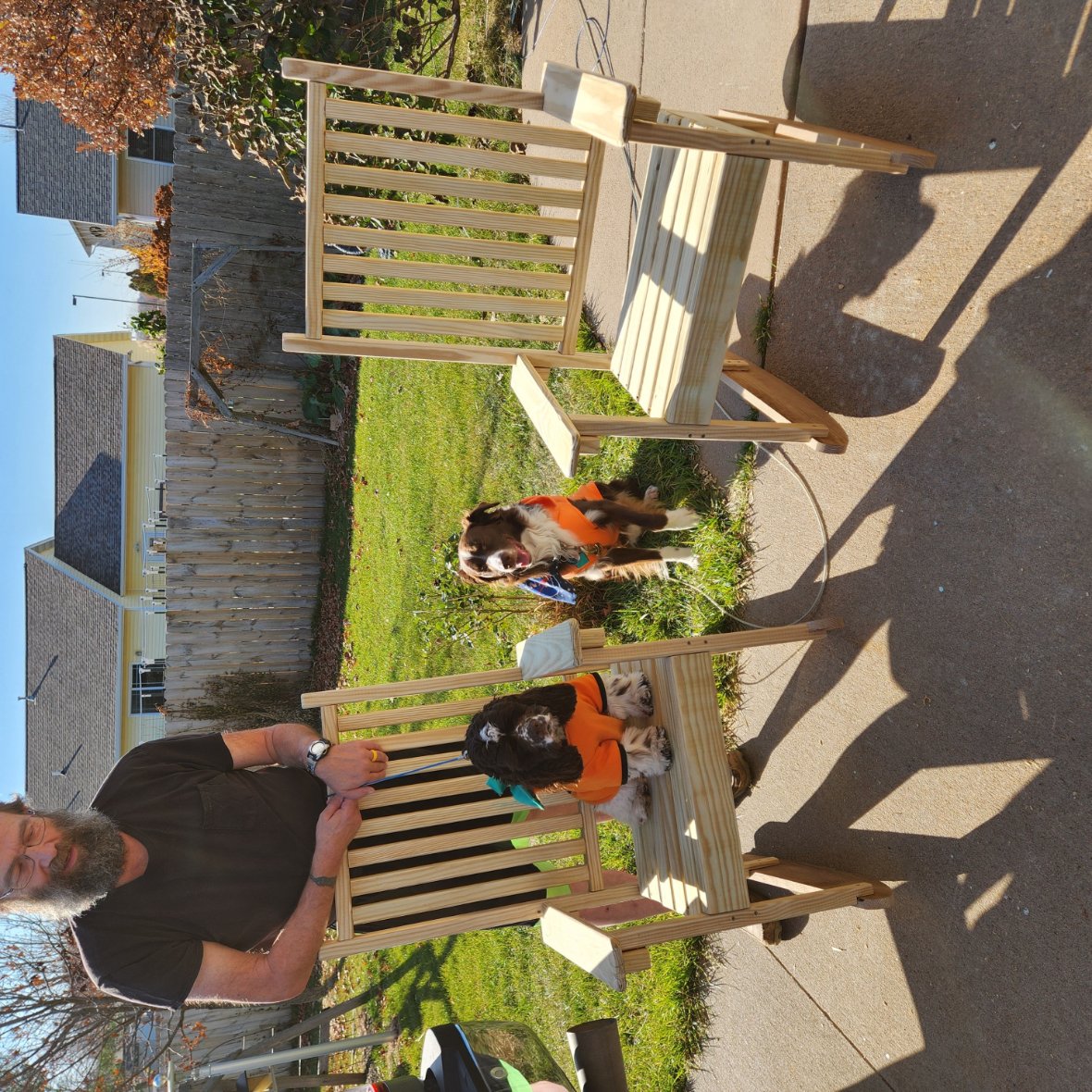

Both assembled before being taken to my mother's. My husband decided to join the dogs while I was taking the picture.
finished
finished
