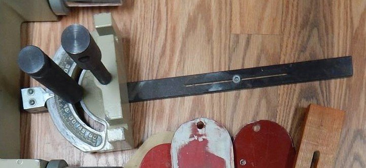

I did find a picture of the Miter which is from the ad of a SuperShop that was for sale near me. The bar has the same locking feature and I wonder is the bar size the same since Al says his fits the Shopsmith Table Slot.

Thanks for the input! There are a couple of the newer style OEM units on eBay right now. I'm still debating on whether or not I really need one though. What I have may be a bit heavy and cumbersome, but it actually does the job quite well.

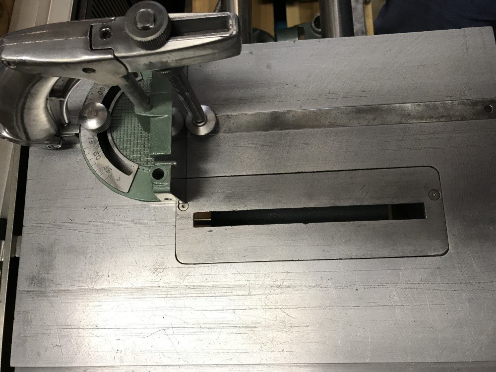

I do like having the safety grip on the miters which is more ergonomically designed and more comfortable to use than a straight post.
Any time I need to use a Miter on a Model 10E or 10ER I would use the Special Miter which is a Mark 5 type on a Model 10 bar. That way I have a better grip than using the Model 10 Miters. One of mine is shown below.
