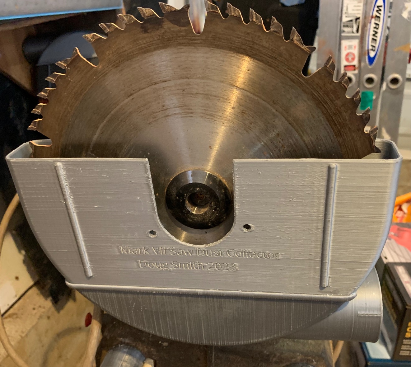

ImageI
wanted to share the experience I have with the 3D printed saw guard/dust chute that FB SOG member Doug Smith made for me. I am the owner of an old 1963 Magna Mark VII. Back then the saw guard was ‘optional’…so I never had one. I cobbled one together out of plywood to catch some of the dust, but it was just to get me by. Mark VII owners can’t use the 510-520 guard because the dust chute hooks to the right (this one hooks left toward the headstock). I have been testing out various prototypes for Doug and I think he nailed it. I have tested it with the 10” saw blade (1-1/4” and 5/8” arbors) at shallow and full depth cuts. At full depth it nearly seals to the insert—there is no dust escape. I have cut bevels up to 20 degrees, the original SS guard only supported 15 degrees). I actually was able to statically tilt the table to 30 degrees….but didnt try it for a sample cut yet. I have tried it with a 6” (non-SS brand), 13/16” wide dado (using the spaces Doug provided), the 10” Aluminum sanding disk (end of table, left slot, middle slot). I have tested it with a shopsmith dust hose as well as a shopvac hose (SS has a ‘lip’ on the end that needs to clear the table height posts). It should support the molding head too as that is smaller/narrower than the dado I was using. Recommend to any Mark VII owners who don’t have a lower guard. May also work with Mark V 500…but I dont have a way to test it. I used to know all the differences between V 500 and VII…but foggy memory now.
