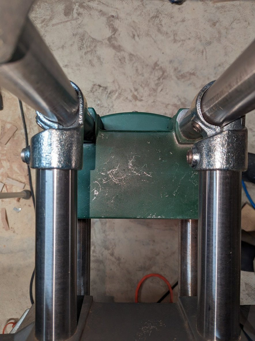

For a while I wanted to try out horizontal way tubes for the table carriage on my drill press so these brackets made it easy to try out. I didn't get any of the large Ts yet, but I think these are working well enough. The set screws are 5/8"-11, they seem to hold but I may put shaft collars below the brackets for more support. The second one I bought took more time to grind out than the first one, there's no real quality control with these cheap brackets, but the shape opposite the screws conforms to the tubes well.

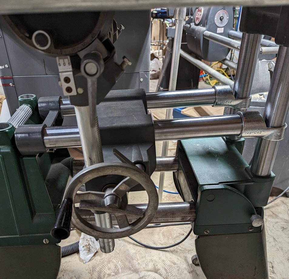

First pic below. The table is rock solid mounted this way. I put the carriage on with the controls on the right side. The crank can be on either side I think but the locking mechanism can't be reversed. I may leave the carriage like this and reverse the table top. I have to try out the different configurations of the carriage, table top, and table legs. Note that I left a 500 carriage on the uprights for use with the hydraulic headstock lifter. I had a 34" length of 1-7/8" inch way tube left from the original configuration so I cut that in half for the new bench tubes. I think with the table top turned around the right way I'll have enough travel along the way tubes. More changes to come but I had to put the drill press back together for now.
Front view showing the new way tubes mounted in a tie bar locked on the left side casting.

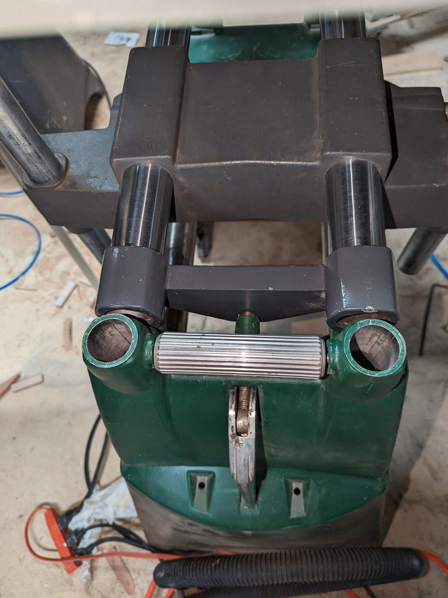

Rear view showing the brackets
