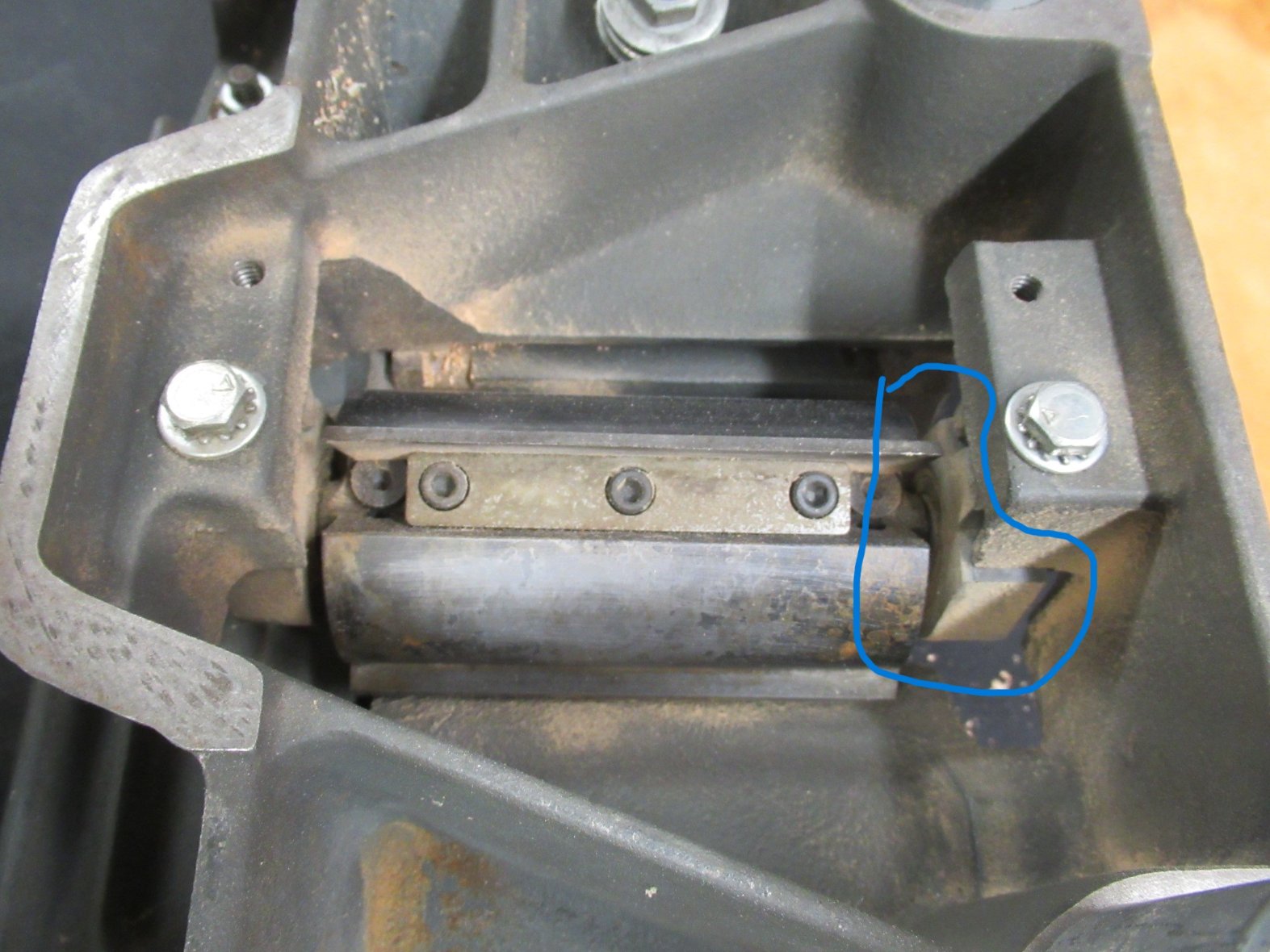

Thank you for replies. I attached a picture. Serial # SS16622 I'm assuming the bearing block is what I'm talking about. It moves front to back prior to tighten. I can move it about 3/8 of inch prior to tighten and position where ever I want. I'm ordering manual, I should have done that sooner.

By its Serial Number your Jointer was made in May of 1980. I am not sure what is says in the current manual about the 3/8" gap between the Mounting position on the Base/Outfeed Table casting and the Bearing Housings but the 1987 Manual and newest one I have doesn't address that issue. I would suggest you center the Bearing Housings evenly and adjust if needed after setting and aligning the Knives. My June of 1979 Jointer looks like it has about the same space as yours. It is centered in the space and has about an 1/8" clearance for the blade rotation to the Base/Outfeed Table casting.

My jointer manual does not show the detail on the head mounting blocks either. I do wish the gap under the mounting bolts were not there. Looks like a problem waiting to happen. When I first tried to turn the head by hand, it was hitting on the outfeed table. I then disassembled to clean it up. I don't think the PO ever used it. After rust removal and waxing, that is when I noticed the gaps. Upon reassembly, the head is spinning freely. Should I be concerned about the gaps on the mounting brackets?

If your Jointer looks like the picture posted by rcsaylor I would not be too concerned about it. Just make sure the bolts are tight. I have not had any problem with my 1979 Jointer which almost looks the same underneath as the picture when the Dust Chute is removed. Older Jointers, like mine, do not have the Dust Chute mounting holes threaded.
Apparently when you received your Jointer it was pushed back causing the knives to hit the Base/Outfeed Table or the knives were improperly adjusted (too high) or some of both. When setting it up for use a quick check of the shaft can tell you if there is a problem. If you can "wiggle" the shaft at all the bolts need to be tightened before use.
