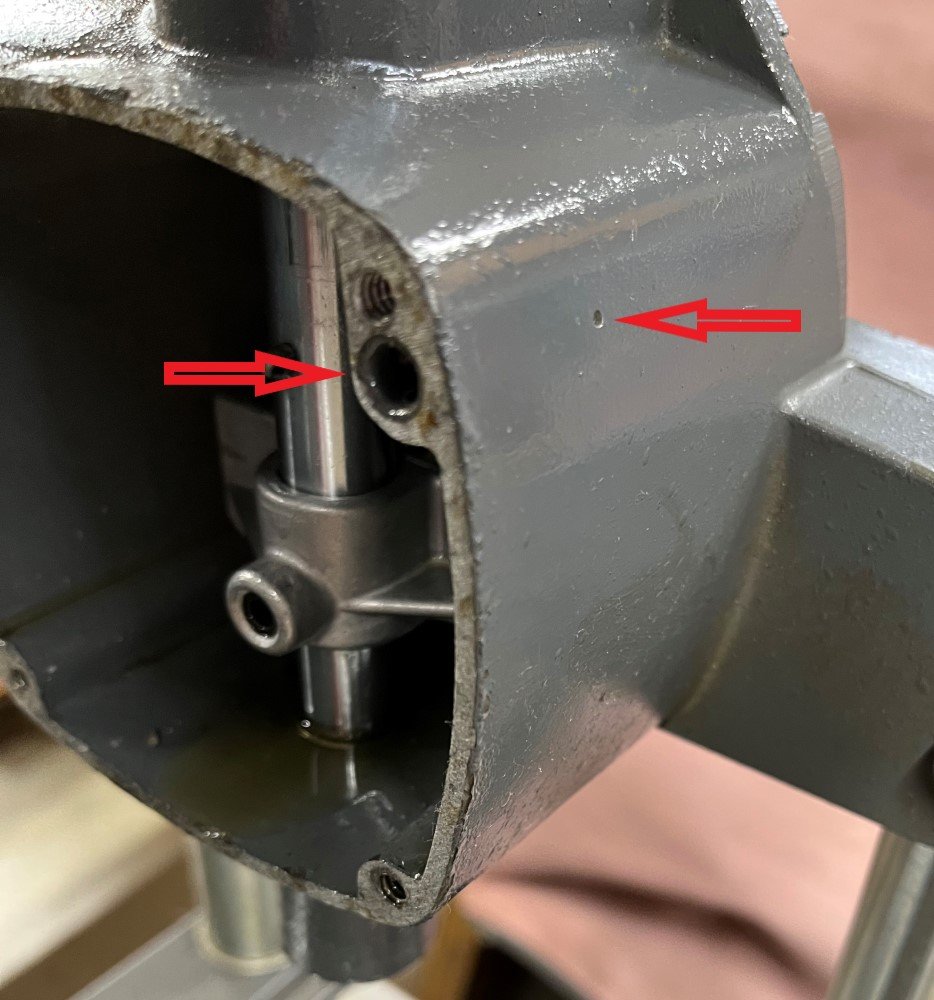

It may be helpful to note that the original question from bobwilley was about the Nylined Bearing P/N 502265 which is for the Lower Chuck Shaft. In the video chiroindixon referenced and Ron posted above it is about the Oil Seal P/N 502264 for the Drive Shaft.
Something to remember for all Magna/Shopsmith Jig Saw users is to keep the Vent Holes in the main Housing open. Those Vent Holes are indicated by the arrows in the picture below.
_ .
In the picture above the Nylined Bearing P/N 502265 for the Lower Chuck Shaft is under the puddle of oil. Sorry it is not easily seen but I drained the oil and took the cover off for the Vent hole picture. I wasn't worried about a little oil in the bottom of the Housing.
_ .
