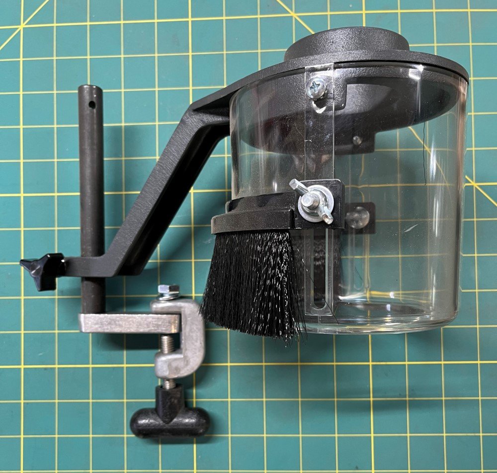

I purchased a 515704 Router Table Guard from a seller on eBay. SS catalog link below.
https://www.shopsmith.com/ownersite/cat ... sories.htm (Item A)
It arrived with the mount of the broom part damaged. (the part with the bristles) I tried to get the SS customer service lady to tell me if they sell parts for it. She wasn't sure but could not find a parts diagram for it.
Another item missing with the same item is the part referred to as the "base clamp" in this link https://www.shopsmith.com/ownersite/manuals/845650.pdf (page B-7, Figure D-59).
She did not know if this part was available. It is not offered for sale separately, nor does it show to be part of the guard package.
I know I can fabricate a mount, and possibly find another seller to purchase the broom part, but it sure would be nice if the SS folks understood what I was lookin for. Don't get me wrong, I am thankful to have what we have. I guess the ultimate solution is to expand the demand for this great product by defending the quality every chance we can.

Jerry,
As Dusty said don't waste your time defending the Shopsmith Tools on other sites. Shopsmith's are either loved for what they can do or hated. You can talk yourself "blue-in-the-face" but you are not likely to change their minds. Enough said about that.
As for the parts you are looking for, having instructions for any Shopsmith items that include the parts diagram and list are invaluable for finding the parts needed. The Router Table Guard you reference P/N 515704 is different than the one in the manual you reference. I have the Router Table Guard P/N 515990 from the Speed Increaser which has the clamp you refer to for attaching it directly to the table. It is those additional parts of the Clamp that is the difference between the two guards.
The Brush Assembly P/N 514564 does not show available in a search for Shopsmith parts. The Brush Assembly is held on the clear Shield by carriage bolts, washers and wing nuts. If that is the part you need, asking for it by the part number from customer service may help. As a last resort the Shaper/Router Shield P/N 555373 uses the same Brush assembly part and currently sells for $29.87 and would give you that shield type which clamps onto the Quill to use also.
The clamp is several parts listed as follows. (the Clamp Extension, Clamp and Knob are available)
515891 Clamp Extension
515893 Clamp
515981 Knob
120382 Lock Washer (common hardware)
180120 Cap Screw (common hardware)
The size of the Lock Washer is for the bolt and the Cap Screw (Hex Head Bolt) is 3/8" - 16 x 3/4" long. You should find these cheaper locally.
A picture of the 515990 Guard and Support Assembly is shown below.
